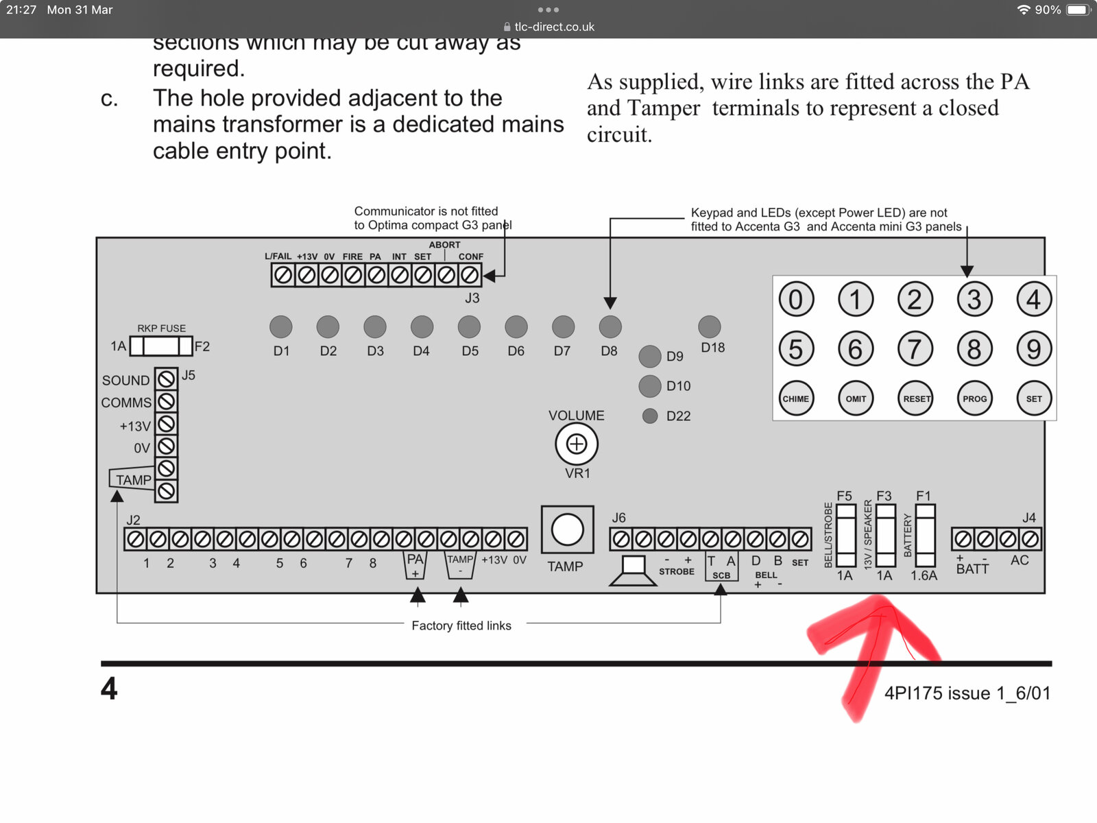

Would the keypad still operate? I had a fast blow fuse blow on my alarm some years ago and nothing would operate.
Separate fuse ….do your pirs / detectors light up when you pass them ? If not fuse blown
As below
No that don't, that sounds like it, I'll try that tomorrow thanks sparkymarka
Thanks sparkymarka, the fuse had indeed blown, all working and confirmed with walk test.
