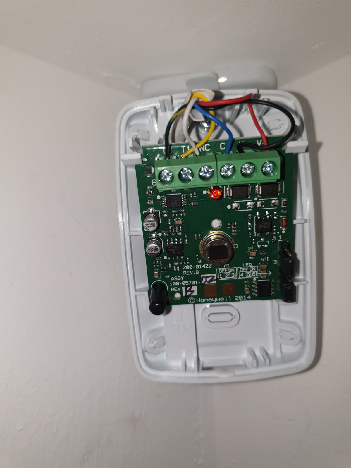

I've wired up 1 door contact 2 pirs
I've used blue and white as alarm on contacts and pirs
Yellow and green as tamper circuit and red black as + and negative as photo

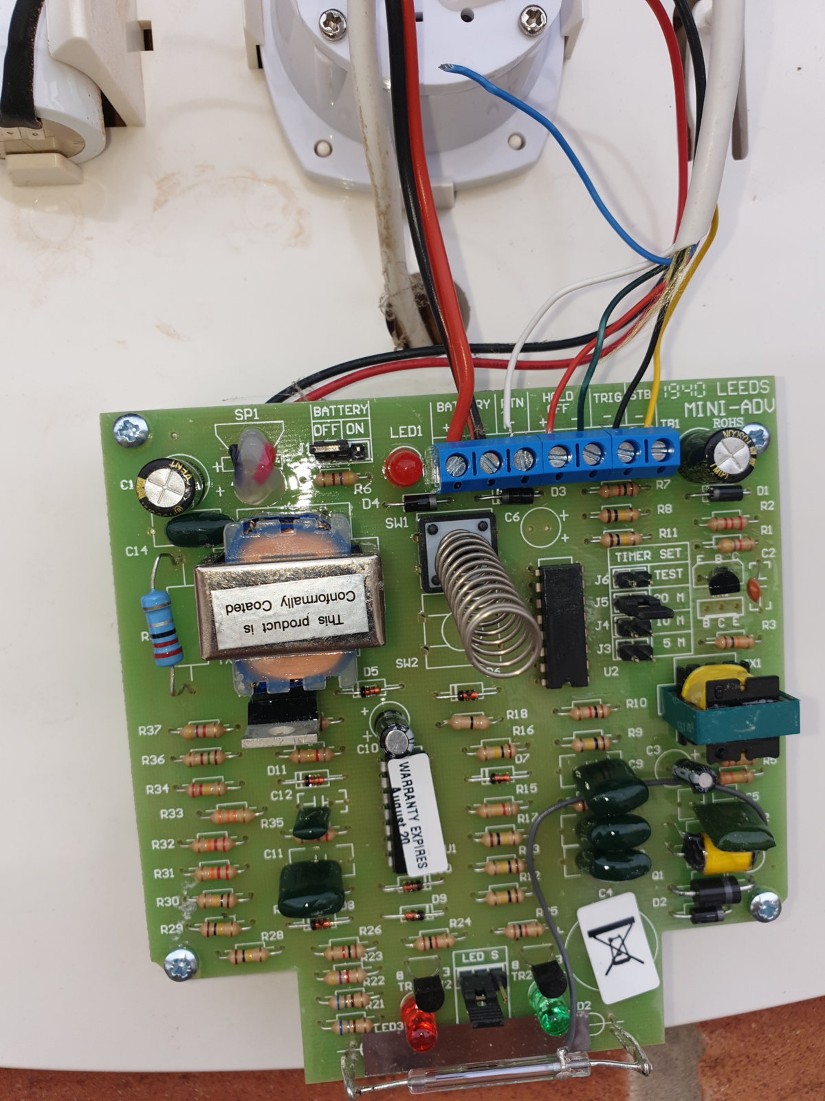

The siren box has been wired up from the manufacturers diagram

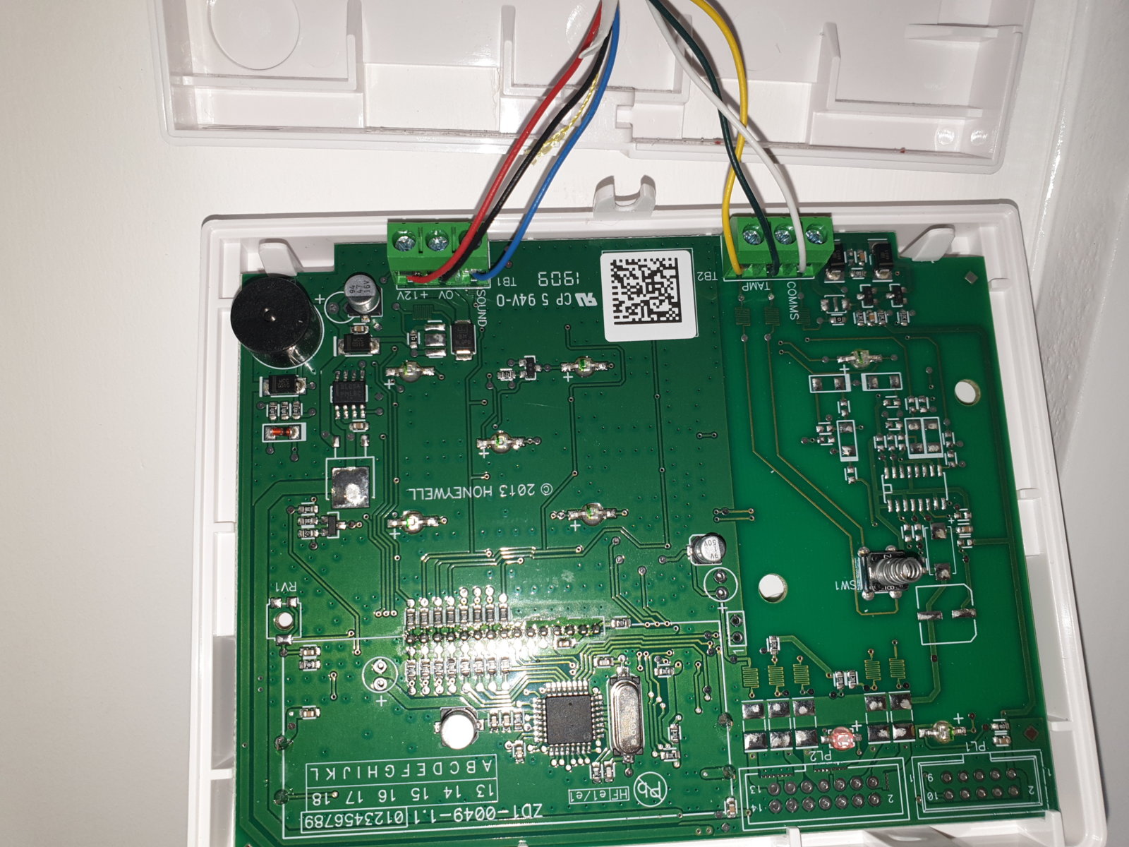

LCD panel works

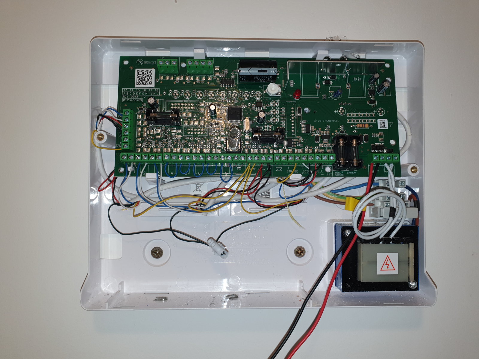

When I power up the alarm goes off I have to input code to silence bell box then reset press 9999 then I get message tamper lockout
I've checked tamper springs mainboard, bell and lcd panel
What have I wired up wrong
Mainboard
LCD panel
Alarm box

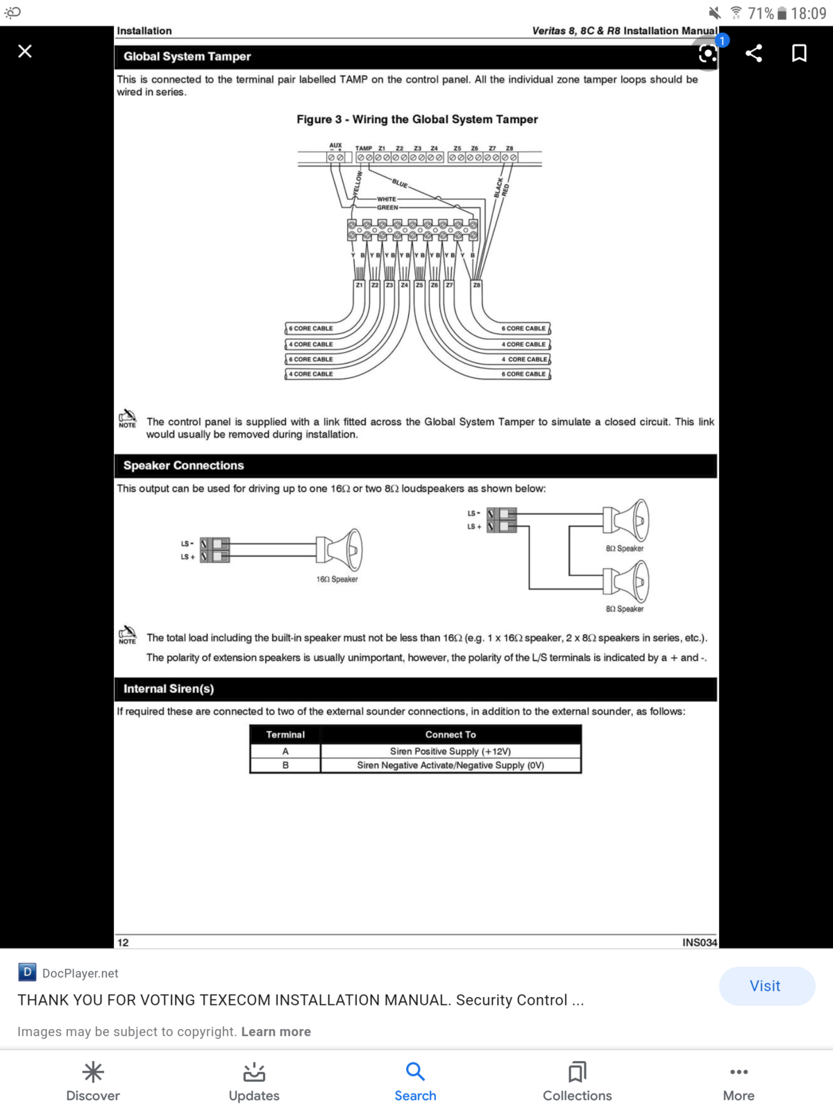

Why have you got 3 wires in tamper terminals?
Put wire link in tamper terminal to see if lock out disappear.
Hello
I will nip to his on Monday and remove tamper cables and put a link in the tamper
How do you put them in series
