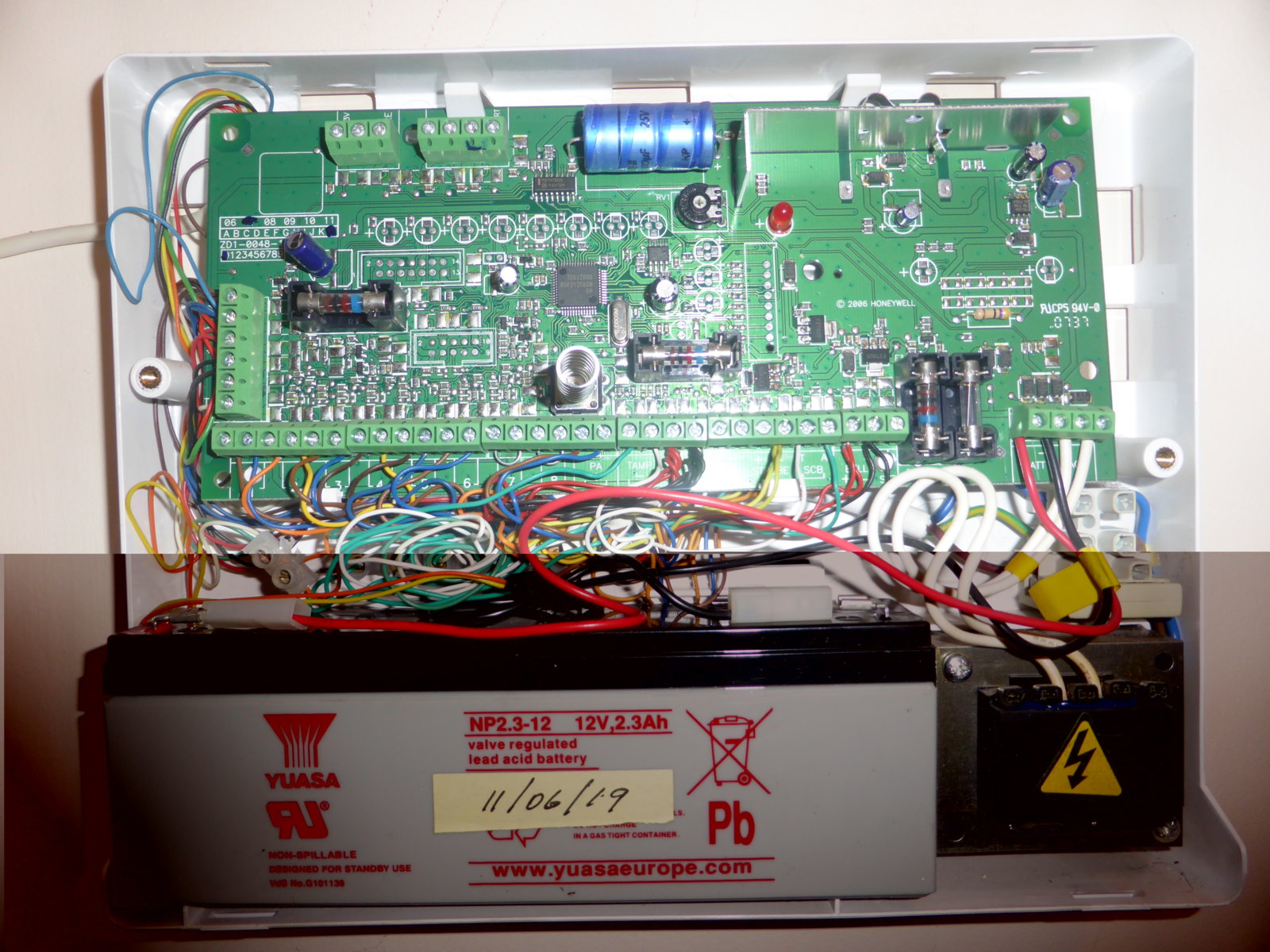

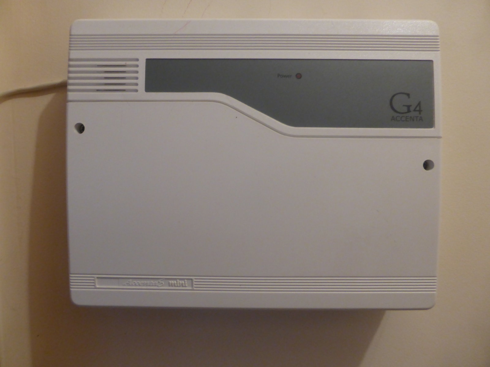

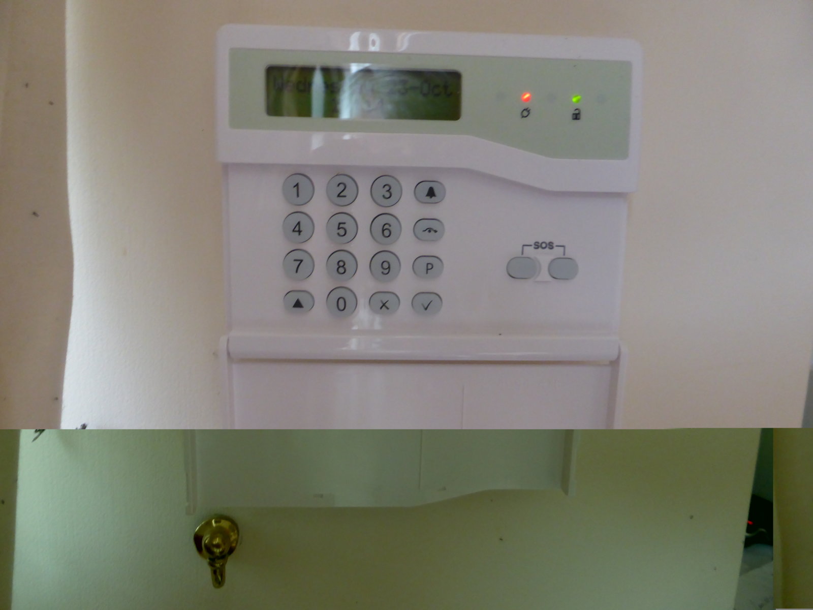

Thanks for your replies.
Attached are photos of the keypad and PCB.
Although I said the noise disturbs me, actually it's my wife, I'm a bit hard of hearing so I haven't heard the noise but my wife and guests have. I did sit up 'til midnight one night but I couldn't hear the sound and my wife did but was too slow to get out of bed to identify where, precisely, the sound was coming from. My wife says the beeping is similar to that when the alarm is set so I assume that's the source.
