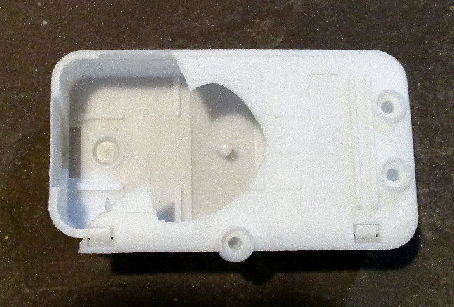

How about 'chockboxes', particularly the opaque white (rather than transulcent) ones, which appear to be particularly brittle? I've just done this, just with my fingers (no tools) to one of them ...
... do you really regard that as "reinforced insulation"?

I really don't understand that. I am merely asking whether, for example, the chockbox that I have just shattered with my fingers is or is not, per BS7671, adequate protection against electric shock if it contains live parts (which may not even have 'basic protection').
