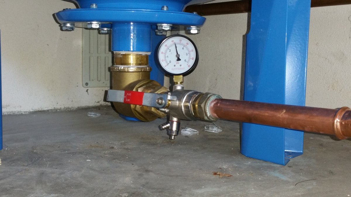

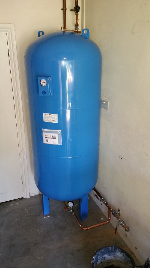

Fired this bad boy up last week:

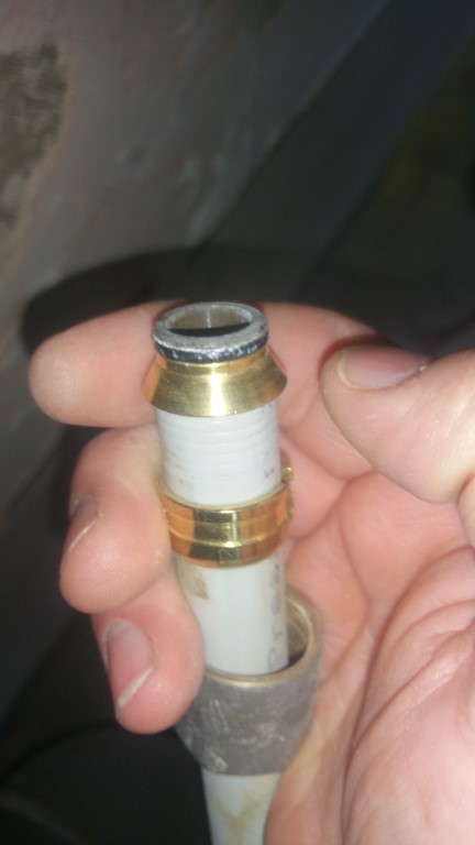

Pushing 3 bar through this pipe work from Italy:
With Hansgrohe brassware.
Customer reports an improvement over their 3 Bar Lowera and 450 break tank set up it replaced.
Nice little earner if not a little worrying when it didn't perform at the first attempt of setting the pre charge.
Left it at 2Bar and all was gravy:cool:
Perfect! We've used some Italian large vessels and one of them looked like a space rocket on legs. However, I stick with TWS now because the founder of the accumulator in the UK, Steve Elsey, looked after us in the early days and his estate get a licence for each one sold.
That's a 750 litre vessel stormer. Heavy barsteward even before being filled. Guess it weighsweighs you 600kgs now :eek:
