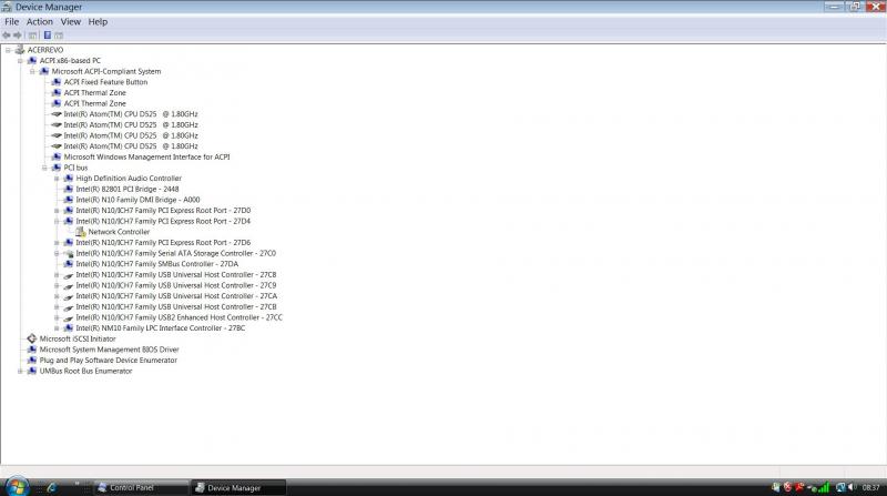

Hello group, I've recently purchased an ACER Revo 3700, it came with no operating system so I have installed Windows Vista premium. Everything is working except I can't install a compatible driver for the network controller, nor do I know the type it is. The Acer site has the drivers for Windows 7, but does not support any other O/S at this time. I will be running the unit via a network cable so this would really be useful. If anyone can shed any light on this I will be eternally grateful.

Tried all the drivers listed, to no avail. Tried uninstalling then re-installing but made no difference. what makes you guys think it is manufactured by realtek?
regards Otto
Please right click on the device, select propeties, go to the details tab, and select hardware IDs from the list. Paste the top string.
I've pasted the string, I've also included the 3 strings below in case they are of any use.
PCI\VEN_1814&DEV_3090&SUBSYS_662211AD&REV_00
PCI\VEN_1814&DEV_3090&CC_028000

It was Monkeh, I assumed (never assume ) that the "Realtek PCIe GBE Family Controller2" was the wireless device in the system device string, this had not explanation mark associated with it, have I had the 2 devices mixed up all the time then?
Regards Otto
GBE = Gigabit Ethernet. So yes, you've had it mixed up.
As I initially said, Realtek drivers are supplied with Vista.
I am sending this message via my wireless network adapter on my Revo, I have also tested the wired network and all is well. Thanks Monkeh, I could kiss yer..
