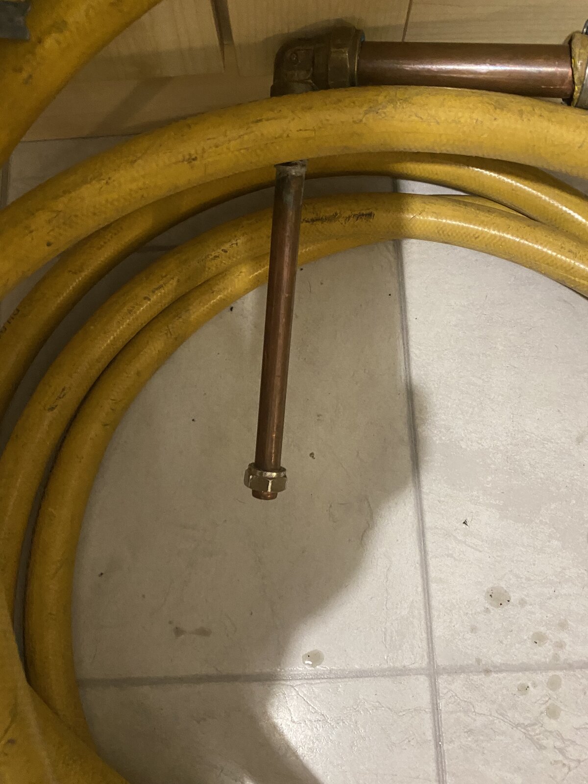

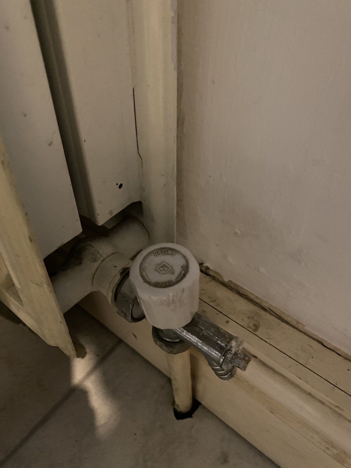

I need a compression fitting so I can plug in the hoses for the power flush machine I’ve hired. Just not sure what part I need.
The other side will connect onto the 15mm thermostat valve, but the drain off valve has a much bigger nut
Photos to help

If you are flushing through a thermostat valve -Im not sure thats good practice as it will restrict flow.
maybe Im not understanding what you are doing.
I though I read removing the pump and connection there was best.
Im sure the pros on here will advise
I've been told by the hire place to connect to the rad valves on one rad. So doing it on the kitchen rad by the back door and will have the machine outside. Not bothered about the thermo valve at this point as i can replace it if it gets knackered.

1. The best place to connect for a power flush is at the pump connectors. You get the best flow through the pipework.
2. You can do it through the pipes, but you need to:
2.1 Drain the system or find another way of removing the valves of the selected radiator from the pipework. Bunging is OK if yo know what you are doing and can cope with an emergency. Freezing using an electric freezer is more straightforward but more expensive.
2.2 Disconnect the valves from the pipework.
2.3 Connect the hoses from the flush machine to the pipework.
2.4 What you need to connect the hoses to the pipework depends on the hose connections. Look for a compression male iron (they are made of brass). One end 15 mm compression (looks like your pipes are 15 mm) the other end threaded to suit your hose ends. Probably 1/2" BSP, could be 3/4" BSP. If pipes 15 mm, Screwfix 69358 for 1/2", Screwfix 82086 for 3/4"
2.5 May just be an open ended hose, in which case a jubilee clip onto the pipe. If the pipe needs to be a bigger diameter, say 22 mm, use a compression coupler and a stub of the larger pipe. E.g. if your pipe is 15 mm and the hose will only go over a 22mm, use a Screwfix 68500.
3. Doing it this way means the selected radiator doesn't get flushed. Either flush it on its own afterwards or do it manually in the garden.
4. If you have a sealed system, it pretty straightforward.
5. If you have a feed and expansion tank, you need to stop off the vent and the cold feed point, and you MUST remember to unblock the vent afterwards. Its a good opportunity to clean out the F&E - don't flush its contents though the system.
6. Look up the Kamco web site and read their instructions for using their flushing machines. Lots of invaluable advice.

Don't put the flow through a TRV, they often have tiny waterways. No you can't just connect a speedfit connector straight to the pipes which go to the rads because the olives will be fixed on the pipes as in your first pic, hence OB's point 2.4.

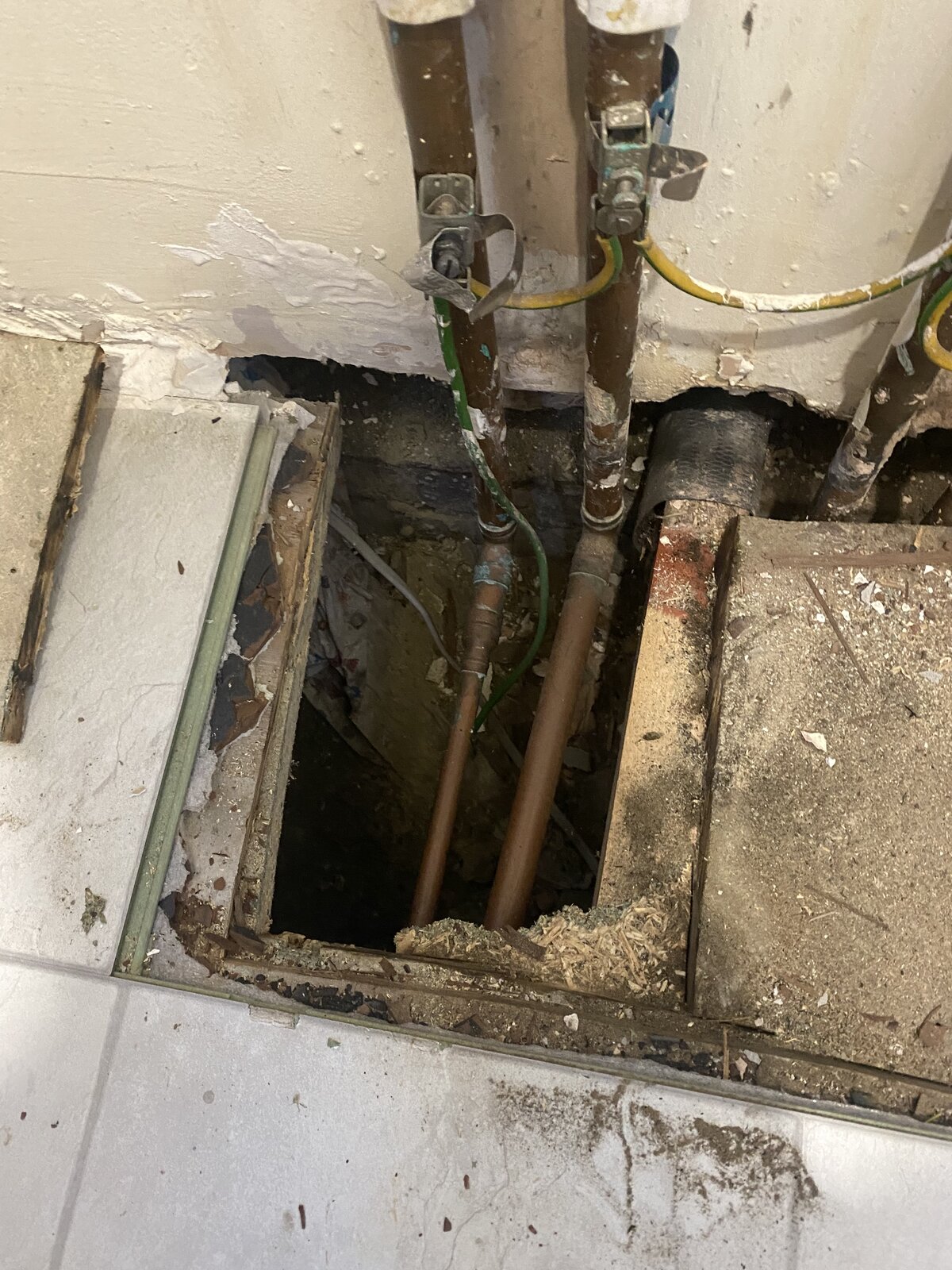

My engineer has tried a new pump the other day but that wasn’t the issue. He’s pretty sure it’s a pipe issue but doesn’t think all this work will budge the blockage.
If it doesn’t work then I have to take up the kitchen floor and that will cost me a lot
The photo shows where I have taken it up in the pantry area under the boiler. You can see the return is only on a 15mm pipe. I cut it here but no blockage so it is elsewhere
