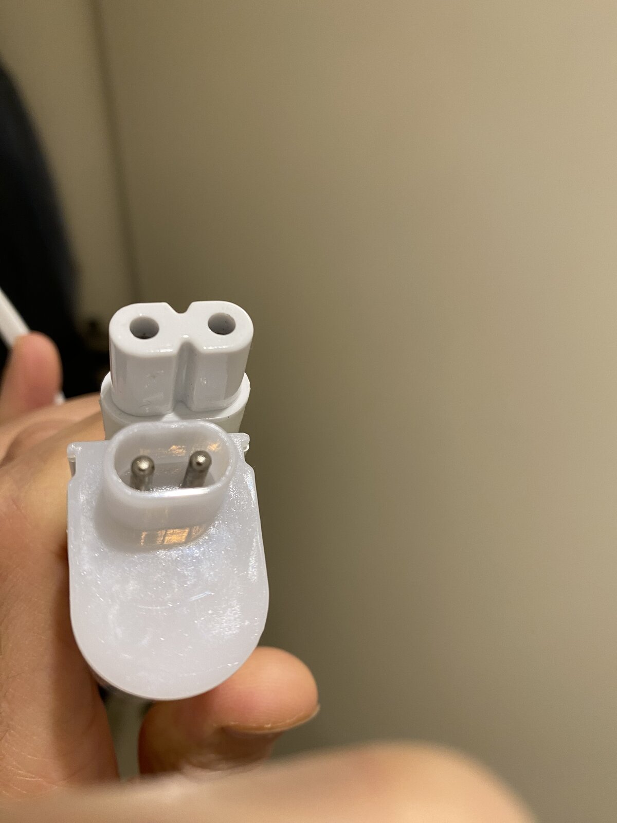

Hello
Can you anyone advice which adapter would I need in order to connect these together please (picture attached) ?
Thank you in advance
The Photo (in Post #1) appears to show
an IEC C7 Female connector
and
an IEC C2 Male connector.
See https://en.wikipedia.org/wiki/IEC_60320
You would need an adaptor with
an IEC C8 Male connector.
and
an IEC C1 Female connector.
If you cannot find one, you could make up a lead using
and
You may need to ensure that he polarity of any connections are correct.
Good luck !
Thanks. But switching the wire might be better long term. I could be wrong but looks like the old I have is being phased out anyway ?
To me, the plug you have attached to your house isn't obsolete. (you may find it on internet routers, sky boxes etc).
It's the light that looks odd!
