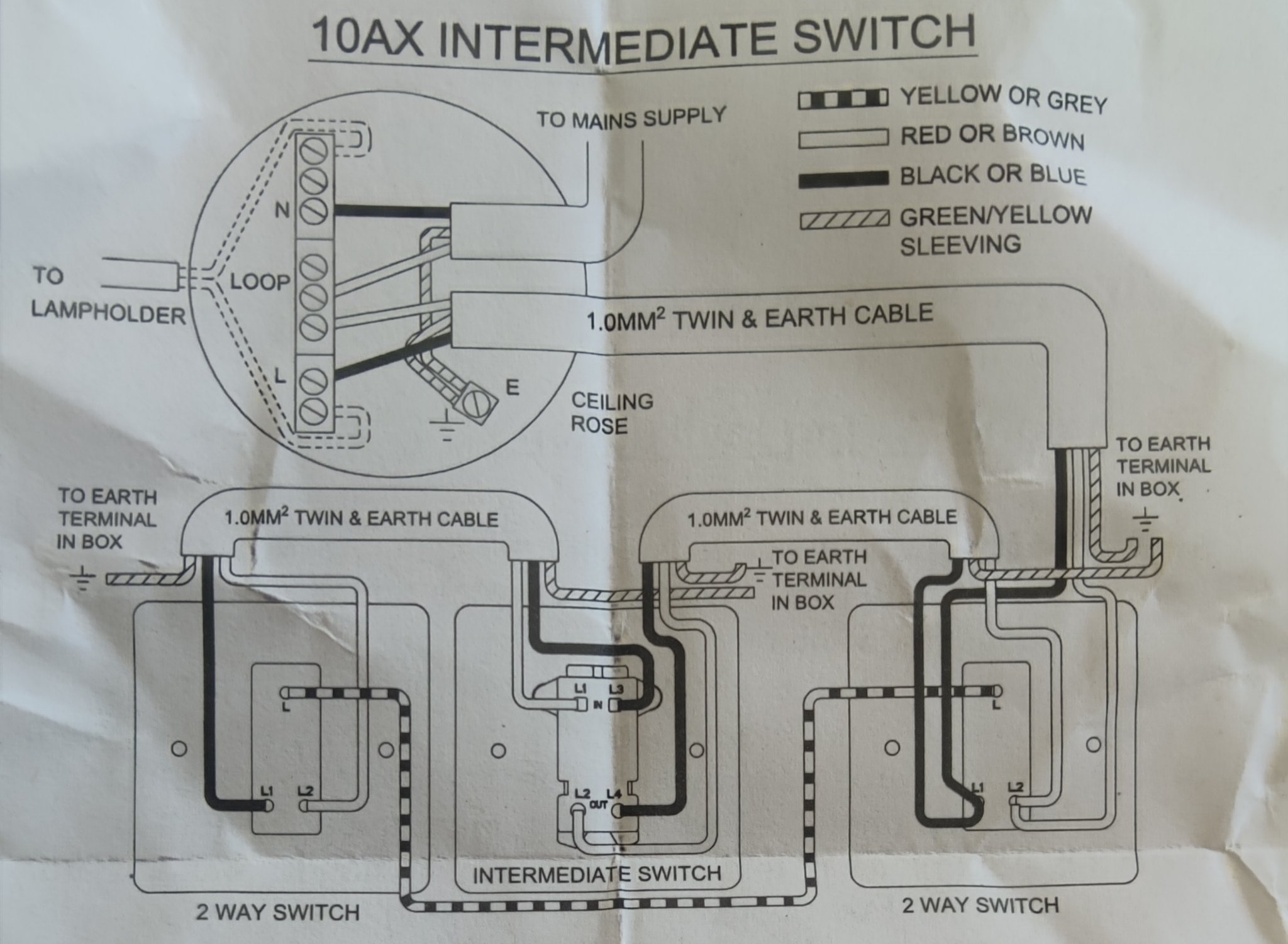

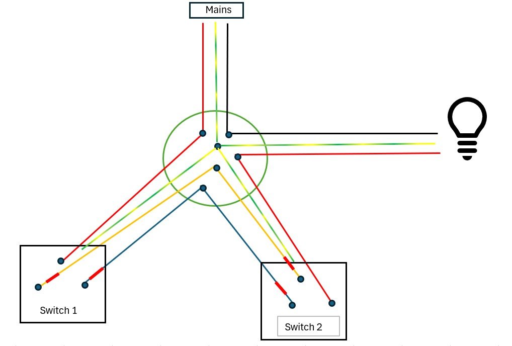

Hi, I am planning to add a third (intermediate) switch to control the light. Could you please advise on how this can be ?
Please see the current wiring diagram below.
Many thanks in advance.

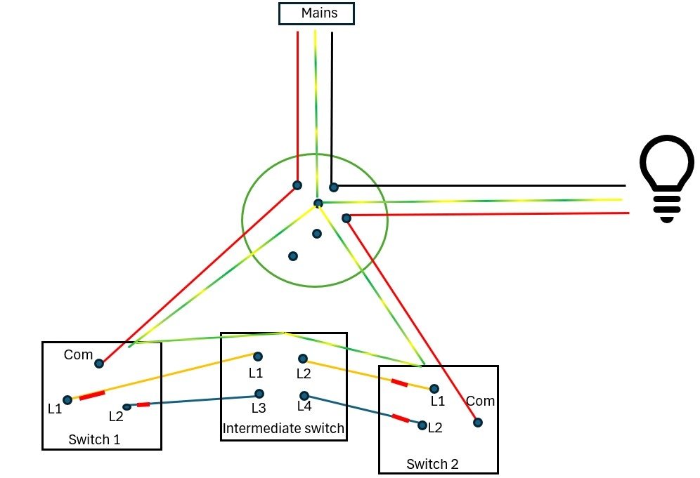

It needs to intercept the wires shown as yellow and blue in your diagram.
Many thanks. Would sth like that be ok?

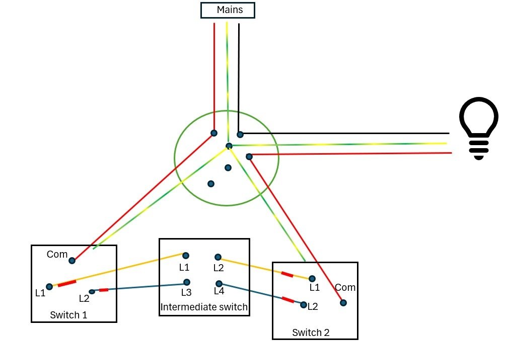

Yes - though you need to check the labelling of the terminals on the intermediate switch.
(Earth to new switch too, obviously.)
Many thanks, I will give it a go and let you know. Sorry, forgot about earth.
