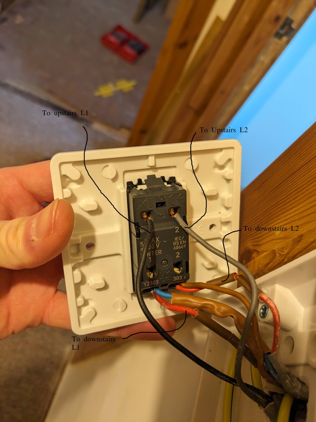

The wiring diagrams I can find all show the live/switched live from the light fitting entering the switching circuit at one of the 2-way switches, e.g. here and here.
In my case, I've added a 3rd switch to control one of my lights, but due to the location of the light and the switches, it is such that the live/switched live from the light fitting enter into the backbox of the intermediate switch.
Can anyone please advise on how to wire up the switches in this situation?
There are switched that only need three wires, and seen one only needing two wires, but these are electronic switches, not mechanical.
And with electronics you don't need any wires. I did fit a smart switch to dinning room when temporary used as bedroom, and used a magnetic backed button on bed to turn lights on/off, however found voice control better so used the push button elsewhere.
So to clarify, I can use the L1 and L2 in the intermediate switch?
L1s OR L2s in this diagram:
So at long last, the intermediate switch arrived in the post, and I have spent a long time this afternoon unsuccessfully trying to wire it up.

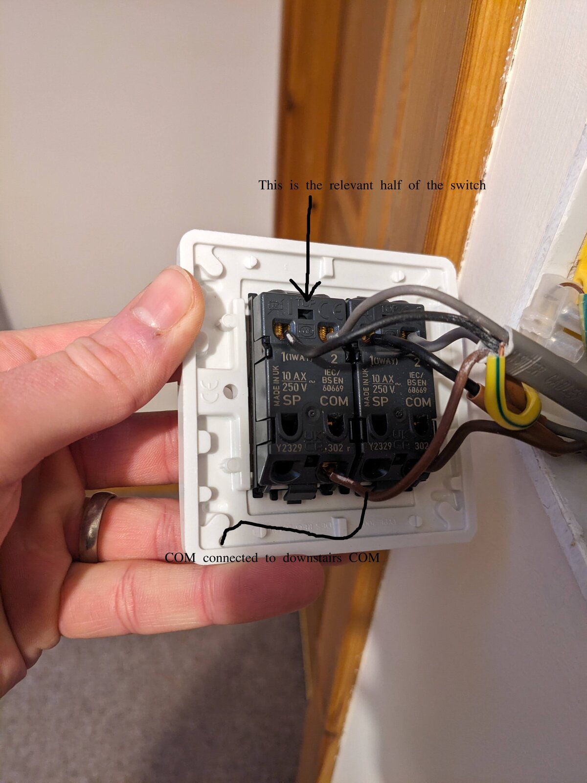

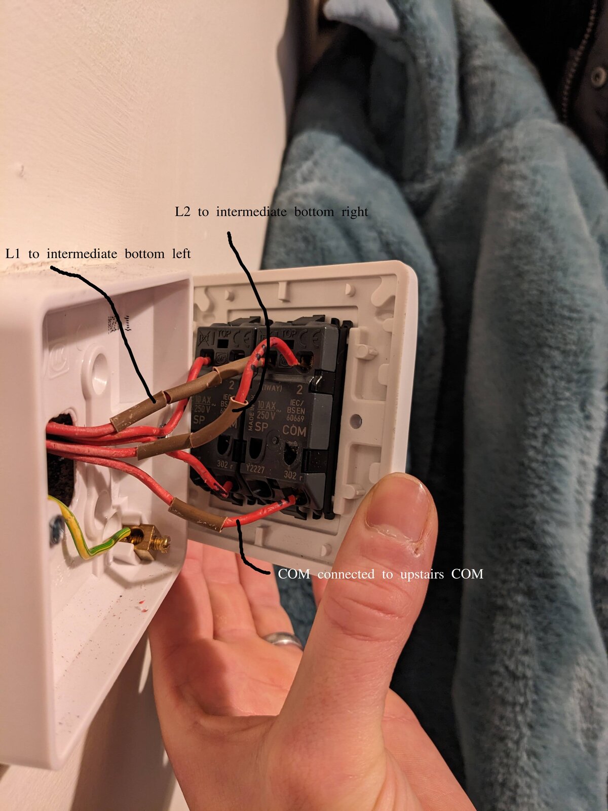

I attach 3 pictures of the 3 switches in question. There's a downstairs 2-way switch at the bottom of the stairs, an intermediate switch at the top of the stairs (this used to be a 2-way switch and is where the 2 core and earth cable from the light fitting appears) and there is a new 2-way switch upstairs at the other end of the landing.
In the depicted configuration, when both of the 2-way switches are in the off correction: "on" position, the lights are on and the intermediate switch does nothing (the lights don't even flicker off when you carefully place the switch half-way between on and off).
I note that the MK intermediate switch I am using has the L1s and L2s in a different configuration. When the switch is in the "off" position, the terminals are connected vertically and when in the "on" position, they connect diagonally opposite top-to-bottom.
What more can I do to troubleshoot?

Where are the cores linked at the intermediate that do not connect to the switch ?
I should add, I did spend some continuity testing all of the red cores in the 3-core cable between the intermediate switch and the downstairs switch. I placed either 1, 2 or 3 brown sleeves at the end of each core so that I can tell which is which. I will repeat my continuity tests, however, to double check I've got it right.
