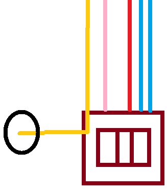

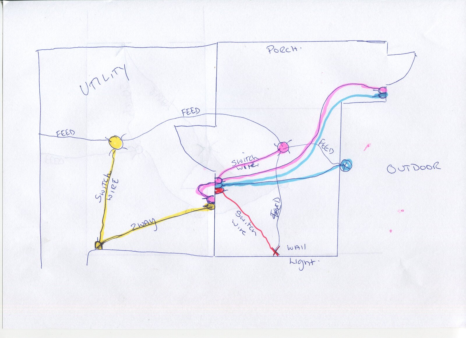

I have a what seems a simple lighting scenario but are struggling to determine if i am able to switch it as I wish, haven't a diagram so hopefully can explain it .
I have uploaded a sketch of the switching configuration and want to know if its possible?? in the porch I need to introduce an intermediate switch for the "pink" light. the switch in this position needs to be a 3 gang and wish the switches in the porch to be metal clad surface mount.
I have no access to change anything in the utility as all walls and ceilings are finished
I suppose my main questions
are
1. is a 3 gang metal clad intermediate switch available?
2. If so can the switch wire from the light be terminated at the intermediate switch.
3.assuming a 3 gang intermediate switch plate is intermediate x3 can this be used for 2 way and single switching (as blue and as red on sketch) ??
Hope this makes sense to anyone reading and thanks in anticipation of any advice ,clarification offered.
Russell

Do you know where the pink switch wire runs? presumably to the outside door or utility room.
Are the utility and inner (new 3G) switches back to back? If so it may be easier to make the utility intermediate.
What wiring can you easily run?
Some pics of all 3 existing switches wiring will help.

ok thanks for your replies I am getting that I will probably go for a grid/modular system.
regarding what is already existing.
Feed from utility light to porch (future light position)
3 core from utility (pink) to proposed 3gang intermediate (pink)
They are not really back to back as shown, it is just diagrammatic, The porch area is ready for first fix
Tyhanks
Russell

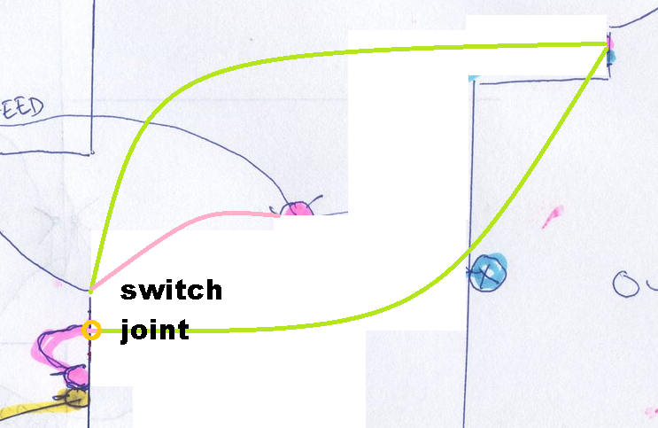

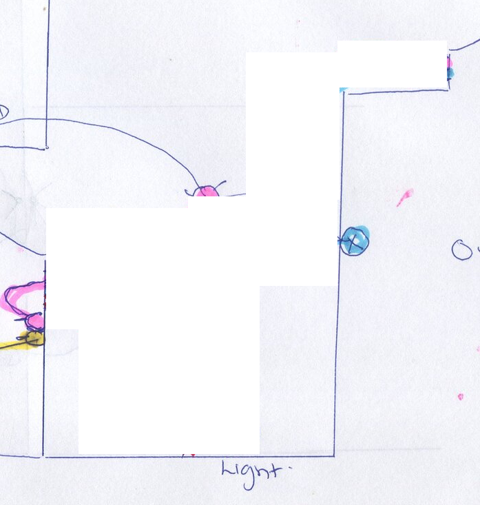

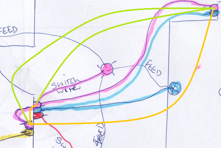

What I'm thinking is the cost of the triple with intermediate is much, much, more than a double with intermediate, you could save a lot if it's possible to run the cables as either the green or the orange in this:
So from your description I believe you currently have this:
In which case it could potentially be easy to do the green option by joining to that pink, possibly in the back of the 3g switch:
Or the other alternative if the 2 switches are the same height, drill through the wall and run the orange option like this:
I didn't show the 'pink' you've already run between the 2 switch positions.
It didn't occur to ask how that cable has been run, does it go up to ceiling level and back down? if so will it reach to the light?
Or even better, to the outer door switch??
