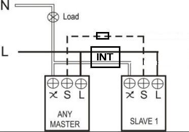

Well, depending on the cable routing, you can probably only remove the switch and connect the wires together, then fit a blank.
Thanks that’s kind of what I thought but now for the perhaps silly question... which wire connects to which?!
I can't find any diagrams for the two-wire system.
There must be a diagram in the instructions.
Presumably it is like this without the 'S'.
However, if you have the older system then the 'L' will be on the right hand side.
At the intermediate, just join together the wires of the same colour from both cables.

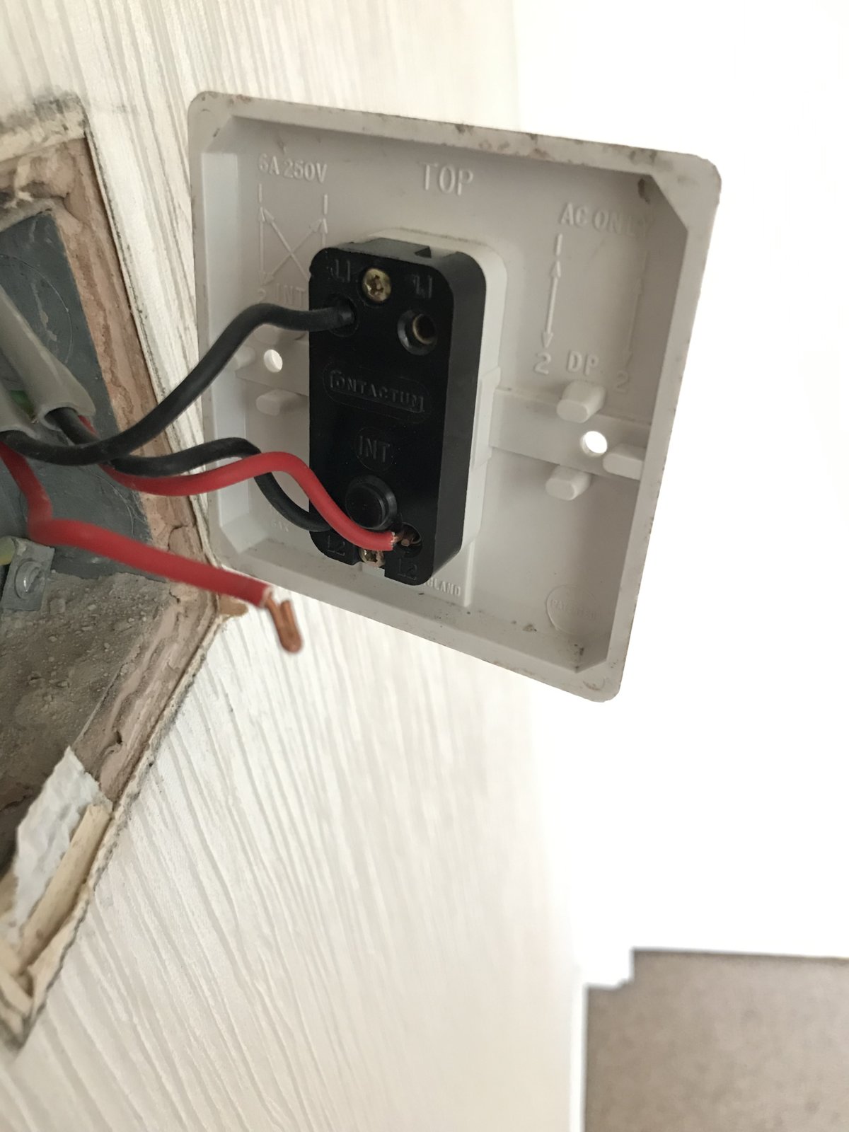

Hi all. Sorry to bring up an old post but just getting around to the job. I want to remove an intermediated switch from a 3 way switching circuit (the landing). Here is a picture of the switch. Which wires do I connect together? I have wago’s and will be fitting a blanking plate
I did a better job of it and traced the switch back to a junction box in the loft. It all made a lot more sense at that point!
