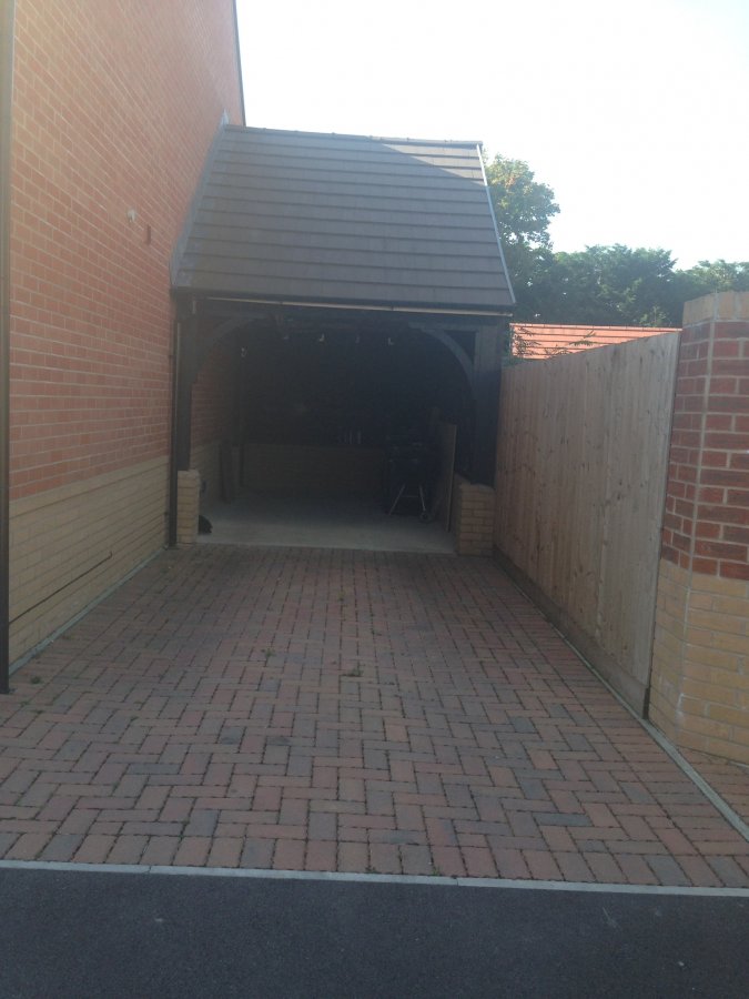

hi there,
Could you see a problem with putting on a garage door onto our car Port it will be a roller type.
Thanks in advance.
So putting a door on my garage do I require permission, the wood cladding won't make a difference on anything? There isn't any form of access from the inside of the house only a gate into the garden.
I wonder, when it was built, what it was? Maybe it has already been altered once or more.
You might be able to get a copy of the PP plan from your council's website.
you might be able to tell if the original PP said it was a garage or a carport. Unlikely but there might have been conditions on it.
