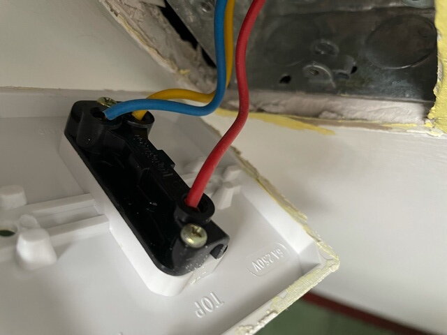

Adding a light to a two way switching circuit

How can you borrow a neutral when installing a new circuit?
Quite easily. I would expect the OP to want to swap the 2-way switch for a 2-gang and thus pick up a live from the existing 2-way circuit which will likely be on the upstairs circuit. Then OP would then be looking to find a neutral to take to the new ceiling rose downstairs - what would be easier for him than to pick one up from the nearest downstairs light? Alternatively, he might well decide to pick one up from the CU - just any neutral.
