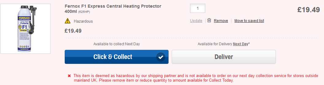

Have a look at Fernox F1 Express.......it's so easy to inject.
Turn both rad valves off, insert the F1 applicator, and as you pump it in, release the pressure by opening one of the valves slowly.

{edit} hmmm looks like I'd need 2 of those, as I have more than 9 rad panels in the house...

Well I tried. Hypodermic it is then.
