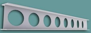

A couple of small holes for phone and data cables in the right place will have no significant effect on the strenght of the joist
Holes drilled midway between top and bottom of a joist have very little effect on the strength of the joist other than at the ends of the joist.
The top of the joist is in compression and the bottom is in tension as the wieght tries to bow the joist downwards.. Midway down the joist there is no horizontal stress. Provided there is enough material to keep the top and bottom layers apart small holes half way down have little effect.
At the ends of the joist it is necessary to prevent the layers delaminating and holes here can weaken the joist
With steel only a thin layer is needed at the top and bottom to take the stress.
With timber the top and bottom need to be much thicker due to the variations and imperfections in timber
