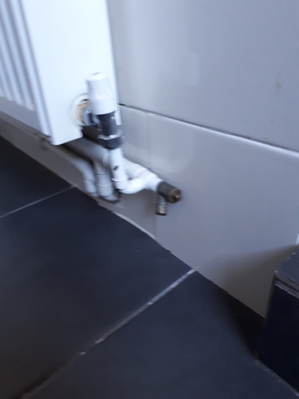

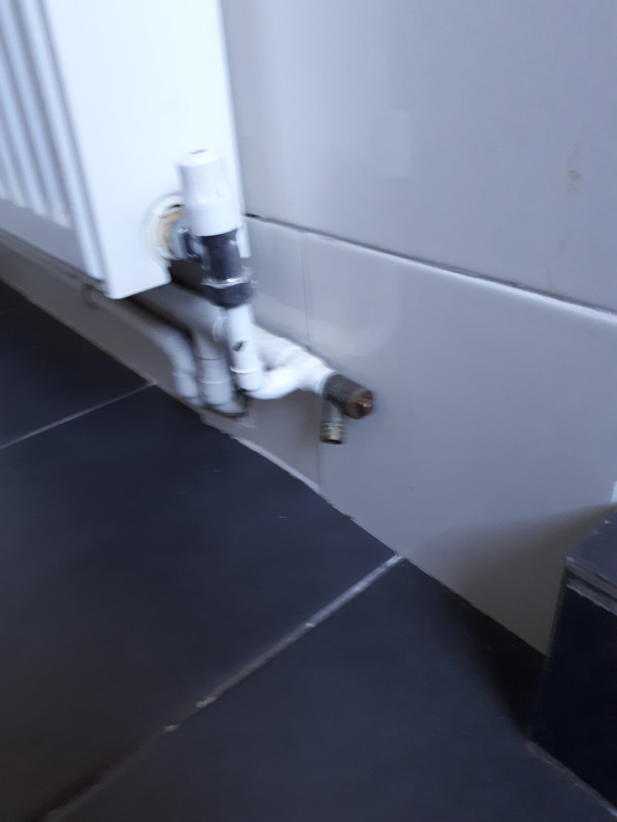

what system stop cock ? you need to leave a drain point open not a stop cock
I might be abusing the terminology:
Whilst pressurising the vessel, wait for system gauge to read 0bar.
How high should I let my compressor go to get the Boiler gauge to 0bar. I was going by 0.8bar as per some instructions on here but does it need more to throw the waetr out?
that is indeed the drain point and it is correct that you pressurize the air side of the vessel to 0.8 Bar, how much water did you get out of the drain point when you started your compressor on the expansion vessel ?

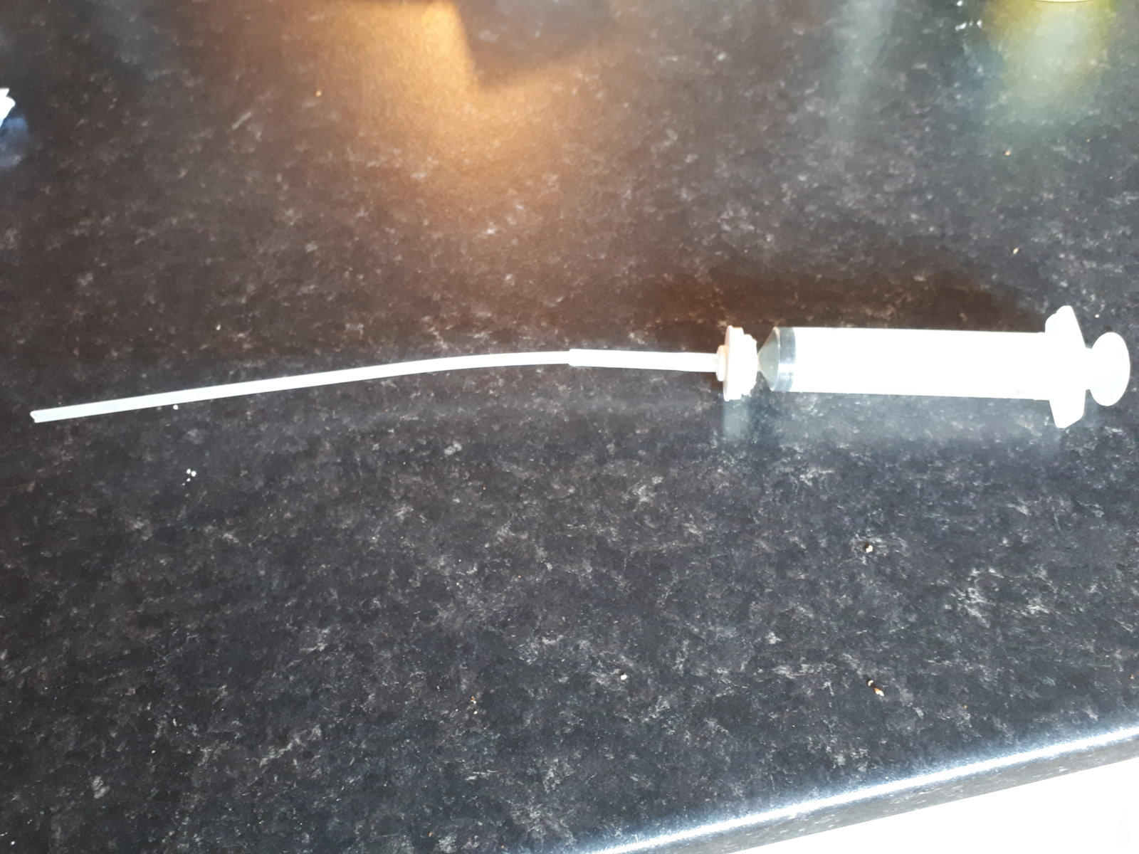

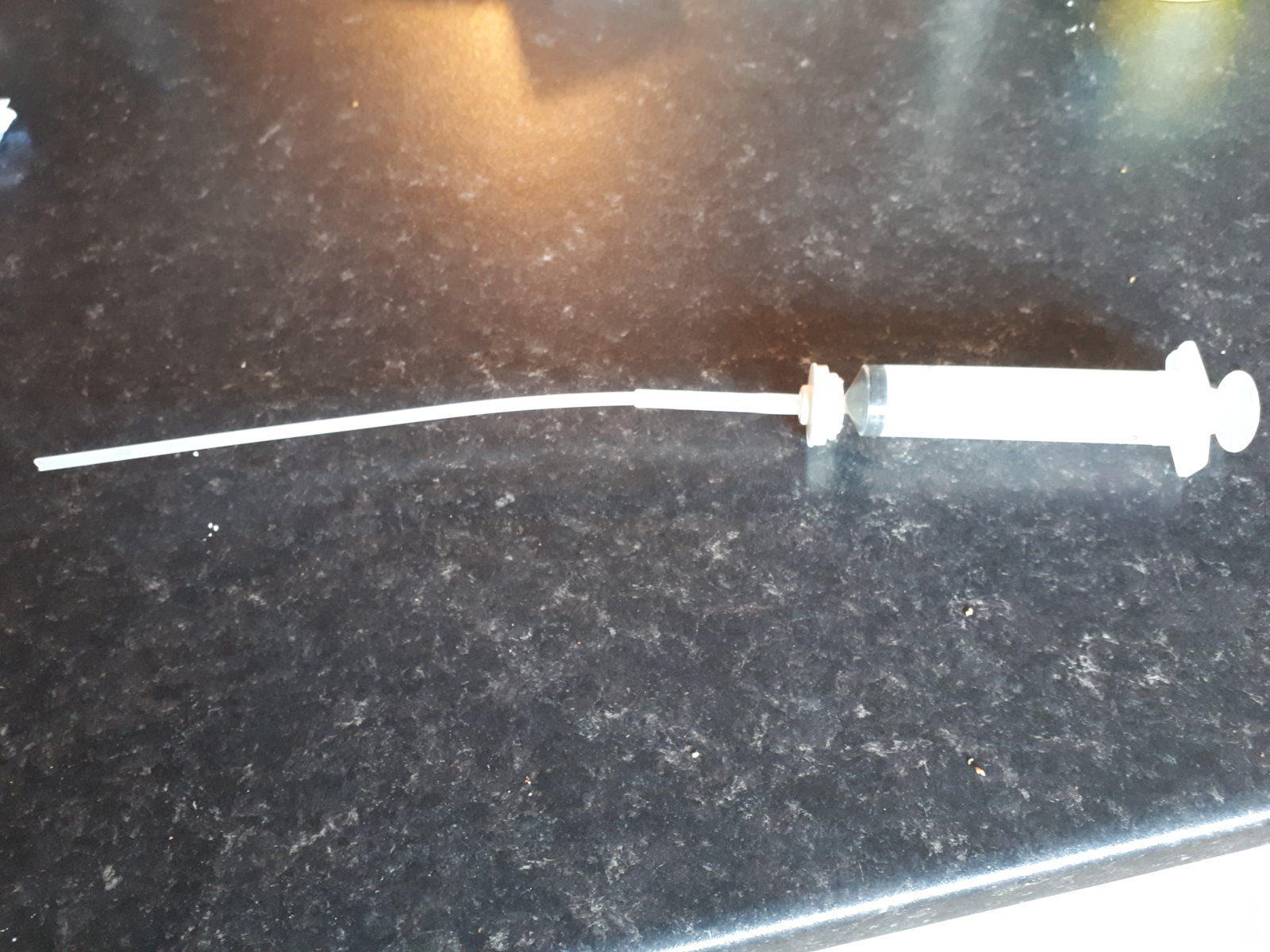

If you have a spray nozzle from a bottle of something (window cleaner etc) you can put the dip tube of this into the top of the towel warmer and use it to squirt system water out of the rail and into a container... If you use a measuring jug, you'll know when you've emptied enough to make room for the inhibitor (y)
That was a good idea and led me to make one of these, in the picture - it saved having to open the towel warmer at the bottom. It's only a 20ml ink cartridge syringe but I've ordered a 100ml one for next time.
