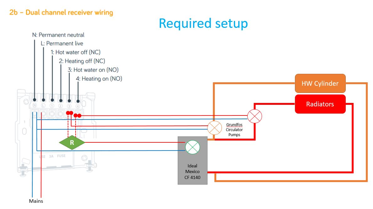

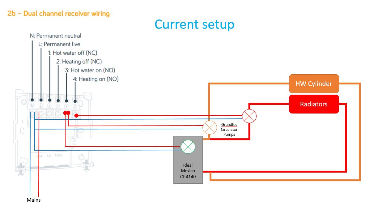

Just moved into and old house and trying to get the CH and HW bill under control.
The CH and HW run on two separately pumped zones but re-combine into one at the boiler for heating.
Current programmer has HW on as a constant default, with the option to have CH on in addition.
So the HW needs to be on to also then call for CH.
I am installing a Wiser smart therm with 2 zones.
The HW zone works fine as 'boiler live' and 'pump live' are connected (fires boiler and pumps HW to cylinder)
The CH zone doesn't (it cant fire boiler as not connected to 'boiler live' but does pump the CH circuit)
How can I insert some logic (relay?) to allow the smart thermostat to pass switched live to the boiler via EITHER the CH or HW live output from the smart control so I can run CH and HW separately.
Pic attached to help explain!

Yeah I fitted a 5 pin 240v relay to sort this issue.
And a hw stat for economy.
Normally water valves with end switches would do the job , but you may not want to fit them
You had better concentrate on the replies in the Plumbing Forum as they are questioning the set-up.
The way I connected relay was.
Contact common out to boiler.
NO to live feed
NC to HW stat (then hw timer)
Coil CH stat
Coil neutral
Very similar to your diagram!
It is unusual to have two pumps, and I suspect that the HW was originally gravity fed.
You need to investigate the piping to ensure their is adequate expansion/pressure relief, before altering the control system.

Indeed. Whilst, if a 'quick/easy fix' is what is required, then what is being proposed/discussed would work, it would seem far nicer to get rid of one of the pumps and install two motorised valves (or even just one 3-port valve). As I see it, that would offer several potential benefits:
1...Only one pump to go wrong (and, indeed, one would gain a spare).
2...Probably a little cheaper to run, since only one pump would be operating when both HW and CH were required
3...Maybe not an issue, but would eliminate any possibility of some hot water 'leaking' into the radiators (by convection), through the (non-operating) CH pump, when only HW heating was required.
