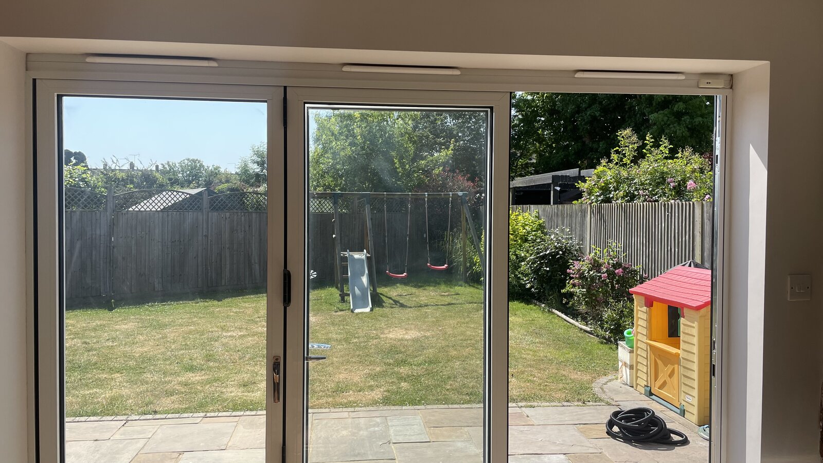

Here is a pic of the bifolds.
Top right there is already an impaq S but that’s sitting on the frame. Even though I’ve increased the sensitivity, it’s not picking up the shock when I bang on the glass.

Not surprised. you would need the shock sensor being ultra sensitive to pick up any vibration as its probably at the most rigid part of the structure.
if they were poorly fixed (seen some that wobbly significantly when you touch them) you would easily be able to trigger the device.
the vibration travels best along the weakiest part usually the middle ish of the bifolds.
