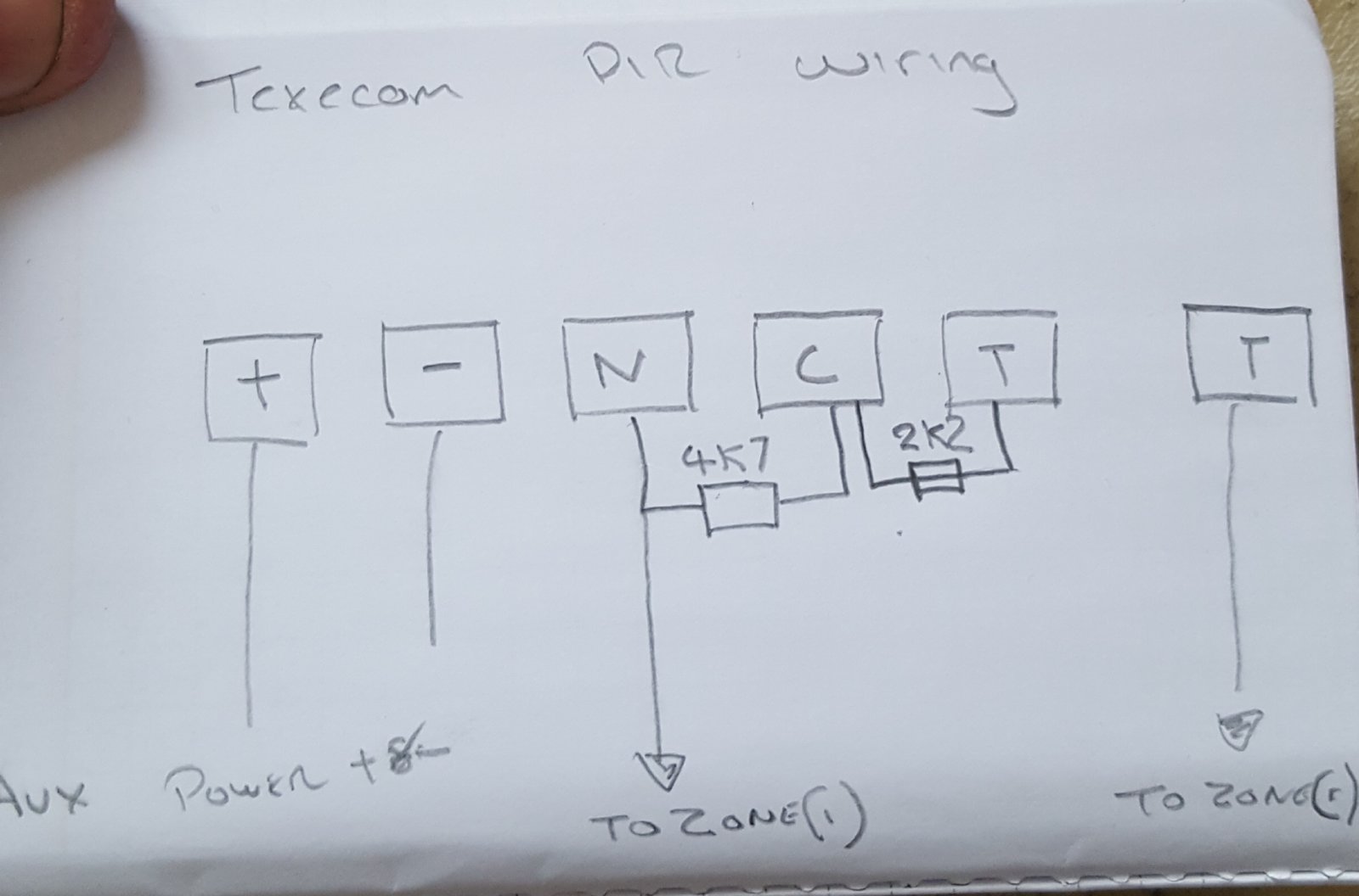

my question at this point is - if I'm wiring the pir's as eol (2 wire) do I have to use the resistors on the PIR's??
I normally fit small installations such as the veritas 8 with a global tamper. And I'm not sure how to do the eol.
Thanks for any assistance.
Yeah you need to fit the resistors unless the PIRs your using have them built in in which case select 4k7 2k2 if not wire as follows:
4k7 across the Alarm NC terminals
2k2 from NC terminal to Tamper.
Wire 1 into NC with the 4k7 leg.
Wire 2 into unused Tamper Terminal.
Meter readings should be:
2.2.. Closed circuit
6.9.. Open circuit (Alarm)
OL. Tamper
Hope this Helps.
Thank you for taking the time to reply.
Just so I know I have it right before i start can you check this please.
Awsome. Ill be on the job this afternoon. I hope i dont need any more assistence.
Once again thank you very much.
