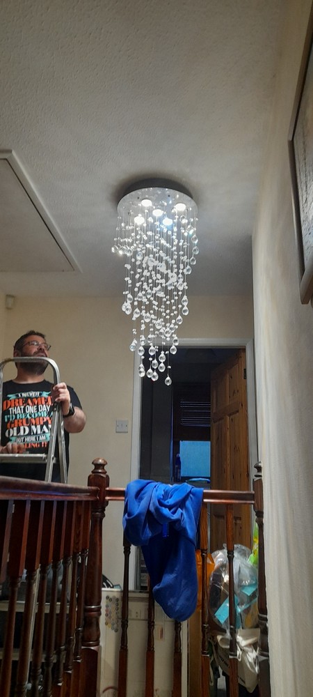

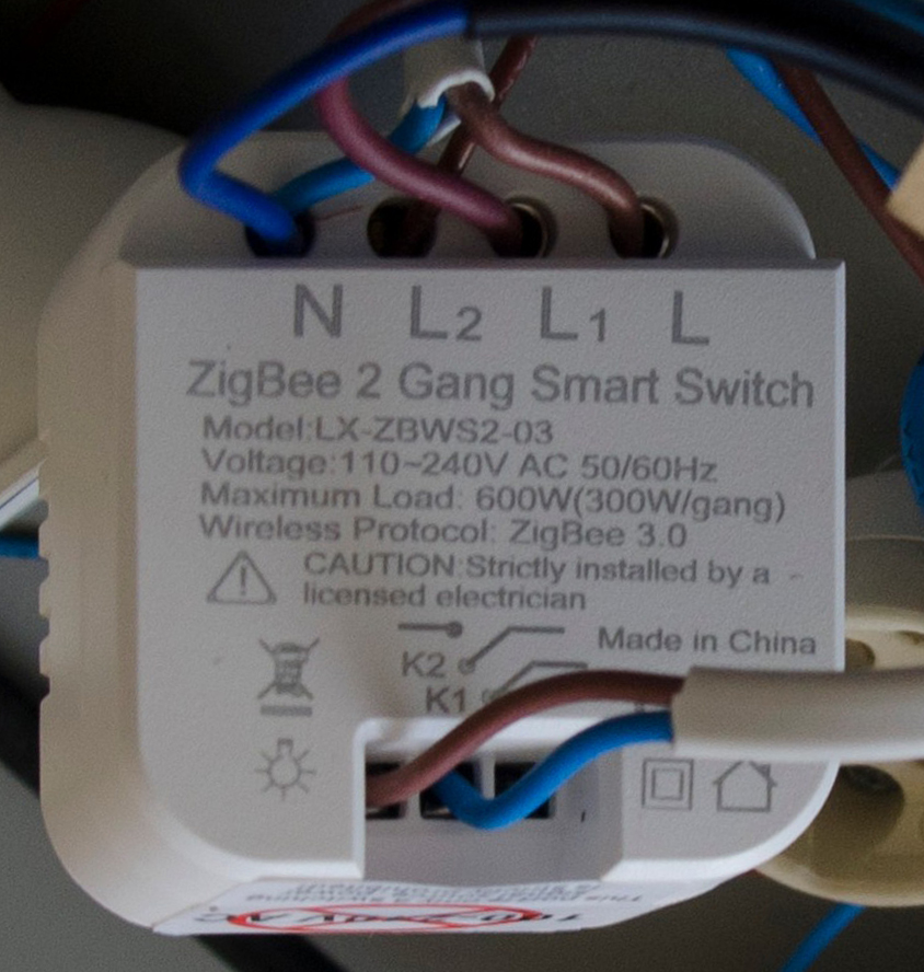

I have done the same for the landing lamp, the zigbee relay DSC_6061r.jpg to work centre our outer or both lights, in the main it works well, however every so often it has a hick-up, the hard wired switch stops working, however when my son fitted it for me, the relay was housed inside the lamp. 20220529_211956.jpg Now it is hard to assess the relay, and since the fault is intermittent, and it still works A1 with phone or voice commands, I have not bothered looking at the relay to see if a bad connection, the switch is extra low voltage so no real problem if it stops working, hardly ever use the wall switches.
However learn from my error, mount the unit where it is easy to access.

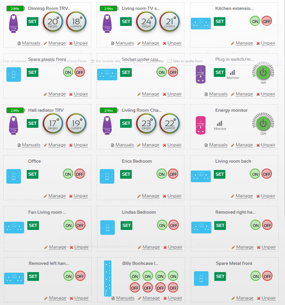

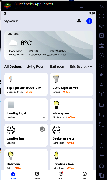

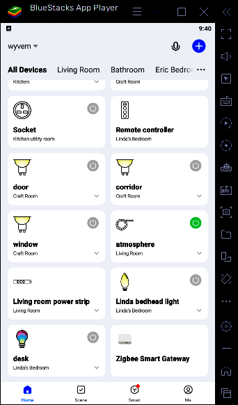

Also using Bluestacks, I removed and reloaded the latest version 5.8.0.1081 N32 about a month back, it has improved, and I can do most things, but the relay has to be opened up and you select one of the two buttons. It often takes me around in circles. It also takes an age to load up around 5 minutes, which means in the main I use my phone. I get reports like 1664742574395.png I would assume that is the emulator? In the end I do get this 1664742719091.png but although most only require a simple click, the landing light one needs to open, and clicking on it returns to this 1664742908567.png screen, 1664743067609.png the times show 4 minutes to reload, that's after blueStacks is already running. Other items do work, 1664743306141.png I can scroll down and switch lights and sockets on/off and it does actually show what is running, shows the strip light in living room is on, where the Energenie Mihome app Mihome-used-crop.jpg does not show what is running other than the energy monitor. Smartlife works A1 on tablet and phone, it is only the PC where it has problems, and the zigbee hub has never really had a problem, the Energenie hub around once a month it needs re-booting.
