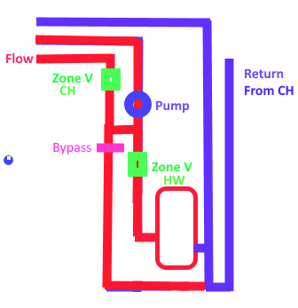

As I am moving to an S plan, I thought I'd ask about automatic bypass valves, as there's a lot of info out there but the question I had, hasn't been answered.
I've worked out a solution (image below) to include one which comes between, rather than before all zone valve piping (it's easier for me to install that way) but is it going to cause me issues and I should install it directly before any zone valve branching and as the last 'return' before the boiler?
The bypass needs to be after the pump and before the valves, in that diagram it is still 'before' the valves by the looks of it. Basically you need to be able to have a path to the valve and then back to the return that can't be blocked by either valve.
Thanks, it is 'before' the valves but not before the pipework leading to the valves. Plus, the distance to the valves from that pipework is 20cm at most. It joins up with the CH return at the bottom of a T, which meets the cylinder 20cm above.
Knowing I can do it the way I suggest is a great help and hopefully helps others, as I have seen people prioritise orders of return connections.
Thanks....again!!!
Yes ... the normal golden rule is the last return on a mixed cylinder and radiator system should be cylinder to avoid reverse circulation but that's normally with radiators. With you not having radiators and it being UFH that's on a valved and pumped circuit, then that shouldn't be an issue.
