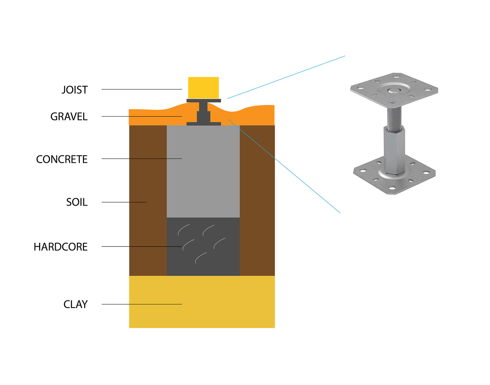

Rather than laying a large slab as logistically it's tricky and costly, i'm thinking I can build my garden gym off a series of concrete pillars. I'm the past I've used a cowley to set the heights and have built directly off blocks but this time I would prefer the attached method, especially as it would mean I could adjust the height to get it near on perfect. In the past i've thought about this method but the adjustable posts were super expensive, now lots of people seem to do them at a much more reasonable price.

Does anybody see these as being an issue, or can recommend something similar that isn't super expensive?

1 you don't usually put hardcore under foundations.
2 you'll need a fairly beefy substructure to your shed if it's only supported by a few points- gym equipment is heavy plus if you're jumping around in there you could get a fair bit of movement of the floor (and thus the whole building).

Thanks for the tips, usually I would prefer a solid slab but pouring this on my own, whilst ferrying stuff 60m to the end of the garden make this a no goer. Pillars like this are easier for me to do a few at a time... I usually put hardcore under a slab, so assumed the same was necessary under a pillar, is that not the case if going down to clay?
I was planning on putting mounts every 1.2m across the width (5m), and 1m front to back (3m) so a 4x2 substructure, maybe 6x4 should be sturdy enough.
4 x 2 to support a floor is deemed adequate with a span of 1800 (its actually a bit bouncy). Problem is your 4 x 2s are supporting not only the floor, occupants and equipment but also the rest of the shed. And you are wasting some of the height having a step up (though it will reduce any problems from damp)

Thanks, I had seen these but don't like the thought of them going directly on the ground, feel they could sink over time. Also quite expsnsive once you factor in their brackets (£45) a pillar, so figured what I was proposing was slightly cheaper but more robust.
It's your money. £200 for fancy jacks, you'll be doing near enough half a cube of concrete (20 points 200 x 200 x 200) and a pile of timber- you could probably afford to pay someone younger and fitter to do a concrete base!

I'm figuring as the max span is likely 1.2m, 6x2 is best (see pictures of my last build ten years ago)
6 x 2 will be a lot stiffer for sure. But have you checked timber prices recently?
