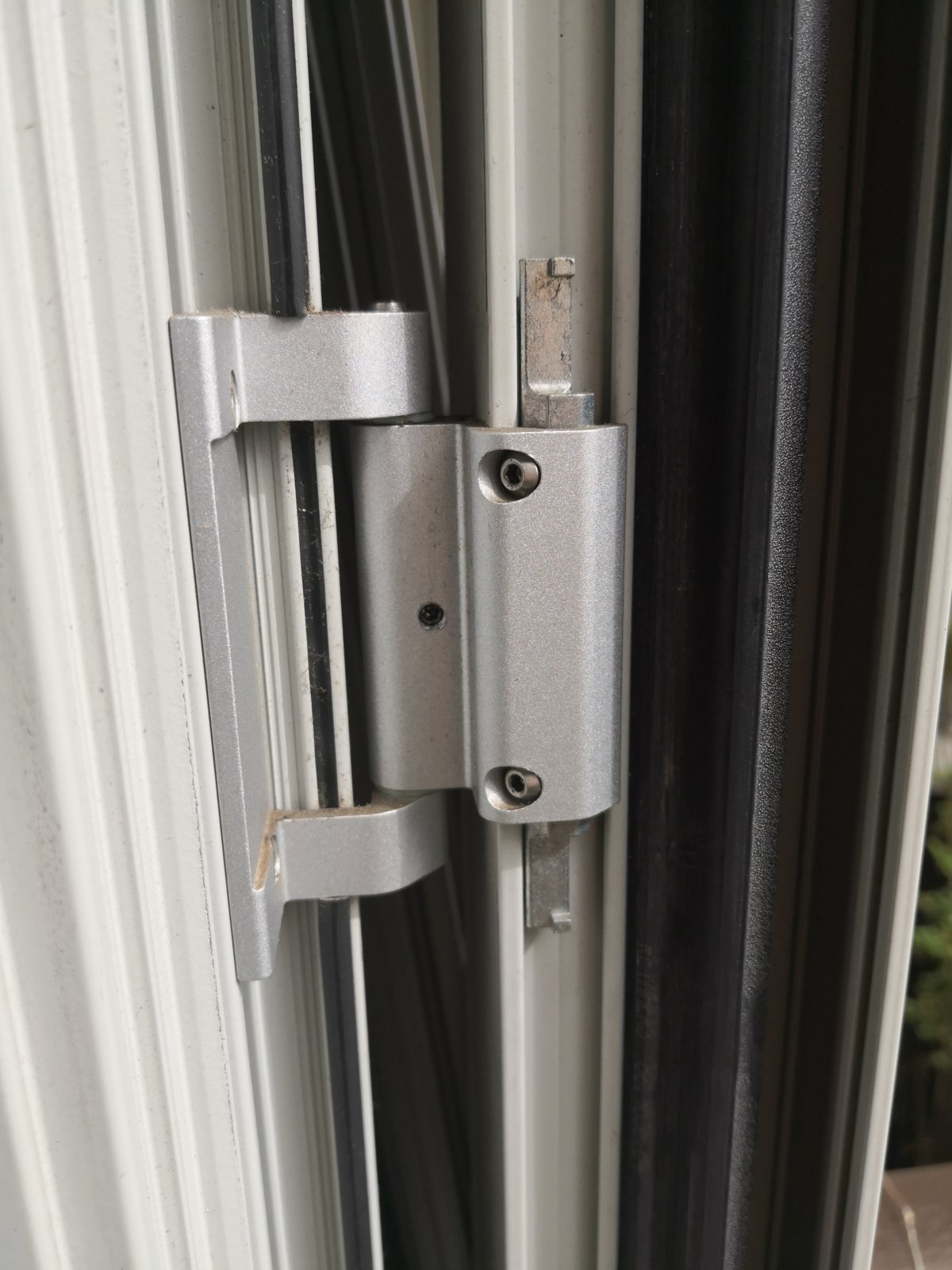

Hi all - we have a balcony door that seems to have sunk. I want to readjust it but have no idea how the hinges work.
Looking at guides/videos on the web, they all seem to be for a very different type of hinge.
I've included a photo below (there are 4 of these down the door) - does anyone have any experience of hinges like these?
Quickly testing the central left allen key hole tightens and loosens easily but with not noticeable effect. The two on the right loosen but it just feels like I'm, detaching the door from the frame rather than adjusting anything.
Any help would be much appreciated!
Looks to me as though, with the two screws shown loosened (on all 4 hinges) the hinge parts with the screws should just slide vertically on the mouldings fixed in the door-frame channel.
