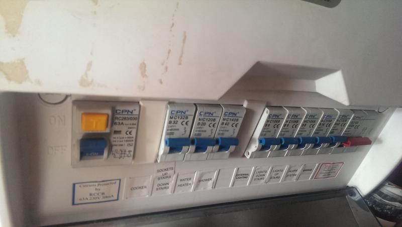

First of all, we need to know what exactly the device that keeps tripping is, can you tell us exactly what it says on it, or even better take a picture

This is why Adam has asked what is tripping. If you take a photo of the consumer unit, indicating which device is tripping out, we'll have a better idea of whats actually going on (or if you cant take a photo, describe exactly the device which trips out, including any writing on it)
Aragorn...thanks for the response.
The two pictures attached show the entire consumer unit and the mains trip that is tripping. The circuit breaker to the second from left (Sockets Up and Down) is the circuit that this is on (obviously).
Thanks again for your help...really appreciate this.

RCDs do not trip on overload. They trip on earth leakage. I guess the device at the left hand end with the orangey button is the device that trips?
It is likely that you have a number of devices with mains filters (that'll be TVs, PC, printers etc). Each will cause a level of earth leakage, these may well add up to create a condition that the RCD thinks is a fault.
There may ne a single underlying problem, but you'll need an electrician with the proper test equipment, and a brain, to properly diagnose this.
And you have to be prepared for the fact that the only solution might mean partial rewiring and a new CU.
NOOOOOO

It could be that the water heater is a little shaky. (leaking ha ha).
Is that in use? Turn it off at the dounble pole switch next to the water t ank.
Also the RCD itself may not be working properly. CPN isnt exactly a premium brand :mrgreen:
You'd need the electrician with a brain to test it properly.
