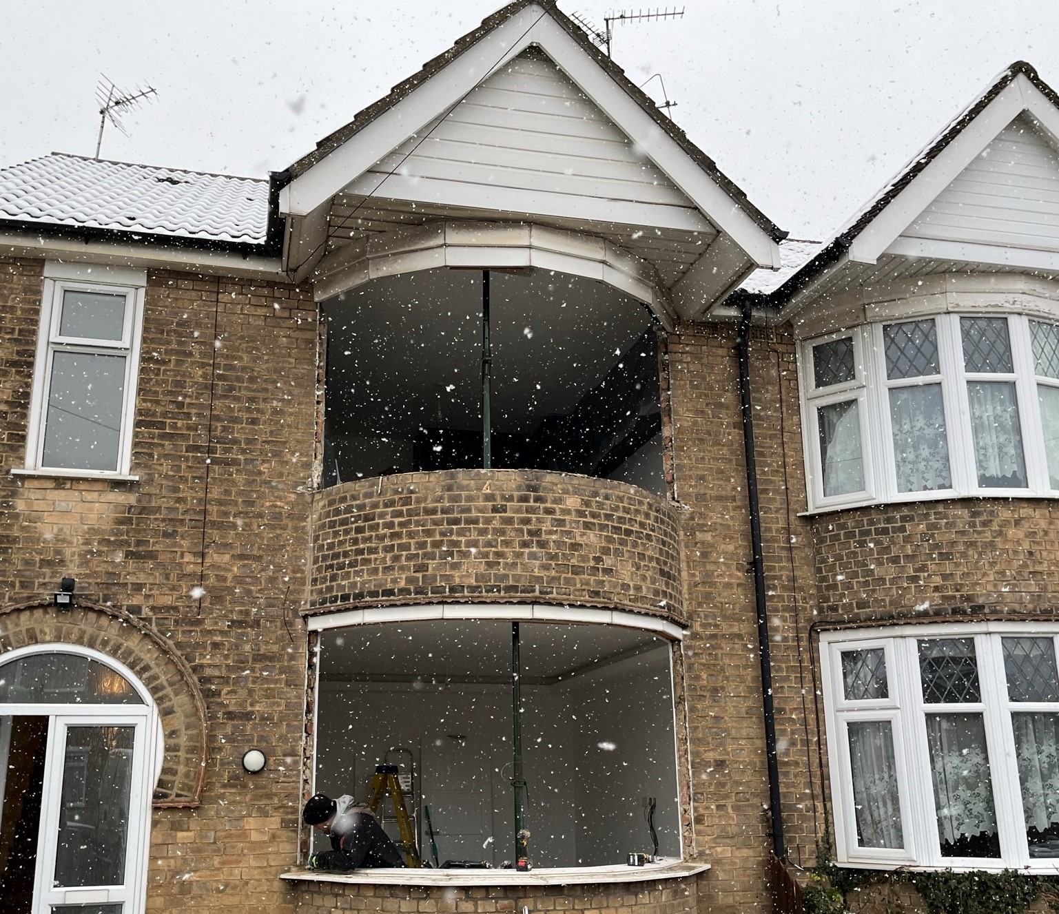

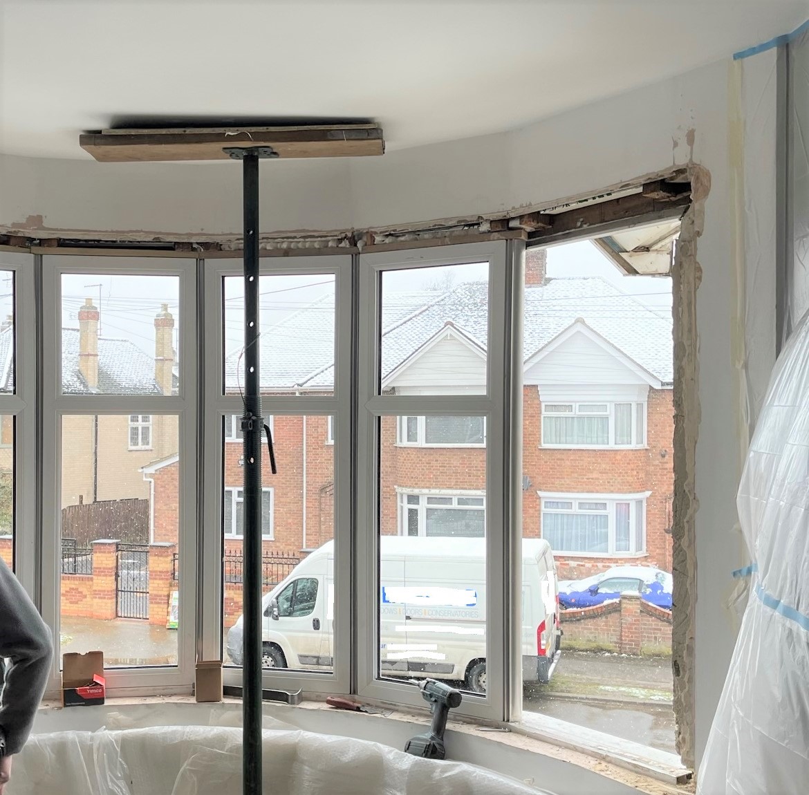

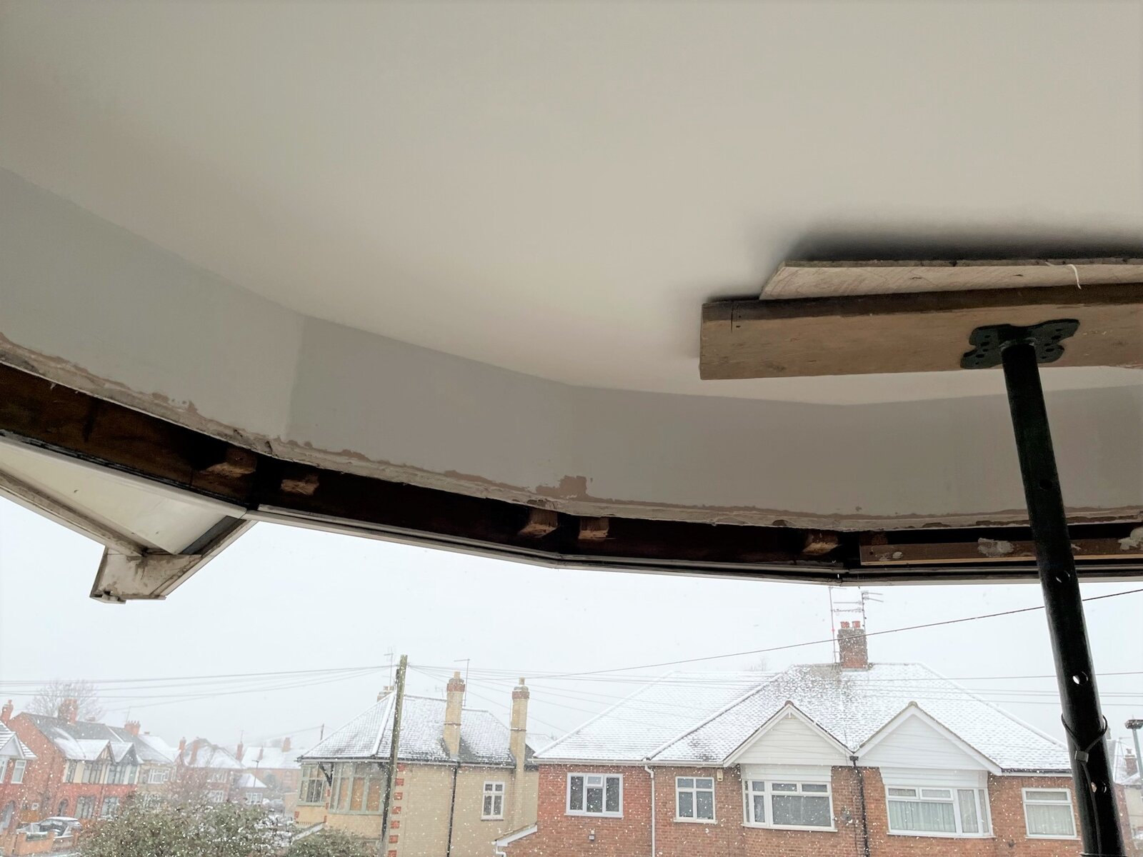

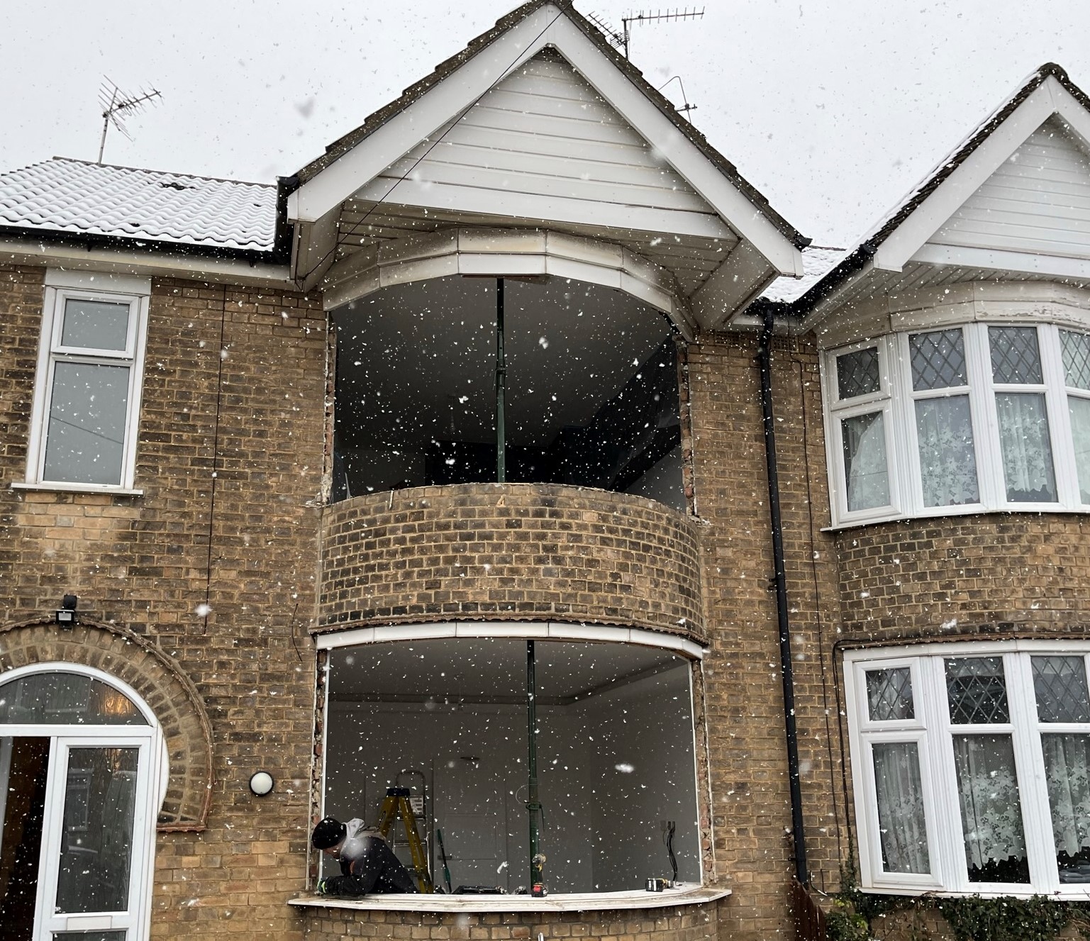

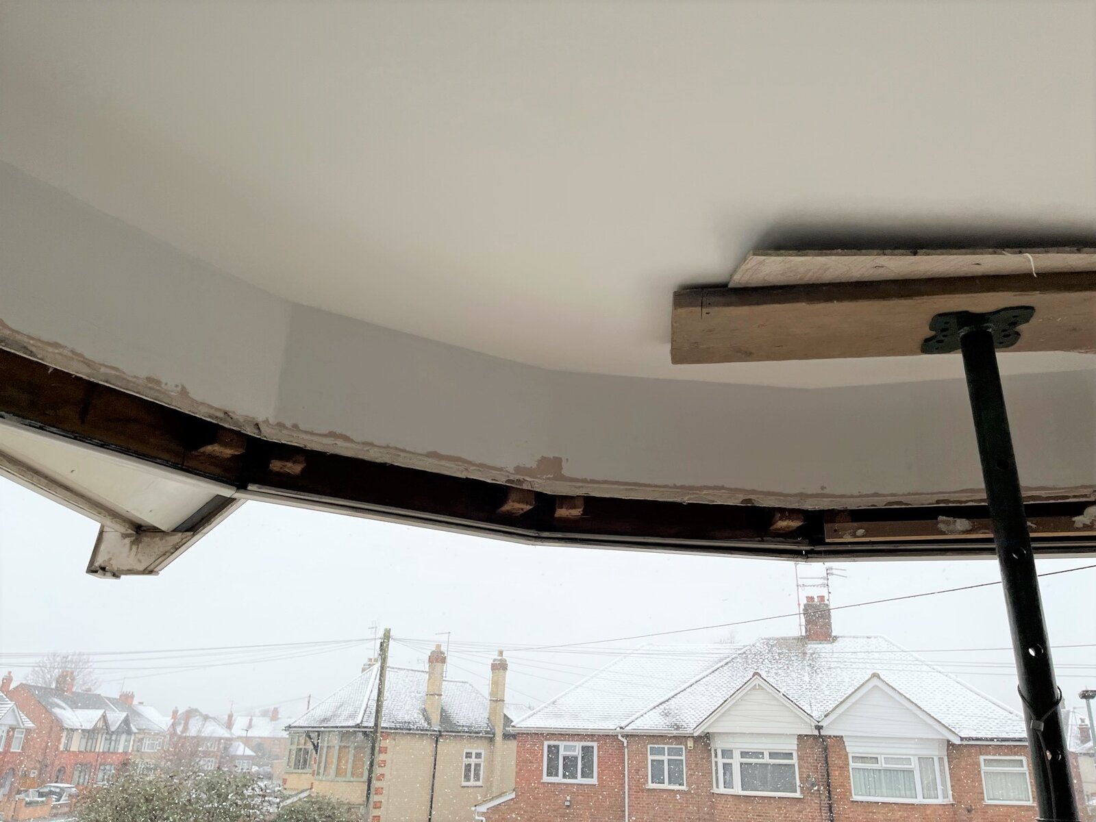

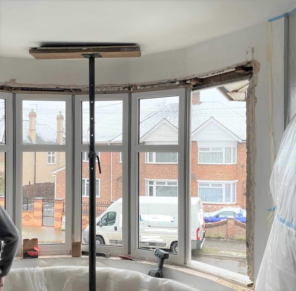

Hi,
I have attached some more pictures, which will help to visualise.
My Main questions now are;
1) Is the Roof Structure above the top bedroom window load bearing onto the Window Poles?
2) Looking at the pictures, should there be a Steel spreader plate above the poles to carry the structure above it?
3) Are pole jacks standard practice/standard for every bay window install? Or are some poles designed to sit on the cill? Reason i ask is that so i can go back to to company with an idea of how it should be done, rather than getting fobbed off.
Appreciate everyones help!

1/ Pretty certain it's a cantilever roof above but best practice would be to fit bay jacks
2/ Yes, spreader plates do what they say, they spread the load rather than point loading
3/ Jacking poles are a requirement as a means of support if the existing bay was load bearing
Read Approved Doc A: Structure
In a way I feel sorry for the fitters, I've been a fitter and I know what it's like, you have no control over the job, the job was sold, it was surveyed and you've been sent to fit, you get given the parts and told you have 2 days. They'll know it needs bay jacks but they can't create waves back at the office, the boss will moan and say get on with it, no one will question the surveyor for not including bay jacks. Looks like it's snowing too, they have both bays out, they're now under pressure to at least get some frames in and the last thing they need is a lengthy argument with the boss and surveyor about the lack of bay jacks.

Hi,
The weather was really bad! raining/snowing and windy! They had removed both bays, so the house was open to the elements totally.
At first they were planning on cutting the bay cills segments, to get the correct angles and then they said they were going to glue it all back up. This I refused straight away, as it just seemed like a big bodge. This is when they came up with their plan of re-using the old cills temporarily until they receive the new ones.
At first I though it was ok, but the more I think about it, and the more research I have done, including the invaluable advice on here it is really starting to worry me!
I understand mistakes can happen, and was perfectly fine with the job being delayed. The house is not currently occupied, so I am not majorly rushed. Plus it is a bonus of the fitters as well. But I want the job to be done perfectly as it should. I only think that's fair.
What would a re-enforced cill look like? Would it look physically any different?
Don't let them fob you off with a reinforced cill, it's a U channel tin section that is slid into the back chamber of the hollow cill, the sections don't even meet but stop short by 100mm from the cill mitre joints/welds, they have to because there's no way of welding the reinforcement together once it's inside the cill. A reinforced cill will not hold your brick barrel up, the weight needs to be transferred down through the pole and onto the brickwork below, there should be no weight on the cill, it should in effect be a floating cill

If it was me and the company were installing new windows on a bay like that without appropriate jacks/support, I think I would probably go find a tame building surveyor to come out and report before the job is finished. It's difficult to argue as a layperson against the "expert installers", and you really don't want to have the bay shift afterwards and have the hassle of chasing after the event.
It would probably be money well spent and would give you ammo to get the job done properly. @crank39 obviously knows what he is talking about.
There is no need to waste money on building surveyor. Crank and others ( myself included ) have already stated that the way the installation company are trying to rectify this mistake is completely wrong. Put basically, if they don't put baypoles direct onto concrete cill/ block work and put them onto the upvc cill ( regardless of reinforcing as explained by Crank and even some cill ' reinforcing ' is reconstituted plastic rather than metal ), then there is a REAL possibility of movement , or even worse collapse. If the Installers can not see this and will not do it correctly then ask then to leave site . If they are Certass or Fensa registered they should know about the support needed, as its written into scheme handbooks quite clearly . I am concerned that they are looking for a cheap and easy fix and in this case the ONLY fix is frame removal and upon fitting the new cill jacking kits used on every angle and frame joiner with Reinforced poles, the entire height between block work and ' jacked up' to fit nice and tight so there is no possibility of movement

Hi Everyone,
The window company have agreed to take out the frames on the bottom, and re-do it properly with Pole Jacks sitting on the brickwork.
They are however adamant that the top window does not need window jacks and claim that it is not load bearing. They are intent on leaving the poles resting on the UPVC cills. Shall i push for Pole jacks on the top windows too?
Also, is there anyone on here that could recommend a structural engineer or building surveyor, that could put it in writing formally whether the top window is load bearing and whether it needs jack poles?
Thank you in advance
Get building control to pop out, someone with letters after their name, also if installer isn't fensa then BC might have to sign it off so an ideal opportunity for them to see what they're signing off. Glad they're fitting them in the lower bay though, they wouldn't be if they didn't need them, they knew full well it did
