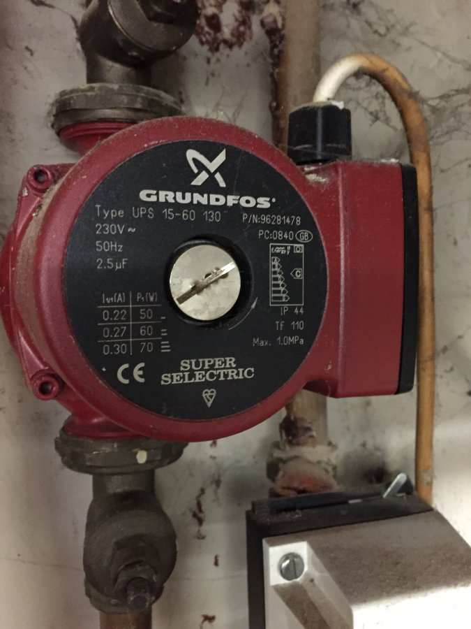

So far, it is an old Potterton Netaheat MKIIF 16-22. There is a Grundfos Type UPS 15-60 130 above the boiler with a Danfoss HPA2 motorised valve.

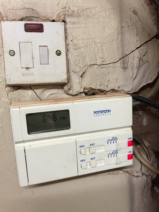

The boiler is controlled by a Potterton EP6002 Programmer. I replaced this a few years back as the old EP2002 failed. I assume possibly wrongly that it would be a straight swap. Again, if someone can correct me if I am wrong it would be appreciated.

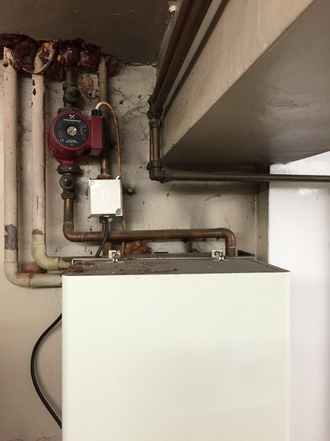

Pictures would be helpful. Possibly you have gravity hot water so the 2 port valve is to stop the gravity circulation. (That's presuming you are correct in thinking the 2 port valve is on the hot water circuit). First things to do would be to get a cylinder stat installed. Then sort the wiring so you can work the heating and hot water independantly. Getting the system converted to a fully pumped system would be the most efficient solution. But it can sometimes be a lot of work on a gravity system. Converting to a sealed system is often the easiest way to convert gravity to fully pumped
I would guess that the HPA2 is on the heating supply rather than hw.
The theory then would be, hw on, pump & boiler run to heat cylinder in an uncontrolled way, limited only by boiler stat.
Heating & hw on (heating on its own not possible with this arrangement) Pump & boiler run & zone valve opens to allow flow to radiators.
If you replaced the backplate when you changed clock did you re-fit the link from L to 5?
sounds like you could have gravity fed hot water, state of the art for 1970 but not terribly efficient, can you turn on your heating on its own, or does the hot water come on with it?

Looks like gravity hot water. I think The 2port must be to stop gravity circulation to the upstairs rads. Get some quotes to convert the system to fully pumped

This may sound stupid but I am not sure if I can turn them on independently and with he impending cold snap this week I cannot afford to let the fabric cool down!
I don't believe it can be controlled separately despite the programmer having the facility.
I have now uploaded some photos. If there are any specific photos needed, please let me know.
Agree. Conversion to fully pumped will give considerable savings.
I was slightly confused how a pump can stop gravity feeding something above!
Why would be required to convert to fully pumped? A pump on the hot water? I'll take a look at the manual and see if that means anything to me.
