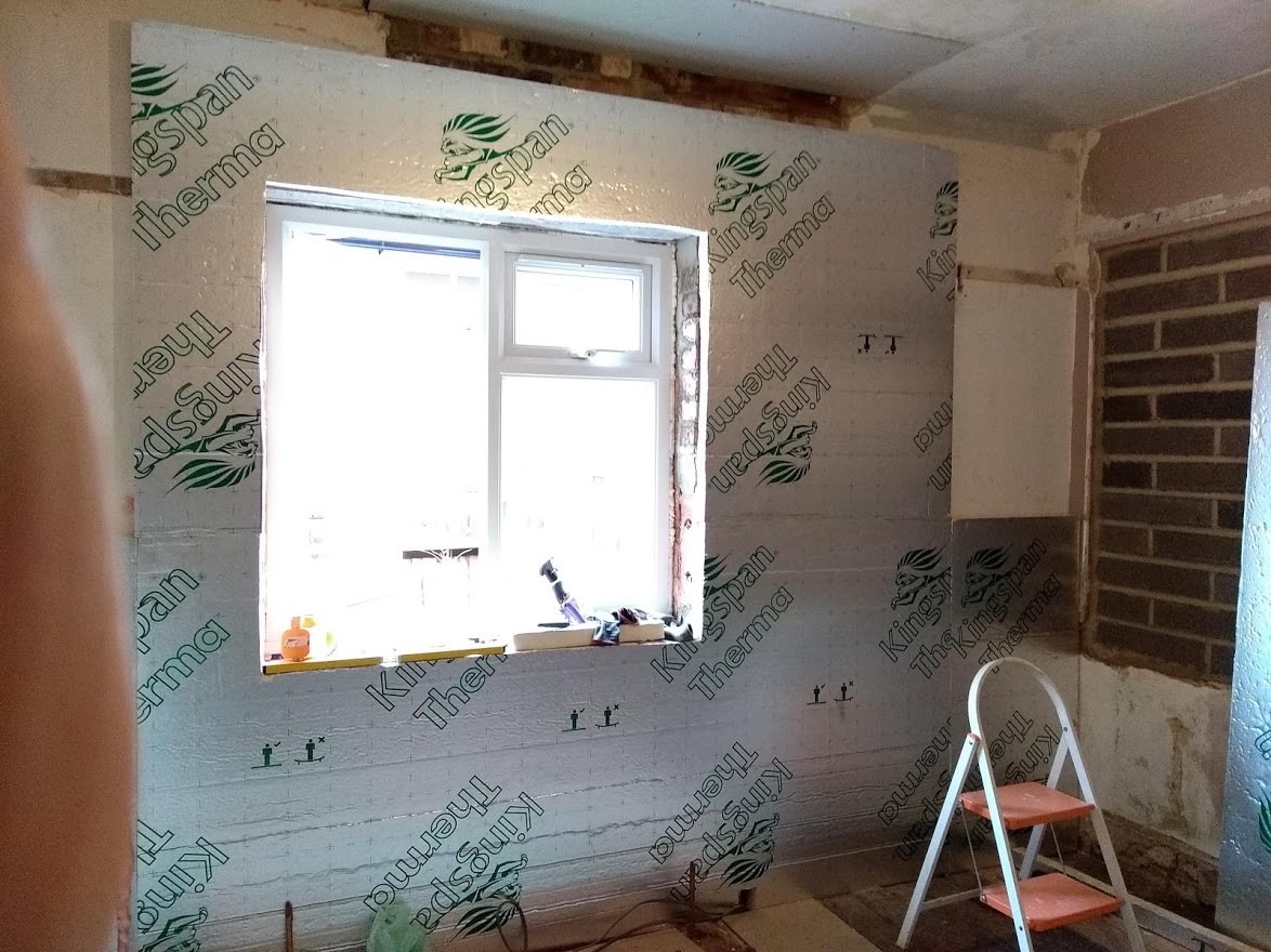

Yep, I stuck 50mm Kingspan to walls with Everbuild Dryfix Foam, silver taped all joins, then stuck plasterboard on top of that with same foam.
The downside of this method is that there is a lot of time spent waiting for the foam to cure (4 minutes) and then applying pressure to the board so the foam does not push out when still expanding (varies depending on how much foam or space for it to expand into).
But, for a DIYer with no experience of using other materials it was great. I didn't use mechanical fixings and everything is still standing 4 years later. No cold, mould, no damp, lower bills.
I was lucky in that there were no electrics on outside walls, and was having some rooms renovated completely with new radiators etc which made it easier. In my front rooms with bay windows, I didn't insulate the bay / radiator area. Too tricky! I am considering having external insulation just on the front of the bungalow, but a job for later.

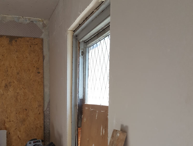

My bedroom - I didn't stripe plaster off the walls, too dusty and messy!:
221878
A room with new window, no rad etc. (there was a chimney there before)
img_20190125_103857820-jpg.221879
