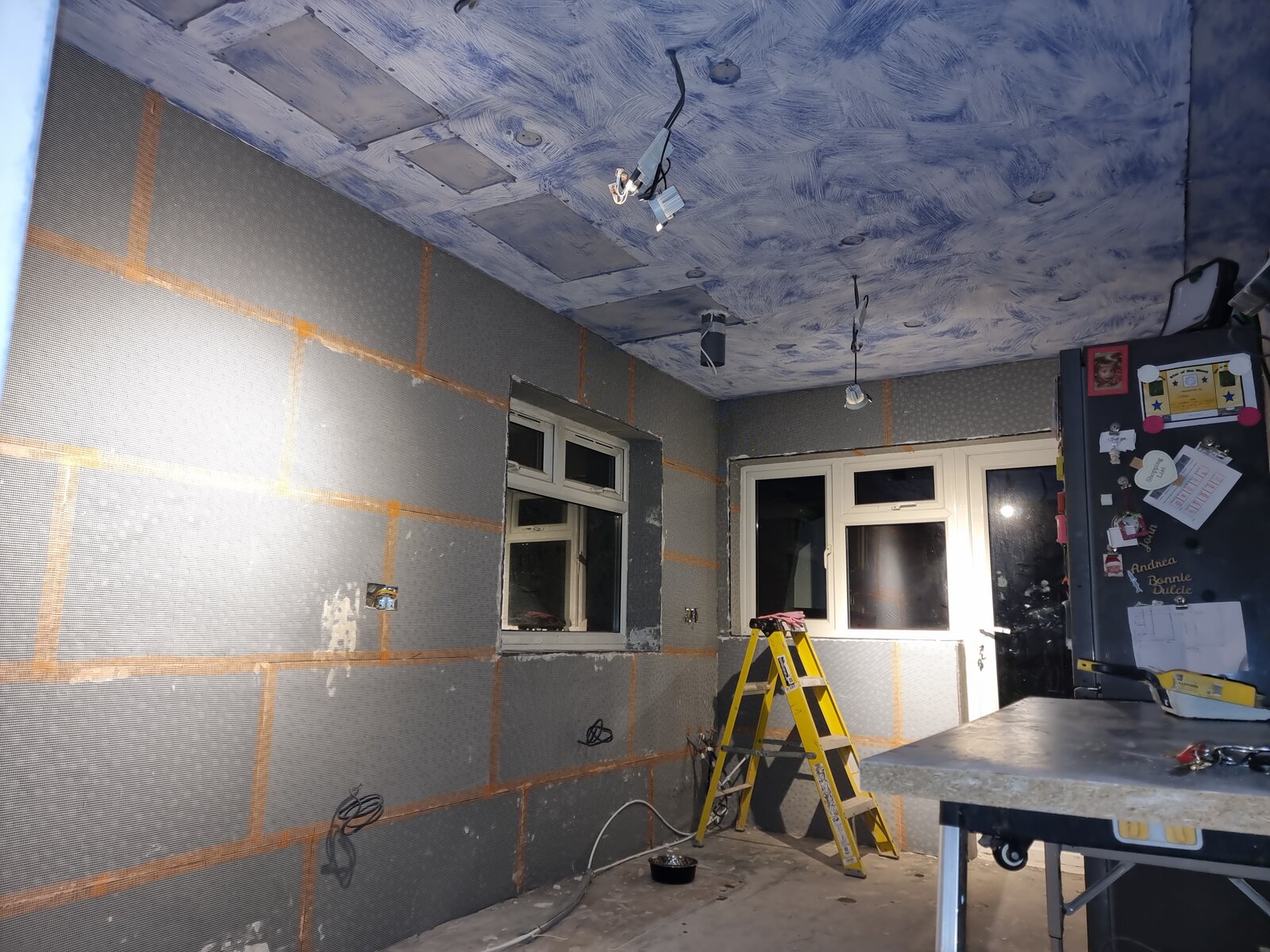

You can make your own insulated plasterboard easily enough (PIR, non-solvent adhesive, 12.5mm boards).
You can dot and dab this composite to your solid walls- no problem with damp leaching through the 'dots' to the plasterboard, the PIR is not porous. This works very well if the brickwork is a bit poor.
Downside is electrical services need a hole in the insulation.
