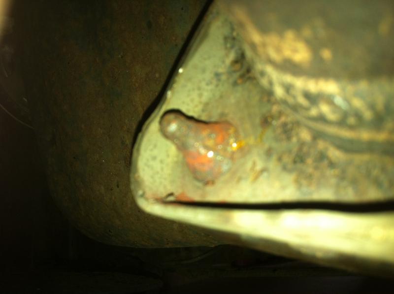

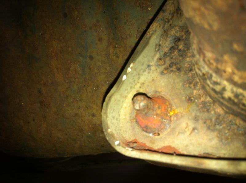

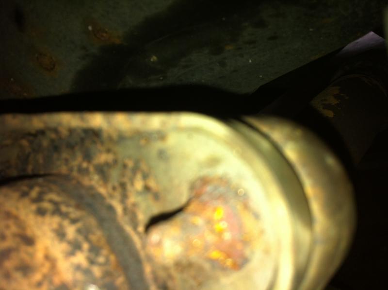

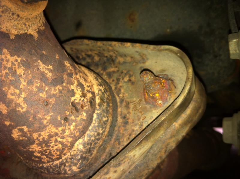

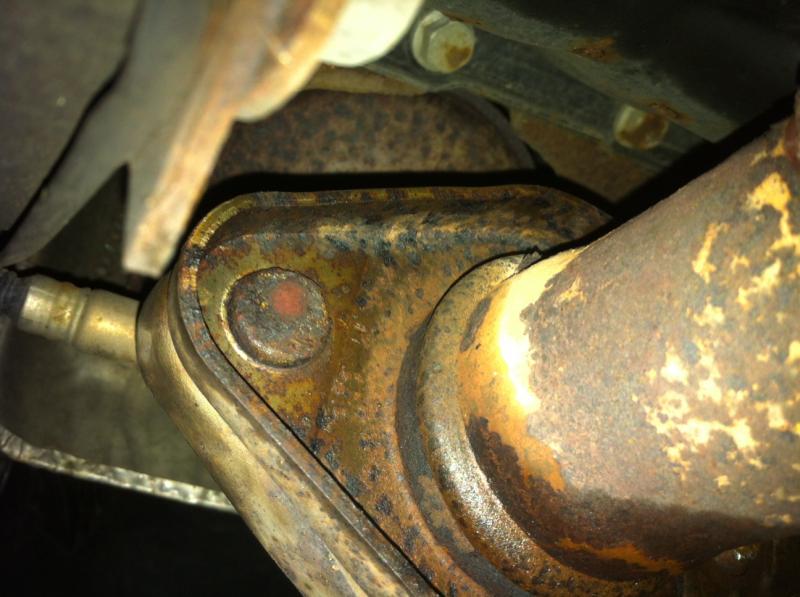

Hello,
Its the first time I've posted so I apologise if I miss something!
I am trying to remove two (what I think are) bolts securing the mid pipe of my exhaust to the manifold but I cant even identify what they are? Can anyone advise please as to what they are and how to get them off!!
Many thanks in advance!
The first four pics are of the nuts - or whats left of them after heat and rust have taken their toll - and the last pic is of the captive bolt head thats welded to the flange.
To split the exhaust, the nuts will have to come off - either by tapping a socket on to them, or by cutting the nut off with an angle grinder (and replacing the other part of the flange too.
The two pieces of exhaust (cat and pipe) mate together to form a bell flange - which are good to prevent gas leaks. The flange holds the two together.
John :)
Can you get a hacksaw blade in the gap between the two flanges, too cut the bolts?
Then drill out the captive heads and replace with ordinary 8mm bolts and plain nuts.
If you had the inclination you might be able to weld a larger nut onto the old ones, but not easy, but it might just save the bolt threaded part for you. The heat will also help things along.
Welcome to the forum ................... :cool:
Centre pop the captive heads and drill out the studs, start off with a small drill bit and work up to something like 8mm in size.
You will need some M8 Bolts, nuts and washers as suggested if you do this to refit the exhaust, i find its the easiest way for the least amount of swearing and knuckle skinning!
