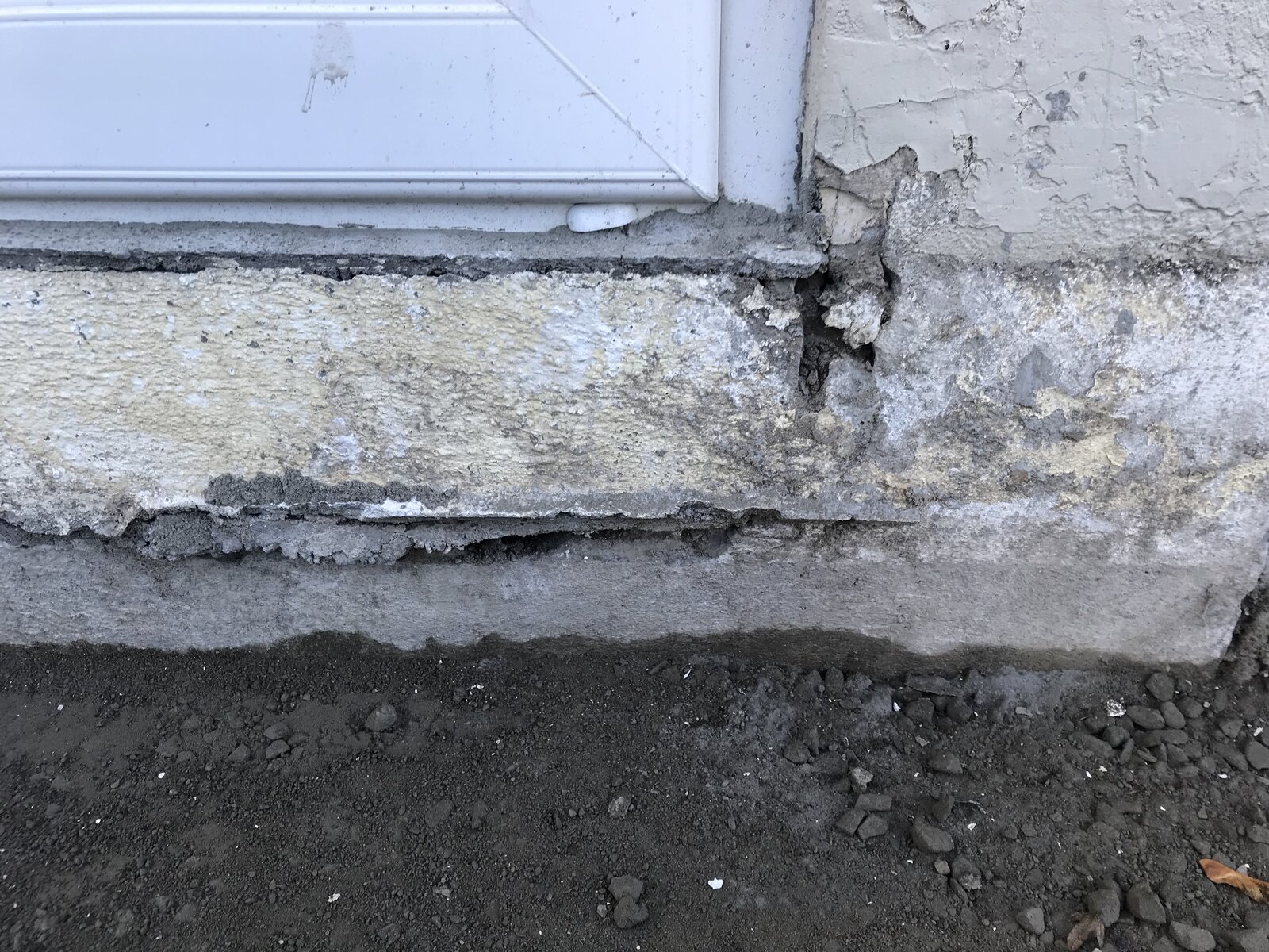

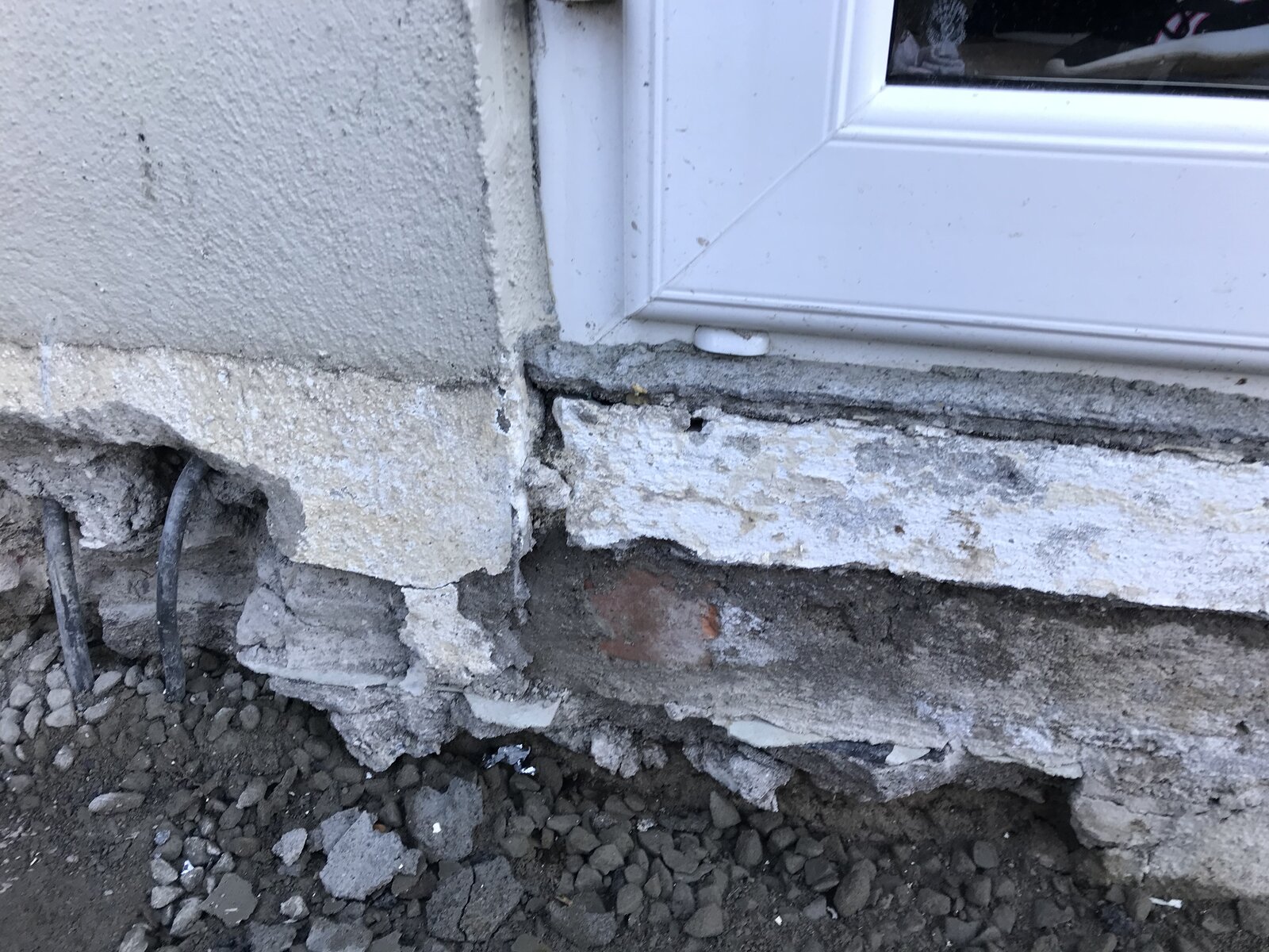

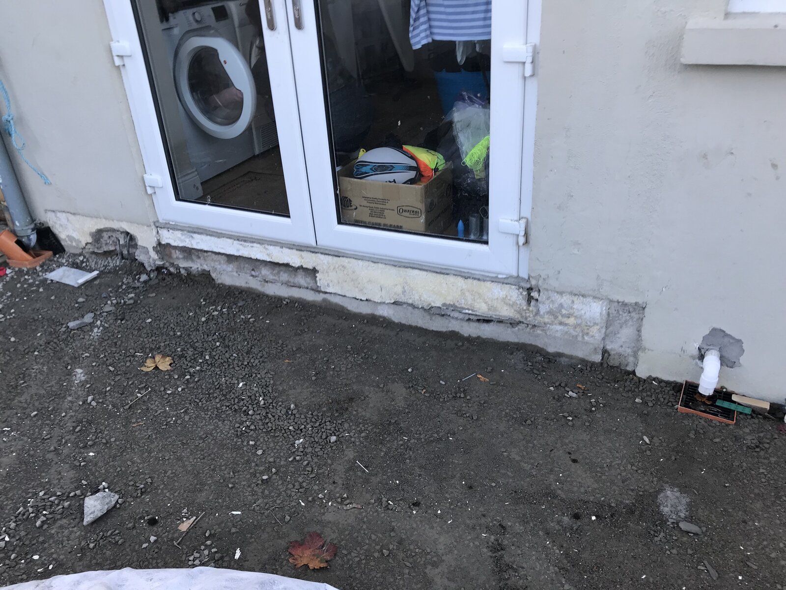

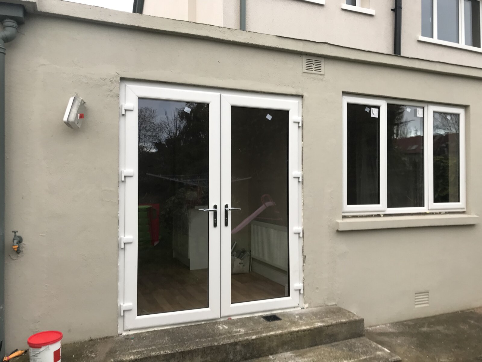

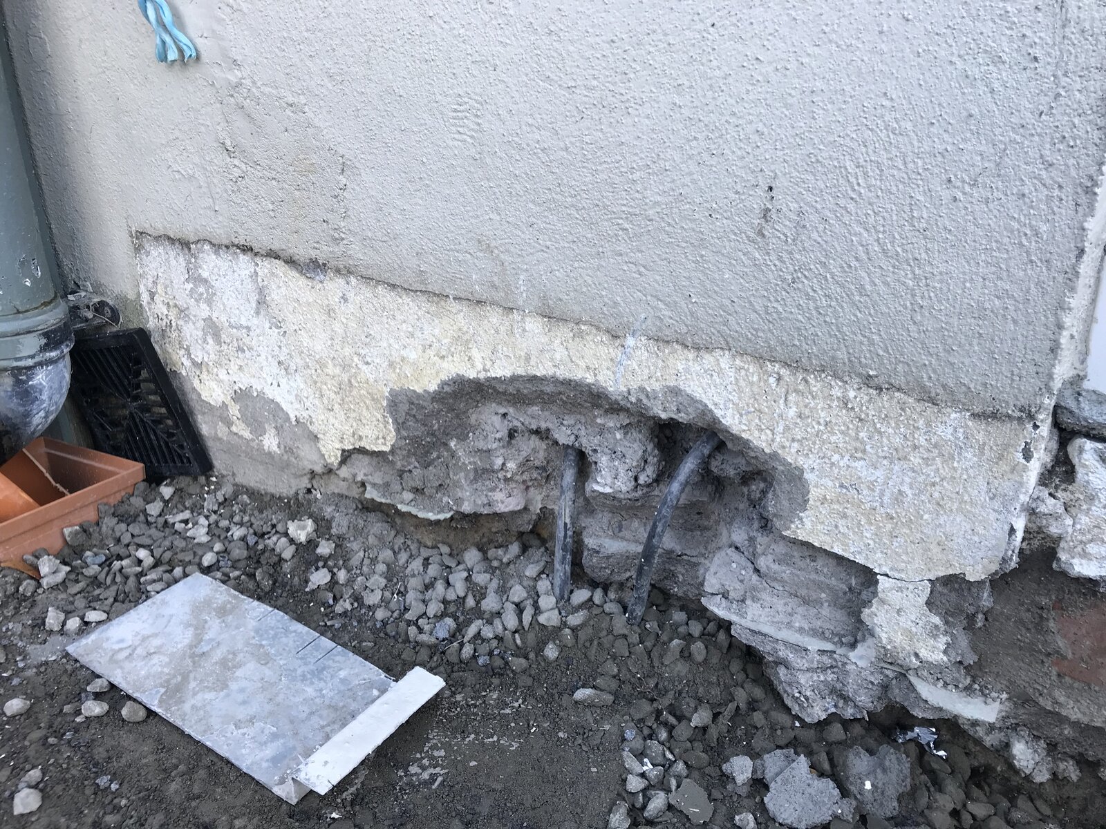

Hi all
Would really appreciate your advice on how best to finish this wall.
Ive just finished the ground works done in preparation for a porcelain patio. As you can see, I’ve chased the electrics (swa). I’ve also taken out an old concrete step which has left an uneven finish. I’ll be putting in a step into the house that will finish about half way up. You’ll also see a lip of concrete at the base of the French door. I called the lad who installed the door a few years ago but he wasn’t much help. Said it was fine.
Would really appreciate people’s views on best way to finish the wall. Thanks all.

It just needs rendering.... scratch coat and bury the cables in it, then a finish coat. Job done

Thanks for that. Sorry - it must seem a silly question for you.
Can I ask about the cill edge under the French door. There was a step which we removed - is there anything I need to do to finish it off properly.
You’ll have to make the ‘cill’ as part of the new step now. Just make sure it’s got a slight slope away from the house.
you could just build up in brickwork then tile the top(s) or have stone etc.
The door was installed wrong - it should have been set back 75mm and the bottom rail set on a extended cill.
Now you can chisel out the lip to undercut the bottom rail and do as suggested above for a new cill/tread sloping away from the door and sealed under the door.
The tread should extend away from the door 500mm to 600mm as a safety measure when you step out of the doorway.
Build the step before laying the porcelin.
The gulley is your FFL benchmark for laying the porcelin.
Knock off render back to clean brick for 150mm above the gulley, including where the old step was.
And install fixed and rendered-in plastic Bellcasts along the bottom edge of the render.
Was there previous a Plinth?
Render cannot be anywhere in ground contact.

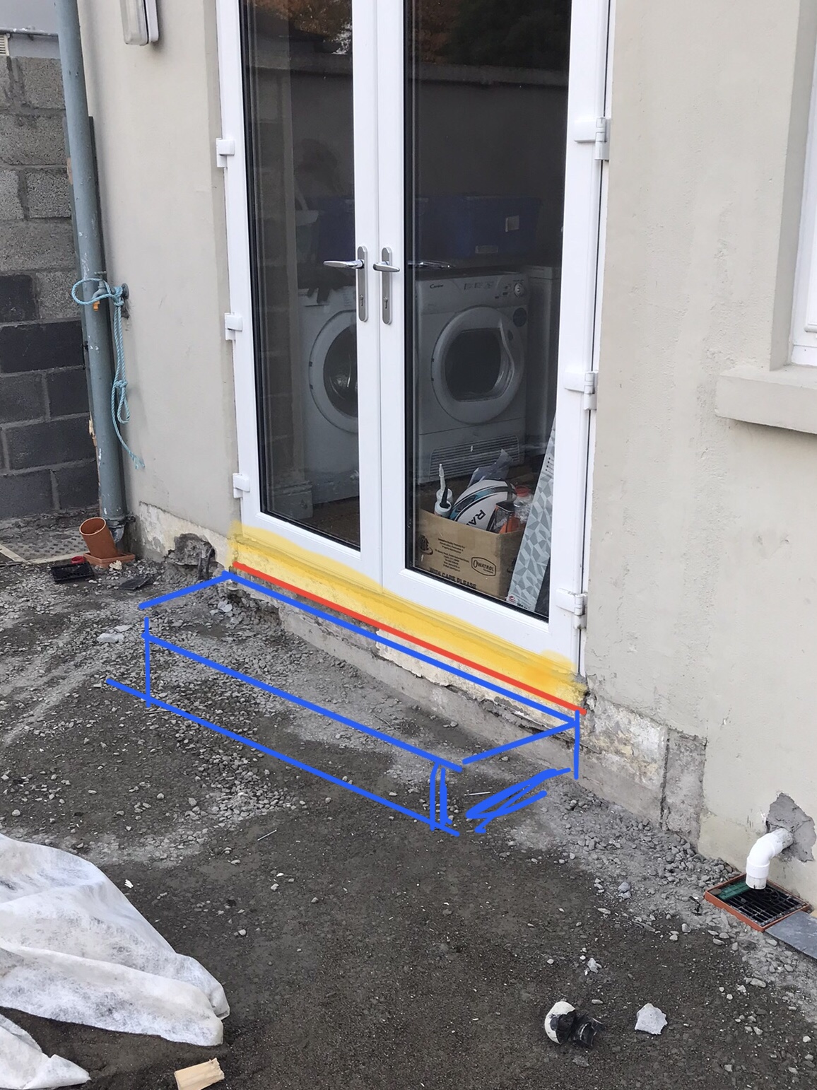

Pic attached of what used to be there - a big concrete step flush with the door.
The plan is to have a porcelain step 150mm below the threshold of the French door.
If I’m reading your post correctly - are you suggesting that I
- chisel out the concrete lip still in place (yellow in pic)
- install new render onto a bell cast across the width of the French door only so that it doesn’t extend past the step (in blue) and is above the step so that water drips onto the step and away from the house.
Am I on the right track or have I totalled misunderstood you both.
Thanks again for taking time to reply and offer advice.

I think what tell80 is saying is to cut a channel (grind/chisel) into the hello old cill.
Once you’ve made your step, slide your tile into this channel (so it’s under the door... just) make sure it slopes away and apply sealant where needed.

OP now you show a new pic with a gulley to the right side of the pic, and a manhole cover on the left.
That manhole cover presumably controlled the finished height of your old yard surfaceat the back of the house and down the side path until the path finished.
Now you show two gullies - are they level? and a manhole cover thats to low. The manhole cover can be raised which means the side path must also possibly be raised.
The gullies can also be raised or lowered with maybe far more work.
This leveling business is important, youve got to work from a benchmark.
The plan is wrong, please as read what i said above - you dont step out of a door and immediately drop 150mm. You step onto a tread surface like mr chibs described above.
You remove render to 150mm above the porcelin surface - you thenclean, point and then leave alone any exposed brick.
Where the render stops you fix Bellcasts and make good the render over the Bellcast. You dont fix Bellcast immediately above the step - how can you?
