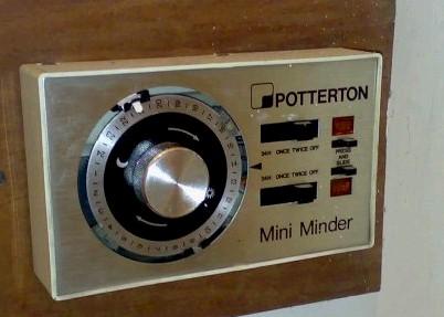

Hi ,
Came across the following image of a "Potterton Miniminder" and visually it's exactly the same as mine (apart from mine says "Landis and Gyr" on the bottom left, and has a dark brown fascia plate, however - the actual time clock "wheel" and two stwitches are identical:
(Hope you guys can see this image: )
I google "potterton miniminder" and it seems like its an equiv of Landis and Gyr "RWB2"
Also (for what it's worth) , the actual backplate only occupies the left hand "half" of the unit (i.e. there is nothing behind the right hand half if that makes sense).
Cheers again
Thanks - Mark
right thats identical to my old landis and gyr controller, mine was an rwb2 with the glow worm mastermind name on it. im 100% sure the RWB29 will be a direct replacement for yours. it will do no harm to take it off and there will be a sticker on the back with the model number just to make sure!
just undo the 2 screws at the top and lift upwards and outwards from the bottom of the controller and it should come right off, your right about the back plate, its just a single DIN so only takes up half
