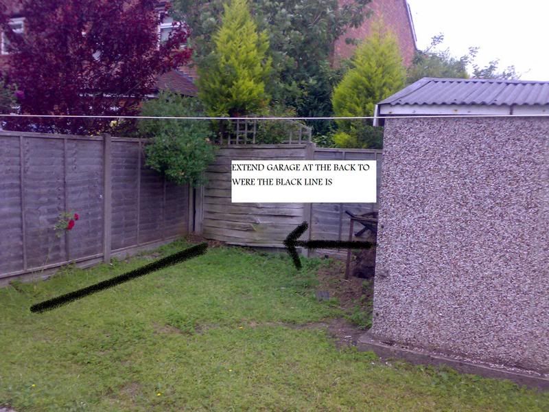

Hi people I have all ways dreamed of having my own home cinema room for my self to escape to from the Mrs as I am all ways forced to watch all the soaps on the TV and never get chance to chill with my mates and play some games or watch some movies.

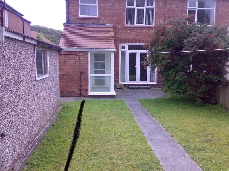

Any way in 8 weeks time I will moving in to my new house and at the back of the property there is a garage/shed which I am wanting to convert in to a home cinema room for my self.

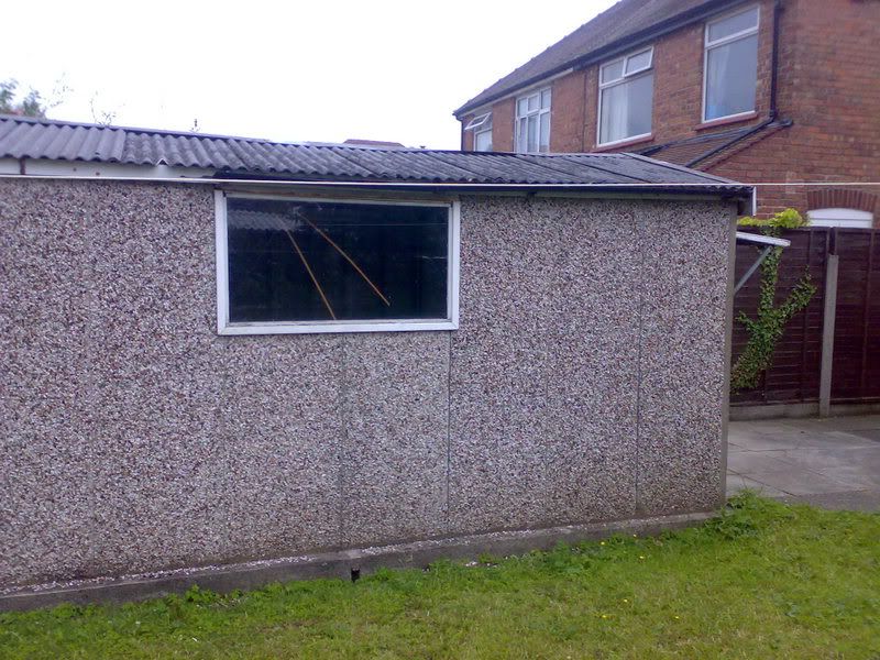

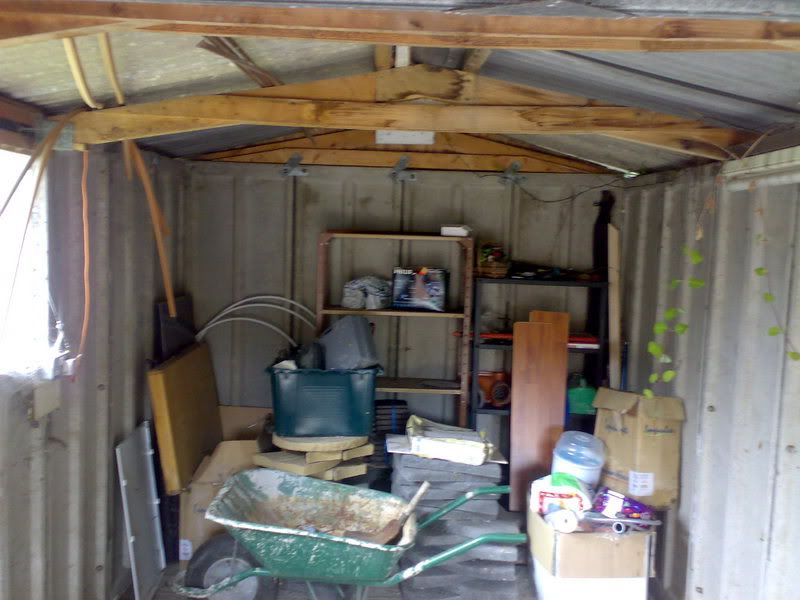

Now I went round to the house today to take a look off the inside of the garage and I wasn't really that impressed as there is loads of gaps in the tinny roof and I am unsure if this garage is something I can build on or would I need to knock it down and start a fresh.
As I am totally useless with DIY I cant really understand were I stand with this garage to work out what my options are, so I thought I would take some pictures and let the pro`s on here advise me on the best way to go about it.
I would defo like to extend the garage thou as it just seems so small inside and I dont see the point in doing a half job as its something I can enjoy for the rest of my life.
They say a picture says a thousand words so I have uploaded some pics, so you guys can see what i am dealing with here.
All so do you think I will need planning permission ?
thanks for any help people !!
EXTEND THE GARAGE TO WERE THE BLACK LINE IS

If you want a half decent environment to run a high end AV system, I think you'd be best to knock it down & start again. You could line it I suppose but something like that will give totally naff sound characteristics even with the system I have; it will also be cold, damp & noisy. Building a half decent AV/play room isn’t going to be cheap either & watching action films & playing games into the night can get very noisy! A decent bass system will drive your neighbours nuts so you will need some serious sound insulation in there or you run the risk of becoming the neighbour from hell with frequent visits from the environmental police!
As far as PP goes, normally it’s not a problem but you appear to have a very limited amount of space there. There is a limit to how much of it you can fill & your proposed play room would appear to take up most of the space you have left so I would advise you speak to your local planning dept.

I like your idea wish I could have the same. The existing garage appears to be made from asbestos cement panels not very good for sound control insulation etc.
I would also advise knocking it down too and using lightweight single skin thermal blocks which are easy to handle and give good noise and thermal values.
