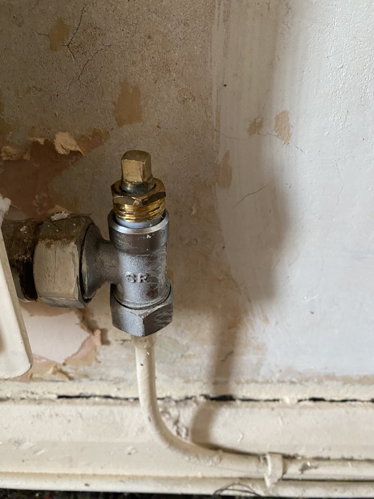

Hi all
Been helping my Aunty who has jus minded into a property and it needs a lot of work.
All rads were isolated except fir living room.
I opened the rest and tapped the TRV to get them to open.

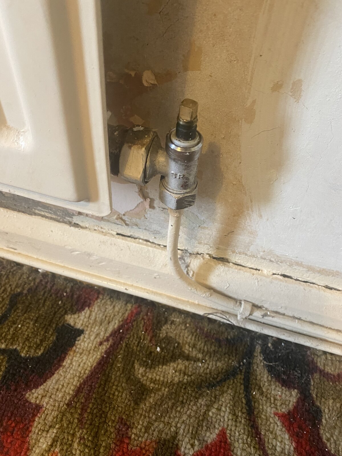

I’m stuck on one lock shield, when I try to open it the whole valve comes out and it’s still weeping when screwed fully back in.
It’s looks like an old type lock shield with a taper fit (not compression on the rad tail side).

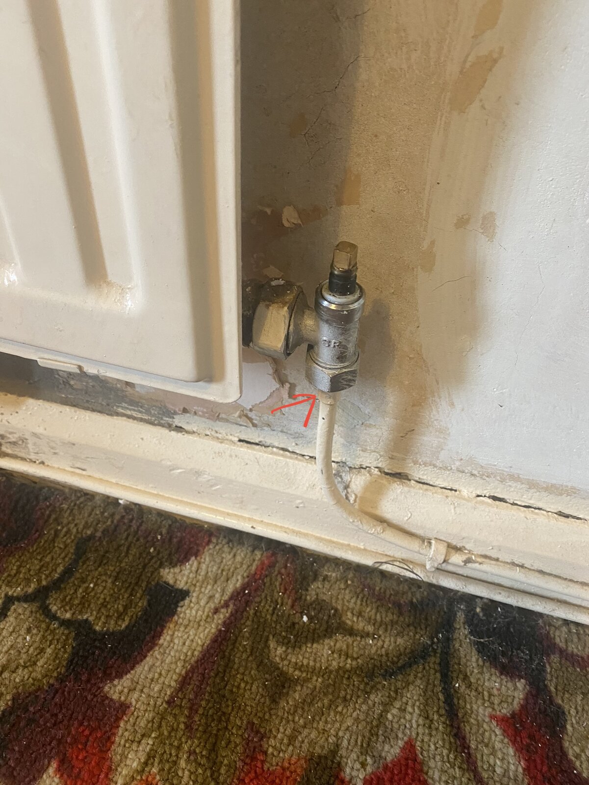

Also pipe is 10mm but after just looking at pics I took has it been increased to 15mm (red arrow).
What are my options here with replacing/repair?
I would like just to drain rad and just replace the valve body (leave tail in place) but so they still sell the ‘taper’ fit valves?
Anyone advise please.
Thanks very much.
Pics below.
Looks like a standard lockshield valve , with 3/4 union fitting at the valve tail ,and the 10mm supply pipe has a fitting reducer taking it to 15mm into the valve.
+1, just a normal lockshield. Available in any of the sheds, the issue you may have though is the union end going into the rad tail may be slightly different. The new one may use a rubber seal where the old one may be a brass interference fit, if so they may not be compatible and the tail may need swapped out. Nut on the pipe may also not be the same and may need swapped too. Depends on hold old the one fitted is.

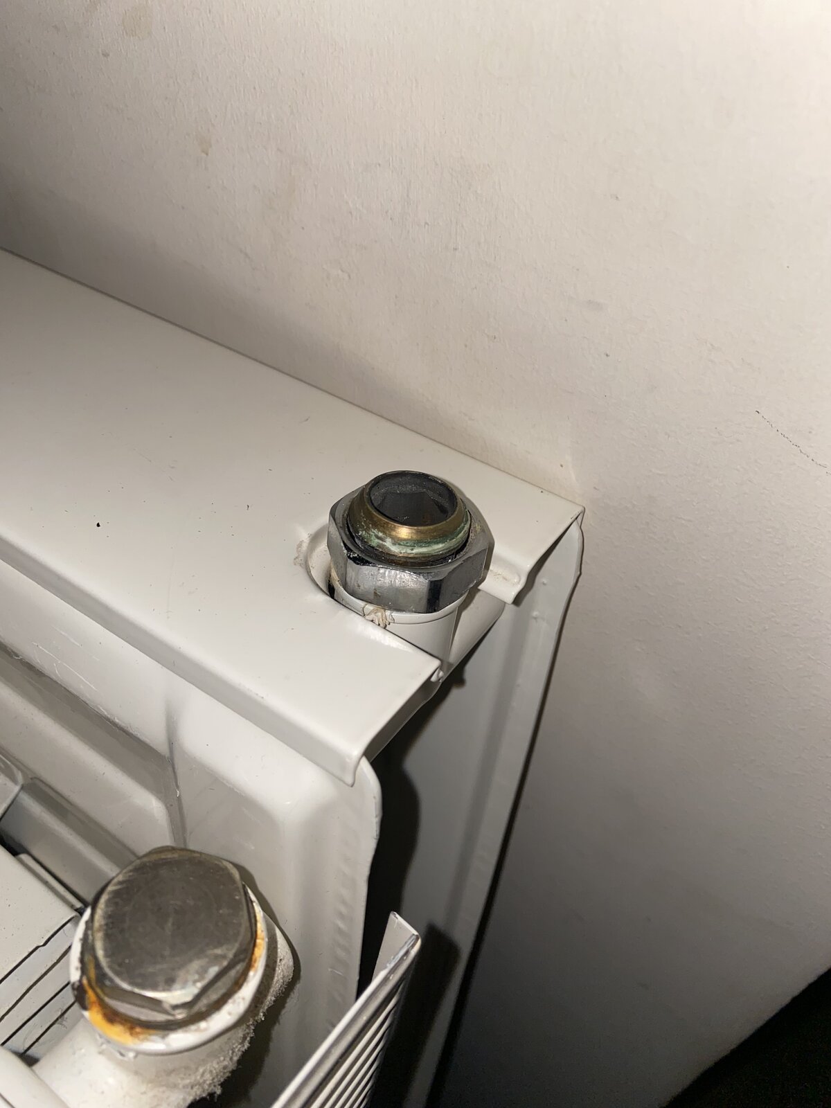

This is an interference lock shield i removed a few weeks ago. (Pic below)
I just detest removing tails from rads I never seem to get a decent seal even after 15 turns of PTFE. (I’ve also failed with the Locate 55 string stuff in).
I’m wondering have I got an old shield hanging about to fit.
Pic of interference fit valve type.
Looks like Toolstation no longer do them?
Are interference fits still available??
Cheers
Buy some gas PTFE tape, 7 turns with one very slightly overlapping the end so it catches and Bob's your aunties toyboy.
I don't think the old just brass unions are available any more. The new ones do have an interference fit - ball into a cup but I think they use the rubber seal as an extra, so not sure if the ball end on the valve would be ok on the old cupped union end, could always try it.

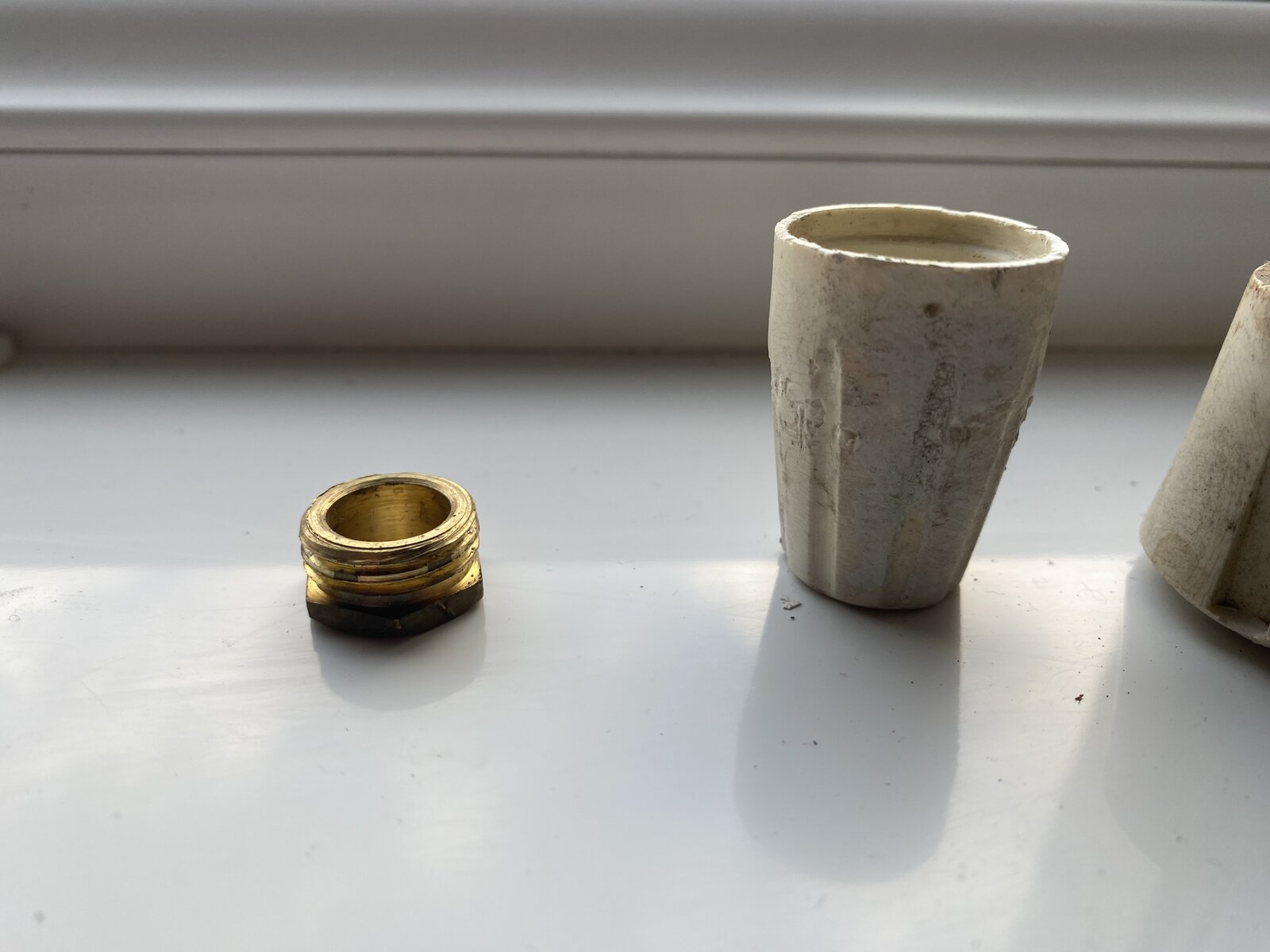

What I did find today on a window cill was this below.
Is this not the ‘part’ that actually holds the inner ‘valve’ in place?
Has it somehow been removed by someone trying to just open the lock shield?
The boiler has zero pressure and it seems to much of a coincidence.
I placed it on top of the shield just for pics BUT should it push the valve back in place ??
I did apply light pressure just manually/fingers ams could not see how it would bite/catch a thread.
If so this could just be a simple fix once reseated.
Thanks once again.

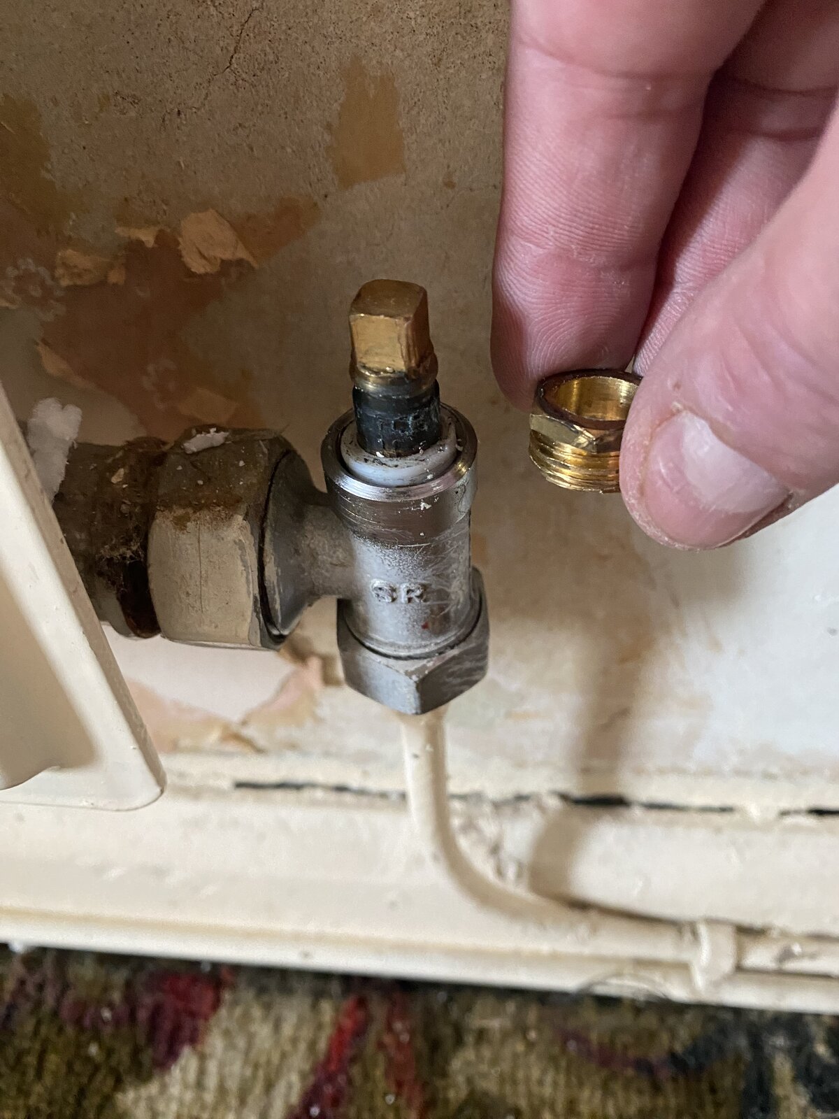

Possibly it is. Close the valve fully clockwise whilst pushing downward. Then see if the white bush can be pushed down,if it does and reveals a thread ,try screwing the part you found into it.
So the white bush part is not threaded?
It it actually held in place by the brass bush I found?
It seems way to much of a coincidence to find it with valve covers.
I’ll check another old existing valve later and compare it.
Cheers
looks like the nylon gland packer, it would normally push all the way home down inside the valve and then the gland nut tightens down to hold it all in place. You need to be careful as that looks like the valve internals might just pull right out of there if you loosen it too much.
There’s no pressure there anyway.
Only got HW.
So the gland just pushes in and nut holds it?
Want I do t get it that it’s has 1.5/2bar in it like that and was o my a very slight weep.
I checked other rads lock shields and the nut definitely goes in there.
I’ll have a play tomorrow if I get chance.
Cheers
Basically you need to get the nut on and press down as you tighten, hopefully it will catch the threads and as the nut tightens it'll push that packer back down. Have the valve stem tightened down as if the valve was off. Don't over tighten the gland nut otherwise the valve stem wont turn.
