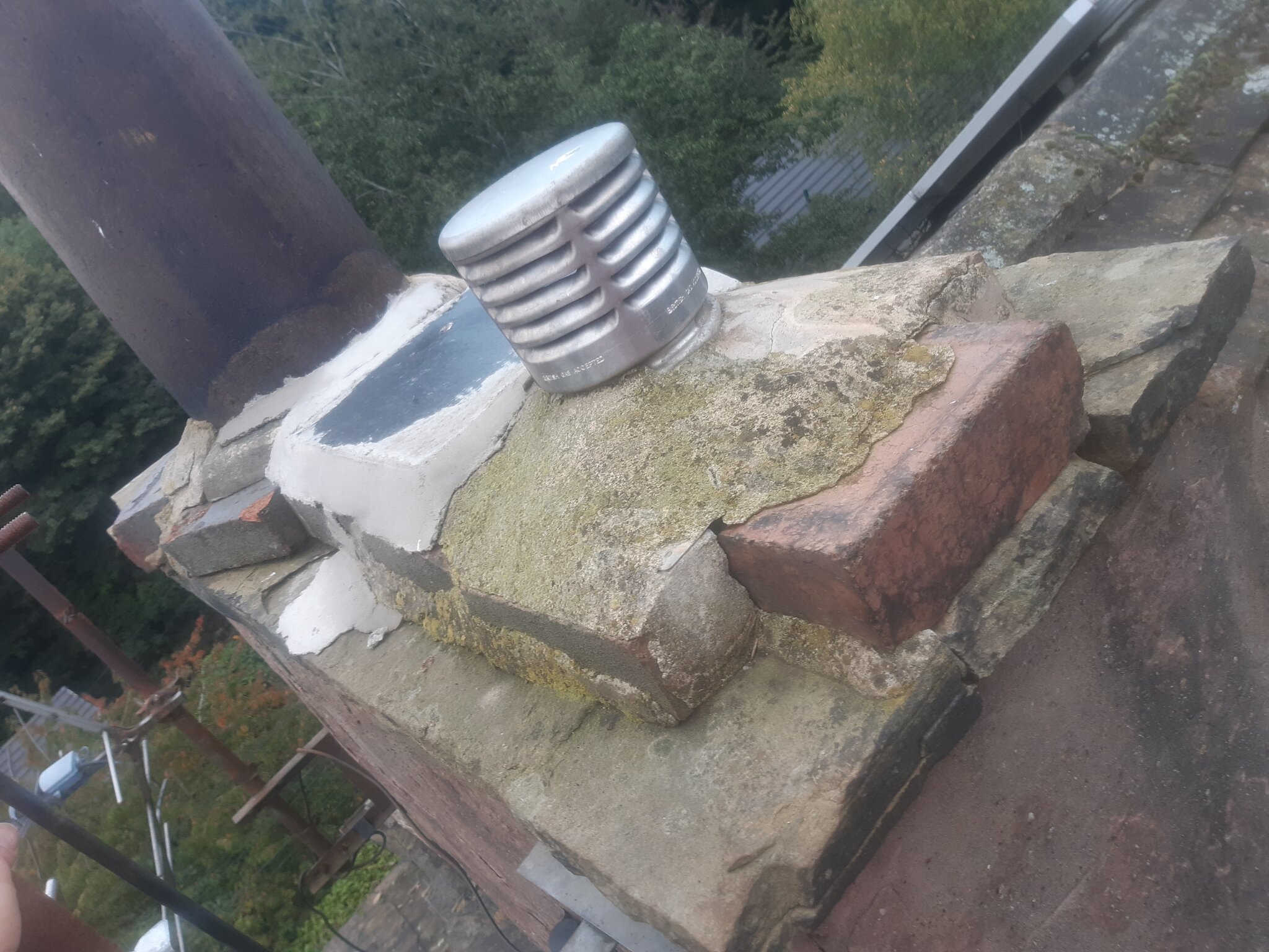

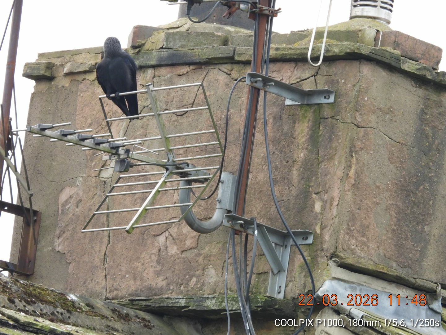

My chimney was letting in water to the house. This was how the chimney looked:
It's a shared chimney. My side of it (1st photo, above) is east facing and although it doesn't look great, the top of chimney is more concerning and more likely to be letting the water in.
I previously posted for advice on here as I was thinking about tackling it myself but, in the end, I decided to hire a roofer. He suggested it made sense to address the top of the chimney, and he provided me with a quote that included to "cap and re-do flaunching on the chimney".

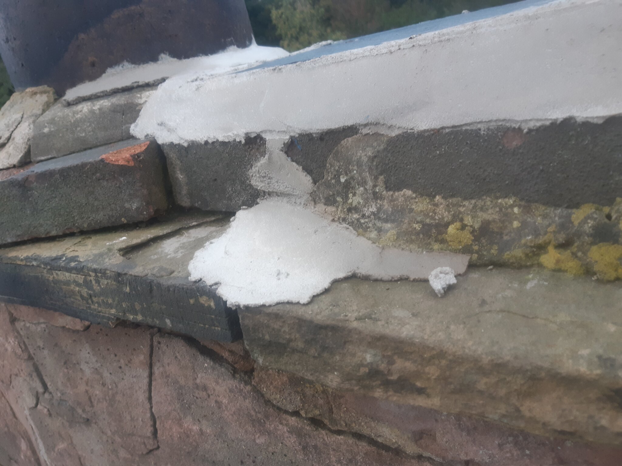

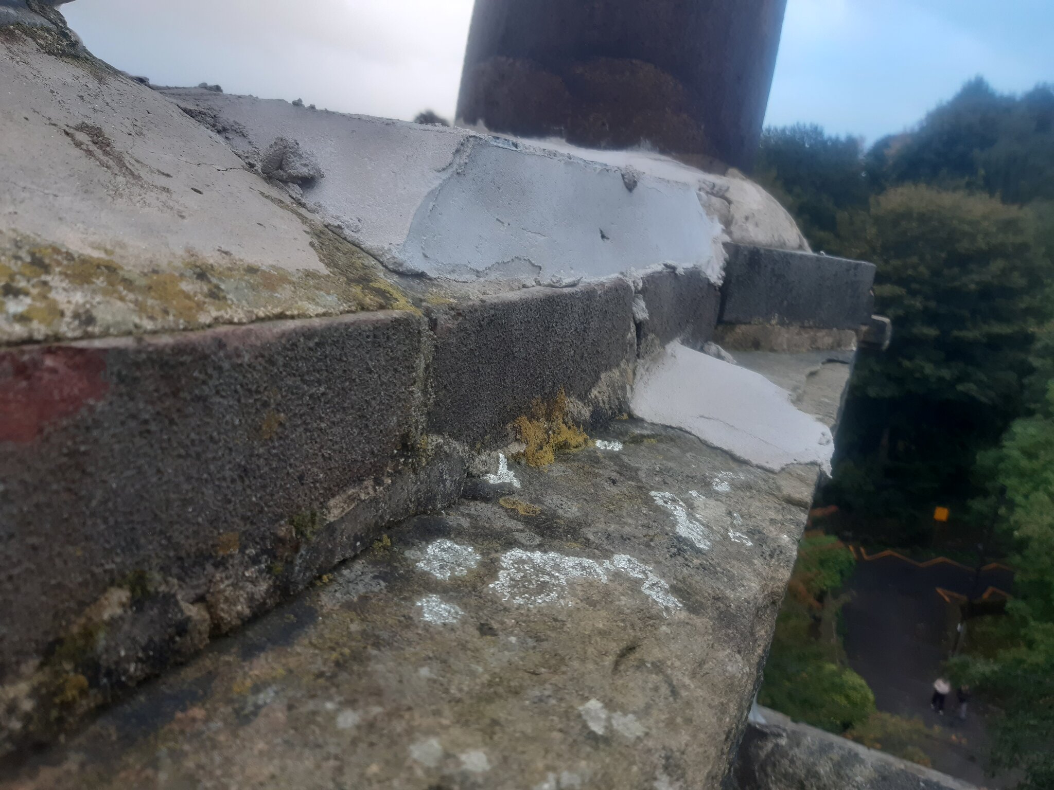

It sounded good and his quote wasn't cheap, but all I got was this (showing top, left and right side of chimney, respectively):
As you can see:
- he's only touched the middle part of the chimney,
- there are still loads of gaps up there where it seems like water could get in,

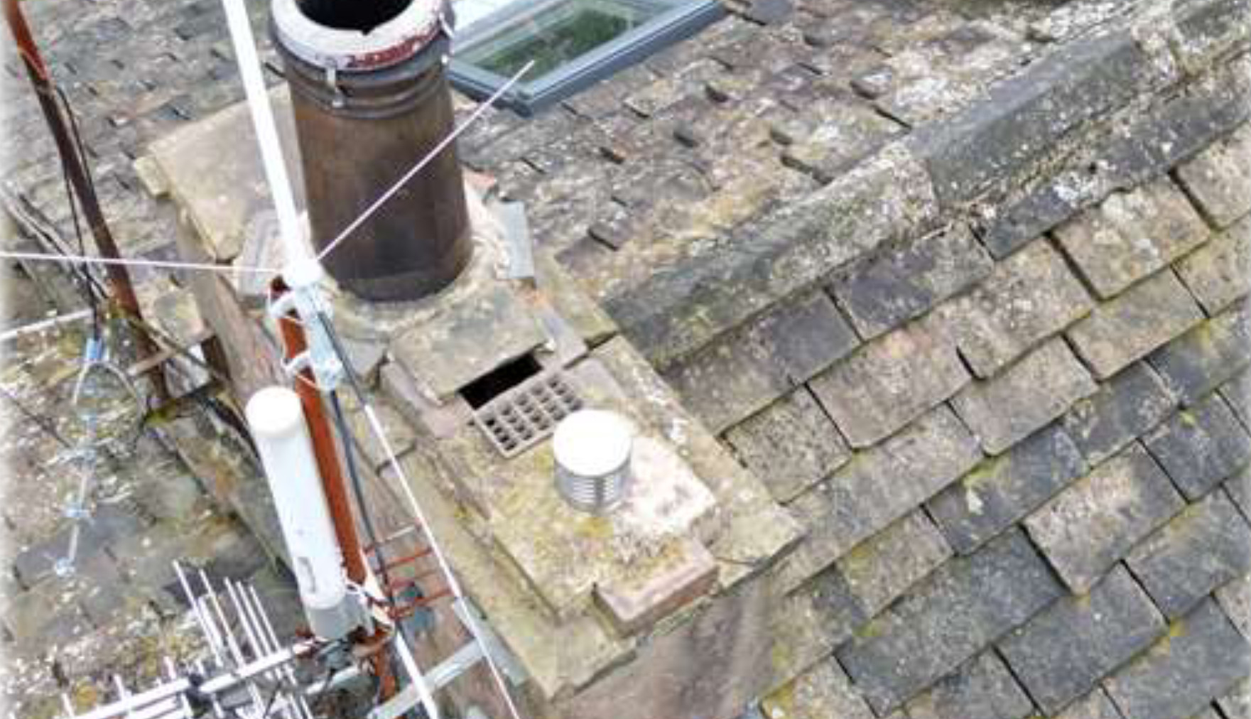

- he's blocked off the hole and the bit I presume was a vent (the bit that looks like a potato waffle).
So I would like to know:
What is reasonable of me to expect the whole chimney to be reflaunched? (Ie, if he was only intending to reflaunch part of it, then shouldn't he have said that explicitly?)
The vent and hole that he's blocked off, could this cause ventilation issues that could result in more problems?
Is the overall standard of his work as bad as I think it is?
Rather than blocking off the hole/vent, should he have instead fitted a cowl/pot or something with a cap on? (Presumably, that's what he meant by "cap"?)
I haven't paid him yet and the scaffolding is still up, so what should I be saying to him?
In anticipation, thank you!
Think I'd be disappointed with that but it's down to what was discussed and what your budget was.

Both your side & the neighbour's side need remedial repairs - fix all the stack at the same time or you might be wasting your time.
1. The whole top of the stack needs to come off - the flaunching, and the clay pot, & the metal gas terminal.
2. Then remove the render & S&C fillets, & the slate "flashing" down to roof tiles. If they are redundant then also remove all the TV aerials.
3. Check that the top courses of brickwork, they might need rebuilding?
4. There are four(?) flues in the stack, & they all need permanent ventilation. Are the chimney breasts on your side still intact?

I would say yes to all three, especially the vent he sealed off. Blocking a flue without ventilation is asking for condensation to build up inside, and that can look exactly like a leak coming back. A ventilated cowl keeps the weather out and still lets it breathe, so that is what I would be asking for. Agree with ree as well that the rest of the old flaunching will be the next weak point once it takes a proper downpour, so keep an eye on it through the next few heavy rains before you sign off.

Hiya Steven, thanks for confirming that. I'm going to tell him I expect the whole thing to be reflaunched, so the old flaunching should not longer be an issue.

The flaunchings should be sharp sand.
The chimney should not need to be rendered in the first place.

Also, re the ventilation, he's said, "I don’t leave ventilation holes as it’s just a way water can get in. I’ve done this on many chimneys and never had a problem." Should I be insisting on ventilation??

For flaunching : 3 or 4 of sand - one of cement - one of small chippings. Nothing else is needed. Mix to workable just below semi-dry. Wet or soupy mix will crack in a year or two.
Its good practice to Pre-prep the stack top with SBR or similar before flaunching.
All sorted now. The roofer has been back and re-rendered most of the (shared) chimney, and he's installed a pepperpot to go above the flue that he'd previously blanked off.
Thanks everyone for your help.
