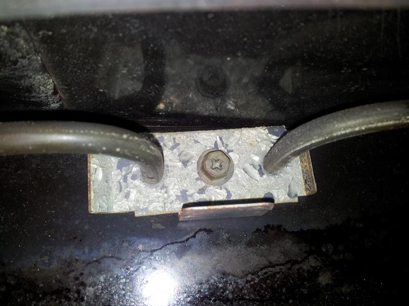

Hi, i am wanting to fit a new element on my creda oven but cannot undo the screws. i have taken pictures next screws . please can someone advise if i need a special screw driver for them. they just won't move when i use a Phillips! any advice would be very much appreciated.
looks like an 8mm bolt head, a socket set with a ratchet and 8mm socket should be enough torque to crank these off, be careful not to snap the bolt head though mate.
brilliant thanks mate! that did the job. element fitted and working :-) i can't believe that's what i needed lol
