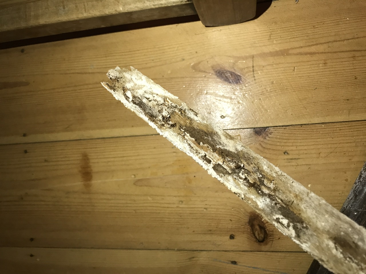

Today, i had to take some of the boards up to run some leads, but noticed the sub floor is a bit damp and bits of wood left around under the floor have that white rot on them with a general damp smell lingering.

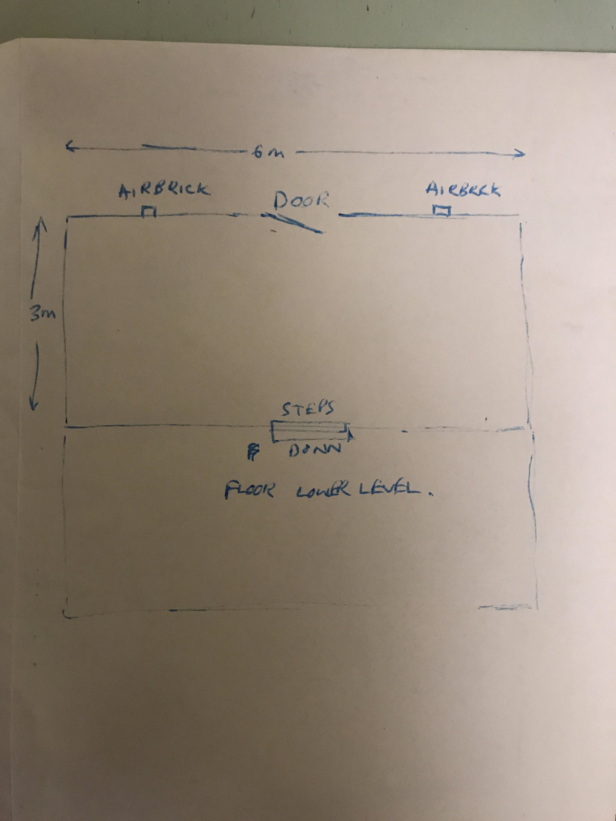

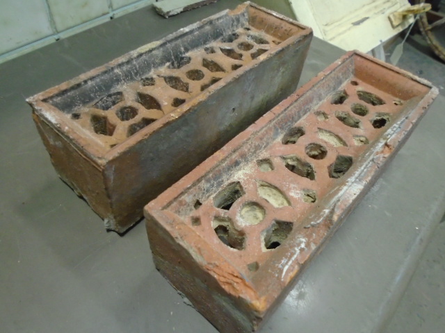

At the front of the house are two very small air bricks similar to the attached pic which seem a little inadequate for the floor - about 18m2. One the air bricks is a bit blocked as it has a large plant box in front of it so i'll be moving that. At the back of the living room, the floor drops about 40cm to another room, so there is no way of fitting air bricks on the opposite wall - the floor just finishes in the middle of the house.
I'v attached a diagram of the house layout to show what i mean.
What would the best way to get some suitable airflow under the floor to get it dryer? Or are those two little air bricks going to be sufficient as long as they are clear?

Its possible & simple to insert ventilation such as 9" x 6" plastic air bricks in the 400mm step-down.
You need more air bricks at the front elevation and what about any side elevations?
When looking under the floor look for an intermediate knee wall.

Why not post pics of the front elevation, the step-down, & the underfloor white rotted bits.

Its going to be tricky to put vent bricks in the internal wall where it steps down as the wall is about 700mm thick and stone - it was once the exterior wall at some point. the kitchen floor at the rear of the house is part concrete and part suspended floor - its quite a frankenstein of a house!

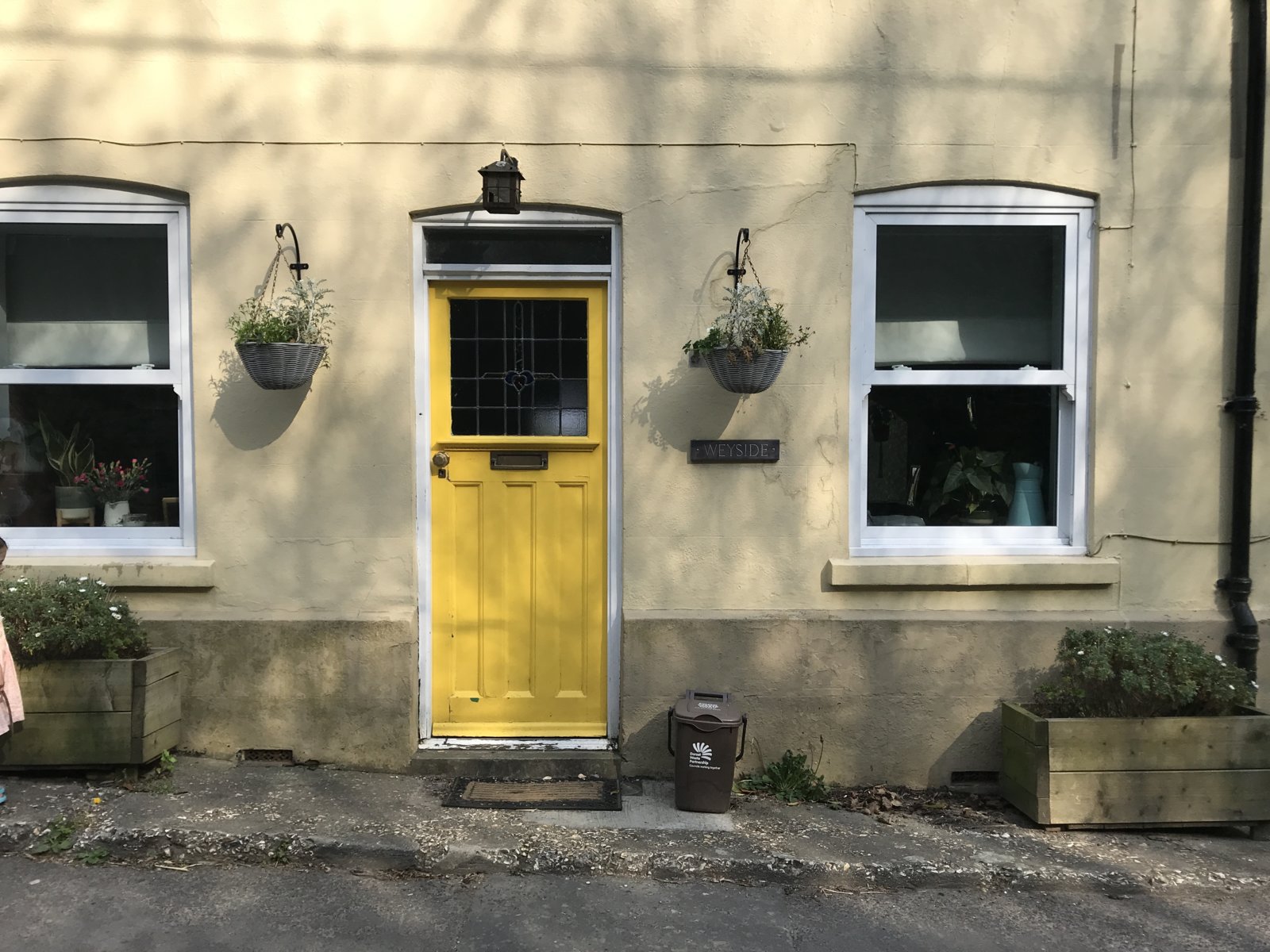

Here’s the front elevation . You can see the two air bricks - i know the one on the left particularly is ground level which isnt great, but we dont get water pooling in this area that i have seen - i think it runs towards the road.

You are on a slope with ground water pressure coming downhill from left to right - with only two air bricks - you could insert two 9" x 6" plastic air bricks on the right hand side and replace the left hand 9" x 3" with a similar size plastic air brick. Plastic a/b's give more ventilation area.
What, if anything else, you should do depends on how much access you can get to the void to examine the condition of the joists.
Given that any existing front elevation DPC has been well bridged on the left front then If your joist tails land on that front elevation then you might have wood rot troubles there?
The thing is, that the flooring might be good enough for a number of years yet or it might be on the edge of degrading. Examine all the interior walls, esp the front elev. at skirting level, & test the floors for any movement.

At a min. the front render should be cut off 50mm above ground contact.

There's no room on the left - go any higher and your above the FFL.
Originally, there would have been further venting under the door threshold, & the frontage ground level would have been much lower.

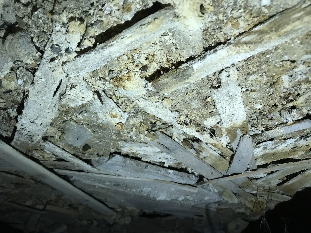

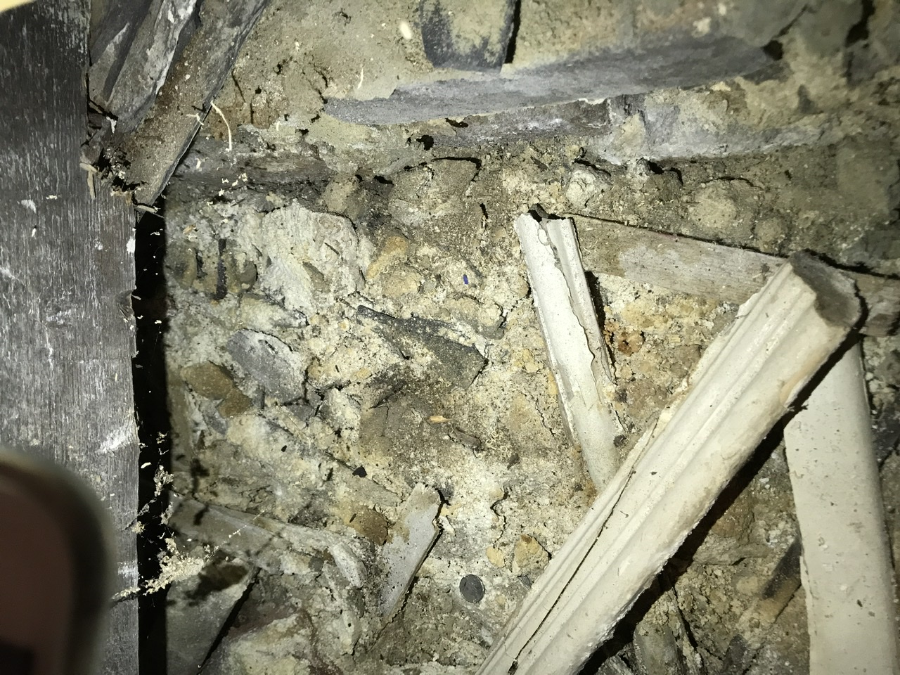

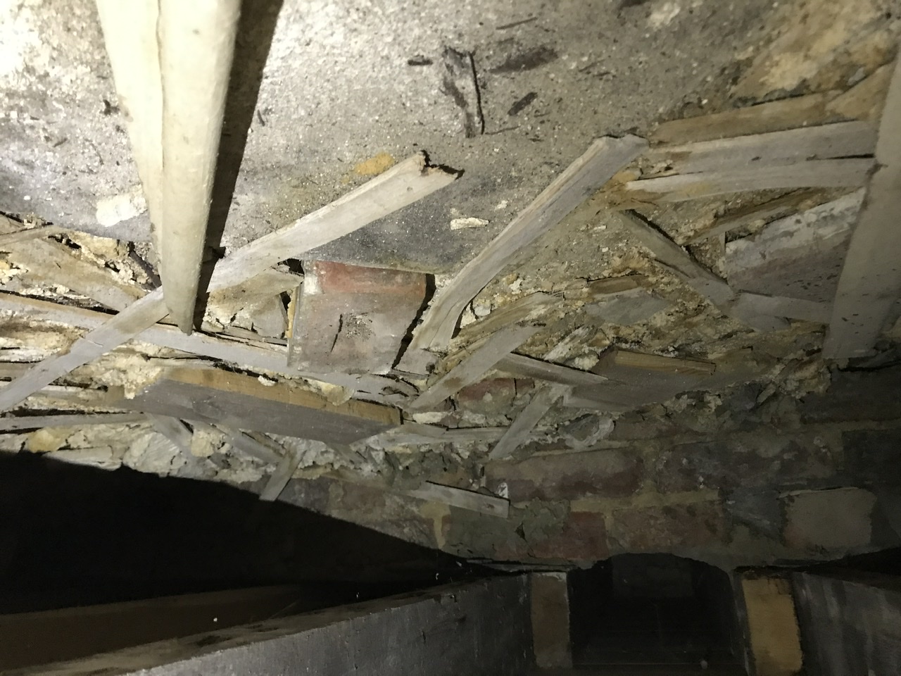

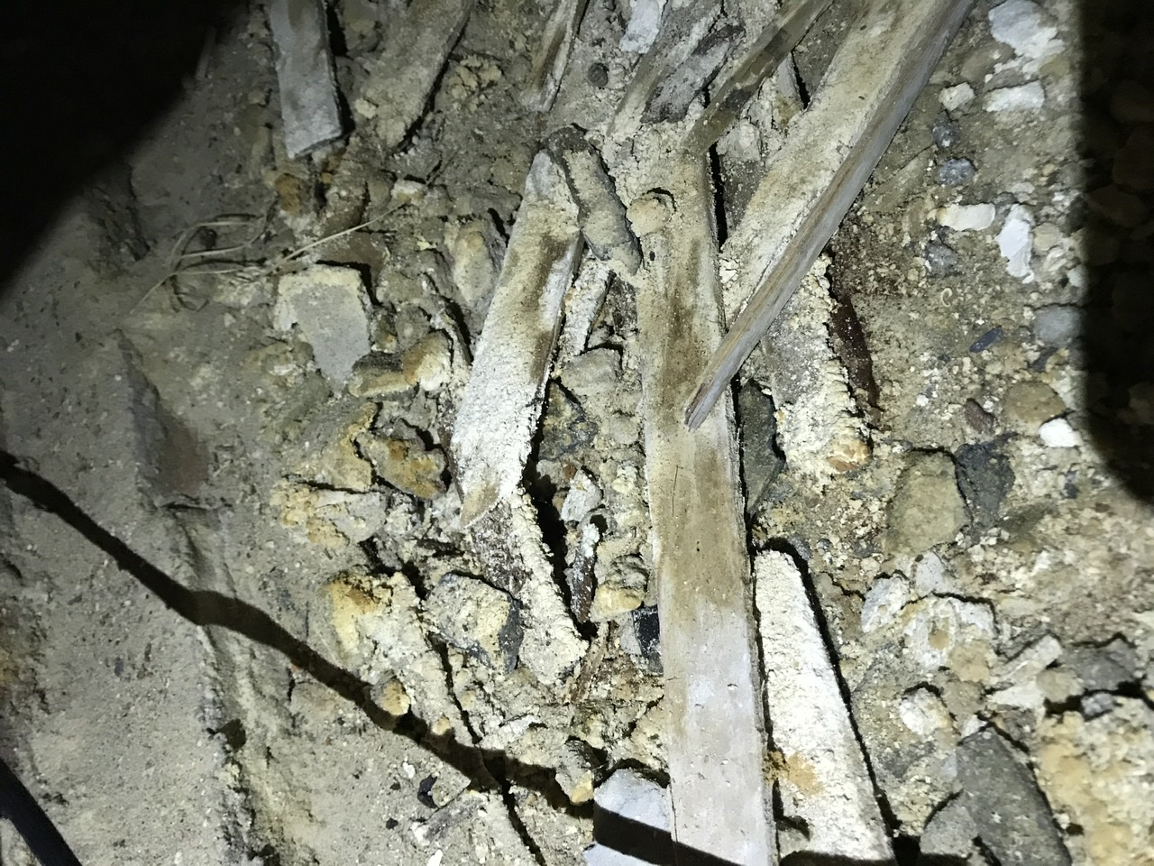

Still waiting to see pics of the decayed wood debris?

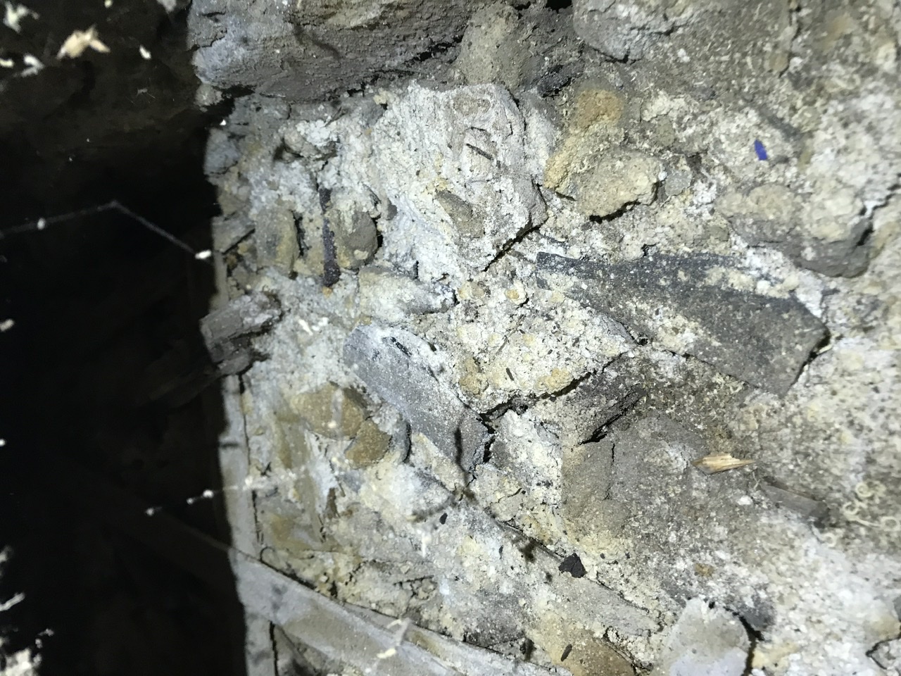

Here we go for pics - finally got done tonight
i really need to take a couple of boards up near the wall to see what the ends of the joists are like

The pics show a crawl space thats par for the course for such a badly ventilated space - nothing sinister suggesting say dry rot for instance.
The wood debris suggests previous work, and in time it would be best practice to remove all wood debris.
Given the sloping site the sub area soil is remarkably dry.
There seems to be enough space under there for crawling around.
