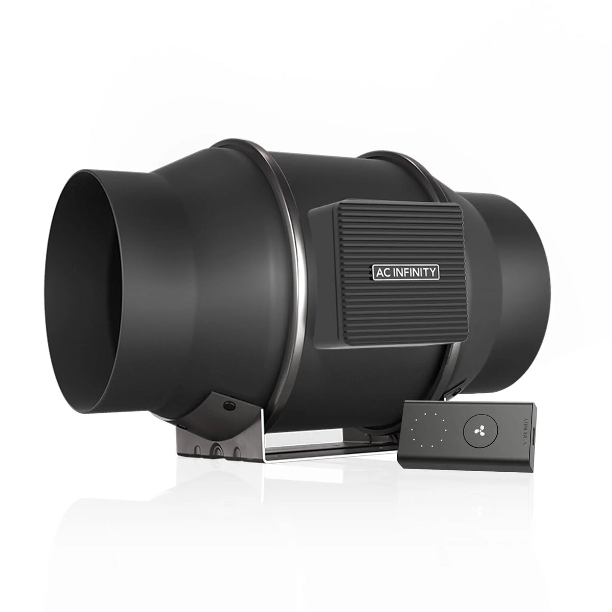

Morning,
I have a freestanding air con unit that I've vented out through the loft. This has of course needed a long vent hose. I'm worried that the heat isn't efficiently being pumped through it and ending up blowing back into the unit.
Is there some sort of pump I could use midway to help the heat move along?

Do you mean a fan mid way along? Potentially an extractor fan may work, however you need to check manufacturer instructions for the ac unit that it is permitted to operate with a vent that is longer than a certain length in the first place..

Yeh, something mid way just to help extract the warm air. I guess some sort of extractor fan could work. Just trying to picture how to set that up.
You know what, I'd already found that and ordered one :D
I'm going to try it this side of the ceiling first, but I've got power in the loft if I need to do it that way
Well, it's been in full swing for a couple of hours and is doing the job - no warm air coming back through the AC. The fan has a long enough power cable for it to sit in the loft and be plugged in outside.

The vent hose goes to a outlet in the soffit

Ah I see -that is a bit of a twisty run, is it flex all the way - just like a kitchen extractor its not the best when using a flex.

Yes, flex hose but pulled as straight as possible to make the route as short as possible.
