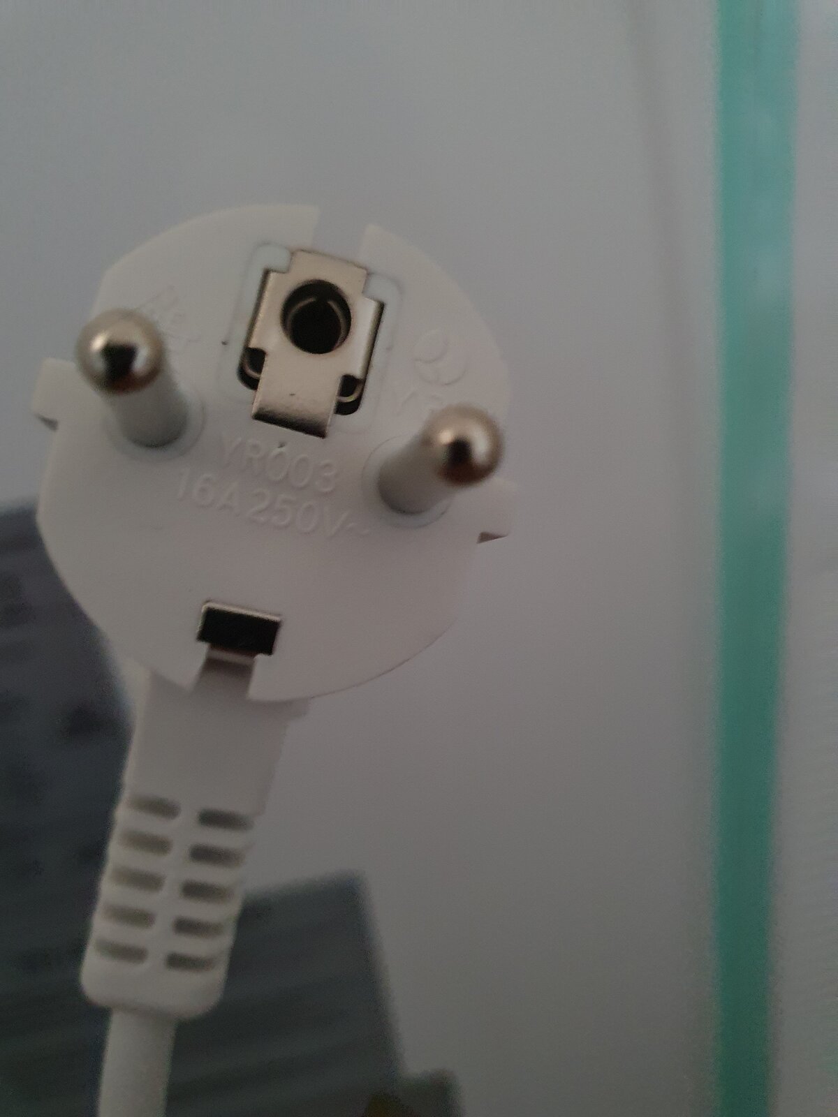

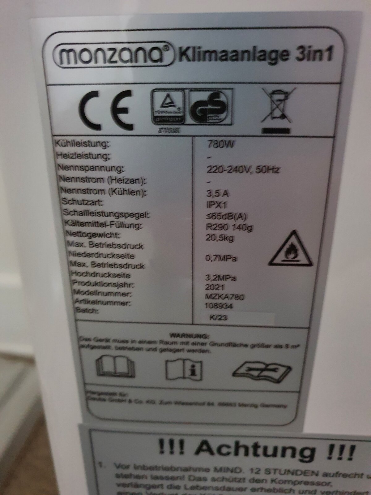

Just got an air con unit from Germany am I okay change to a three pin plug or use a adapter

Do not use an adapter.
Change the plug to a UK one.
(Saying this because ac units are relatively high current and adaptor are always poor quality and good chance of poor contacts between pins and so high resistance and so possible overheating and fire. Also issues with earth not always being connected.
