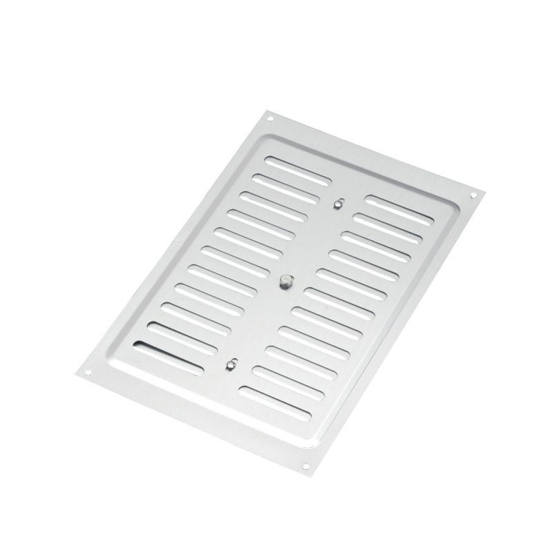

Hi, this is my first post/time on this web site the problem which i have is:
I used to have a gas fire which i have now replaced with an electric one and we have an Air vent in the room which was just for the fire and lets in so much dwarft/cold air i want to block it up/fill it in so my room stays nice and warm please if any one can help, thanks matt
Its there for a reason, ventilation to Chimney, block it up and you could/will end up with Damp Problems on the Chimney Breast,
Try a smaller Vent panel that opens and shuts.
It would also help if your chimney pot has a cap.

hi sorry did not say was a flueless gas fire and the vent is on the other side of the room in the corner, i have no chimney breast etc.....
Remove the ventilation in a room and you will still get damp.
Reduce ventilation and condensation increases, your choice, if the rest of the home is ventilated you maybe ok blocking it, but most here recommend leaving it.
Are you relying on the fire for heating the room, or do you have some form of background heating for the property, Do your other rooms have vent panels as well. ?
If you have background heating you could possibly get away with blocking the vent up, Your choice
