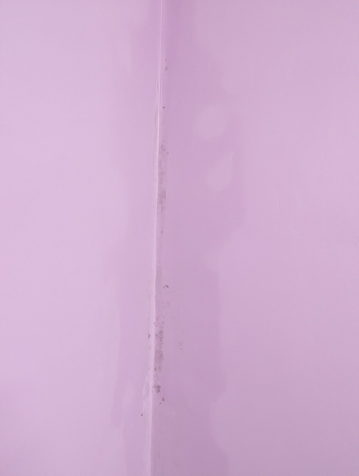

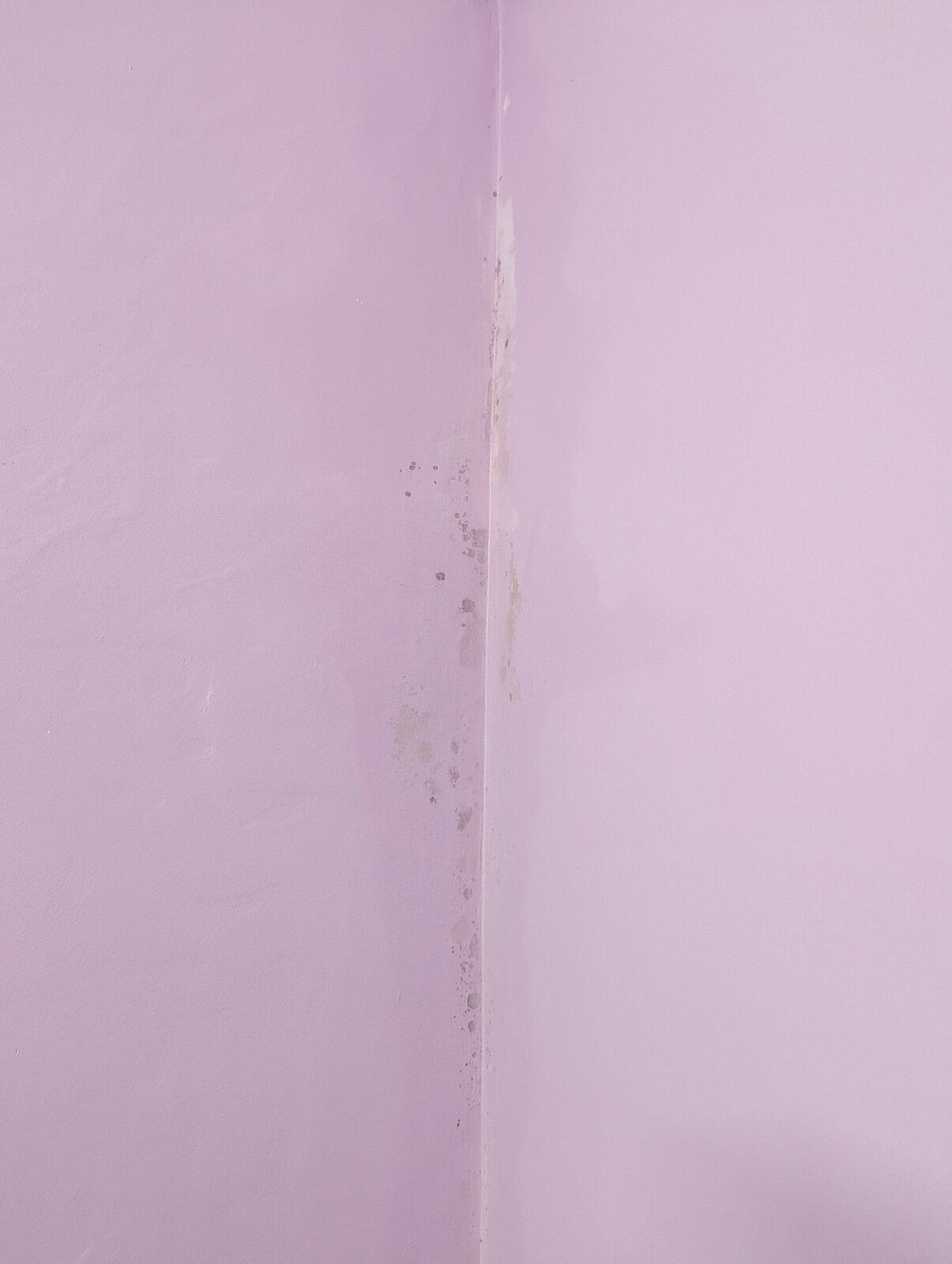

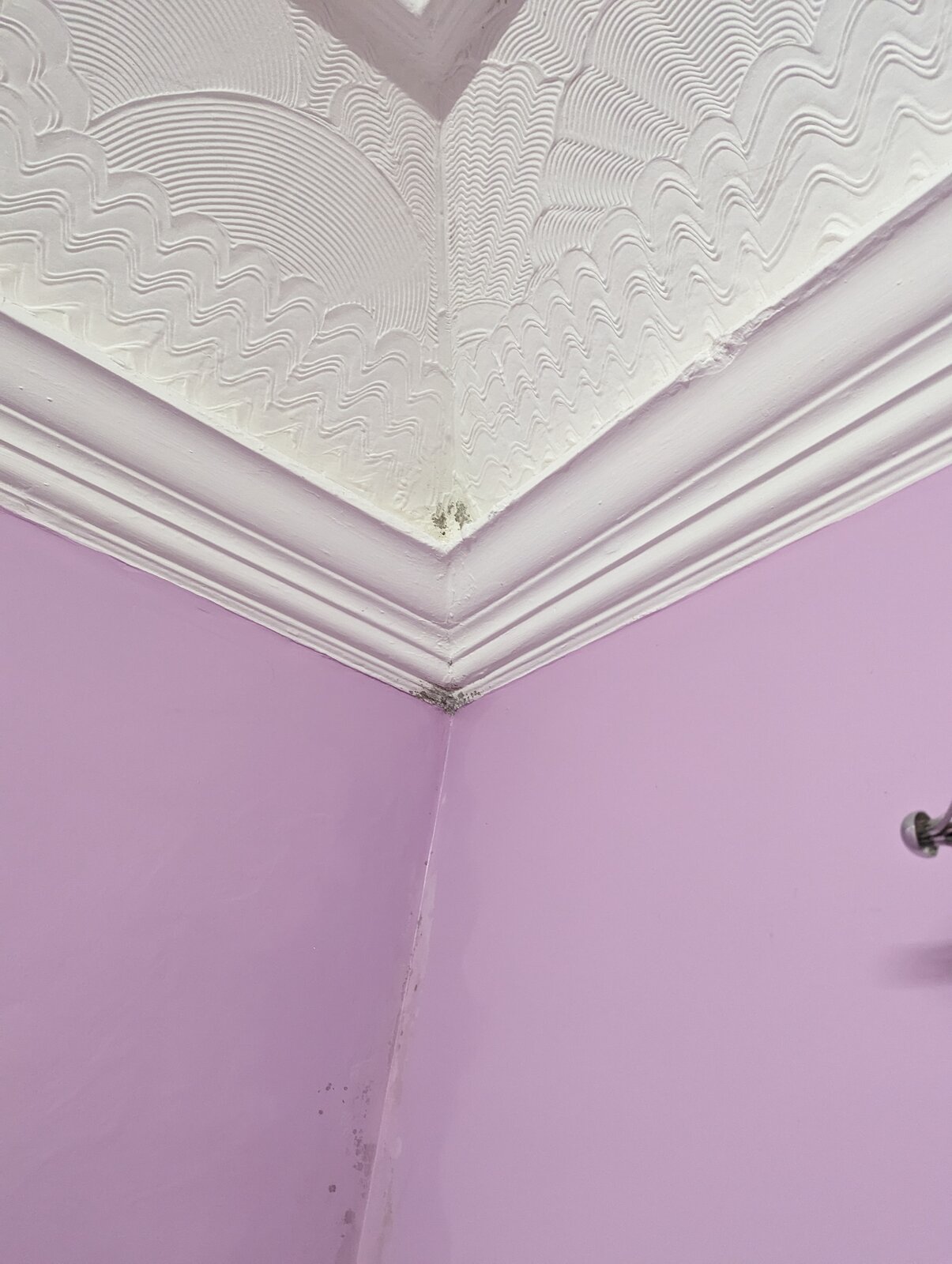

Moved in 2 years ago, and had condensation issues in winter, in the rooms with external walls (rooms which have the the four corners of the house). Would an air vent fix this issue, also I was thinking of a hit and miss vent in each of the rooms, but fitting an air brick would be difficult to do as it is quite high up and isn't just viable at the moment. I was just thinking of doing multiple 8mm or so holes and covering it with a hit and miss vent, would that work?

Where is the moisture coming from? Do you drape wet laundry over radiators?
What sort of windows have you got?
Is it upstairs or down?
Please photograph the outside of the house corners, all the way up to the roof, gutters and downpipes.
We do put wet clothes on radiators no gutter issues outside the house also gutters are a fair bit away from wall so any spillage falls on floor and it's 2nd floor
I would suggest try drying clothes outdoors or in a condensing dryer, before you start drilling holes in your house...
Yes, you are delivering the water from your wet washing into your home.
How effective is the bathroom extractor fan?
Bathroom extractor is pretty good, in terms of drying washing yes I understand that it can cause excess moisture, we try not to alot of the time, but just the way things are it's difficult not to, especially in winter. But in terms of drilling holes without having a physical air brick fitted is that something that can be done? Also windows are double glazed but don't have trickle vents.
