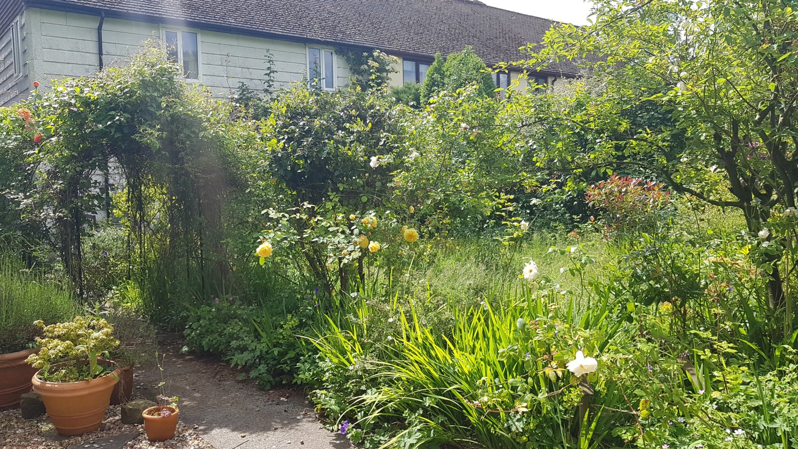

Hi..we have imherited a lovely airey house im the country, it is solid and been lived in up until recently fine with no probs..do we really need to get this certificate as we dont need to get a morrgage on it? Ww reslly want to do the loft as its a massive space up there..anyone achieved this?

You would certainly need specialist design, and as part of that, and the building regulations approval, you would need an assessment of the existing structure.
A condition certificate would not necessarily help with a lot conversion, as it would not have the detail required for building regulations or design of the loft.

So is this an original un-repaired Airey house?
If it is I'd be very surprised, all the Aireys I saw were demolished or "repaired" in the 80's because they were one of the worst PRC houses to have structural defects. Steel tubes set in the concrete columns which rusted causing the concrete columns to disintegrate.
Has it still got those distinctive concrete panels on the outside? or has it been "repaired" and got brick and block cavity walls?
If it really is an original Airey I'd say demolition and re-building is probably the best bet. I certainly would not waste any money on a loft conversion or extension unless it has had the full "repair".
Yes.. its original still with panels..my husband bought it early 80s for his grandma so i think it got missed being done as was privately owned...thanks for all your input so we defo need toget the structural work done as we need the loft for space and can then hopefully put some kind of extension onto the dining room/kitchen. Now the job of finding someone to do it...
