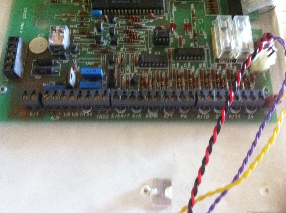

Hi all
My garage alarm panel has been smashed off my folt!!!!!!!! Anyway I had an old scantronic panel that I know is in full working order 9200 so of with the broken one and screwed the 9200 on when I came to try and wire the panel the wiring from the ext bell and 2 door and 2 pir they all have only 3 wires black/ red/ white I have not got a clue please help thanks in advance

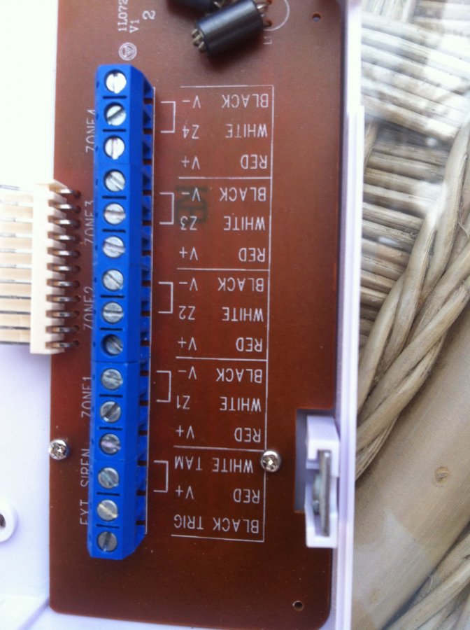

Just taken this pick of what's left

Looks like your old panel was a cheapy DIY 3-wire jobby, possibly Micromark? I doubt any of your PIR sensors/bell box is compatible with the 9200. You may also have to recable in 6 core alarm cable if the cable you have is definitely only 3 cores.
