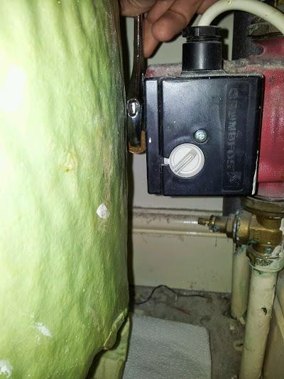

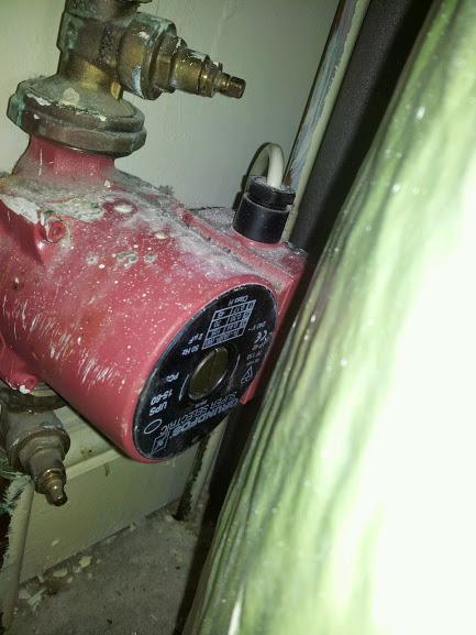

the pump body is definitely hotter than the the connected pipes, but I wouldn't call it extremely hot. It does gurgle when on, I've assumed air is in the system. Its a grundfos, but the bleed screw is not very accessible due to the pumps vicinity to the HWC.

if the pump is hotter than the pipes, it is not circulating water properly. It might be seized, or worn out, or clogged with sediment. Do your best to open the bleed screw and see if water drips out, and if you can turn the motor spindle with a screwdriver in the slot.

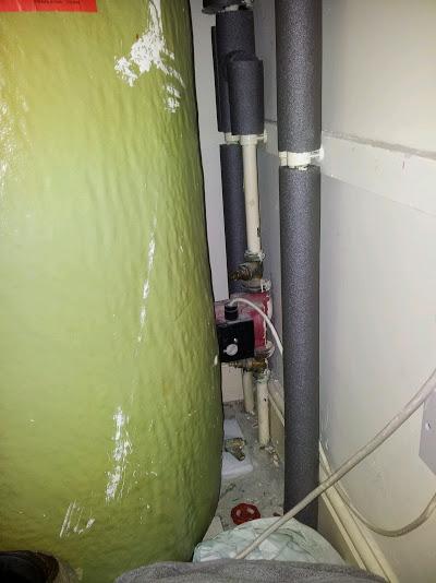

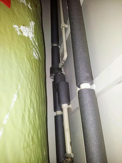

Post a pic of the pipe layout around the cylinder and pump. It is possible to remove a pump but the pump valves might be seized.

pictures of the pump.
Bottom half of the pipework in the cupboard;
Top half;
And this demonstrates the clearance i have for the front of the pump - I've got an adjustable spanner with a 1p in it - It will go in the screw but I'm obstructed when turning it by the cylinder or pipework!

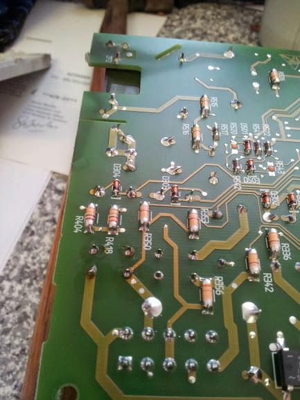

Just an update for this;
A common problem with these is dry joints on the PCB. On removal, it was apparent there were 4 dry joints for 2 relays.
A quick resolder and all sorted - I now have heat - and have done consistently for about 36 hours now.
Here's a picture of the PCB, the dry joints are near resistor 418.
Thanks to all for your inputs - the pump does need to be investigated as it is noisy but at least for now the house is warm.
