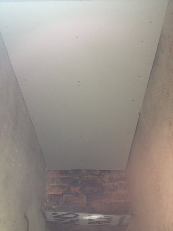

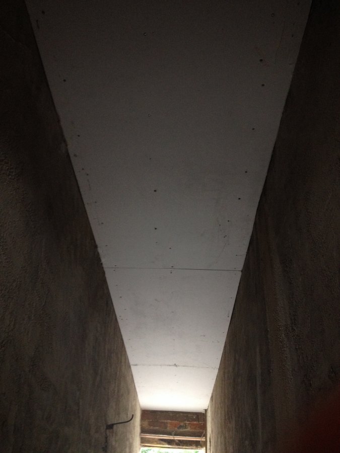

Hello,
Our house's ground floor includes an alleyway for the Right of Access for the rest of the terrace. The survey said that the ceiling/soffit would previously have been lath and plaster but the previous owner has replaced this with standard plasterboard. The survey suggested the moisture resistant plasterboard instead.
It doesn't seem very damp proof to me. What else should I use? Shower splash panels? Will moisture resistant plasterboard suffice?
Yes, that is indeed the chimney supported by a wooden beam and a metal sign... It's on the todo list...
Thanks in advance.
That ceiling shouldn't get much rainwater on it but standard plasterboard will probably get a bit soft and rubbish after a few years outside. Price/performance thing really, the moisture resistant plasterboard will probably be fine for 10 years or so, the shower stuff will last for ever but is a bit dearer than plasterboard. Either will work, from the look of that ceiling in the pic I'd move it further down the list and concentrate on more immediate things
