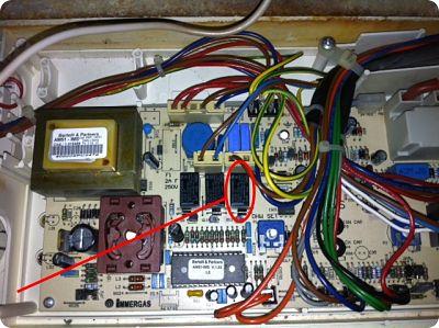

Hi, if you look at the fault finding section of the manual for the CB24 and CB28 two flashing LED's at the same time will take you down the path of a faulty air pressure switch. In short, these do not regularly fail. What Alpha fail to explain is that the PCB is the likely cause and these are approx £180 to buy.
The good news is that you can repair them and it is nearly always the same component that fails - the Relay. The news gets better in that you can buy one for about £7.50 on ebay. Search for Takamisawa relay and you'll find them there. The job of replacement couldnt be simpler. Disconnect from the mains, disconnect the cables, remove PCB, heat the 4 pins on the back of the faulty relay (see pic - its the 3rd relay on the right) be careful not to overheat the conections when removing and use a solder soaker braid or solder sucker to extract the old solder, these cost aroud a £1.00 on ebay and then put the new one in (facing same way as the others) Reasemble in reverse order and you'll have a big smile on your face for days. Alpha CB24 CB28 PCB repair for less than a tenner. Winner.
