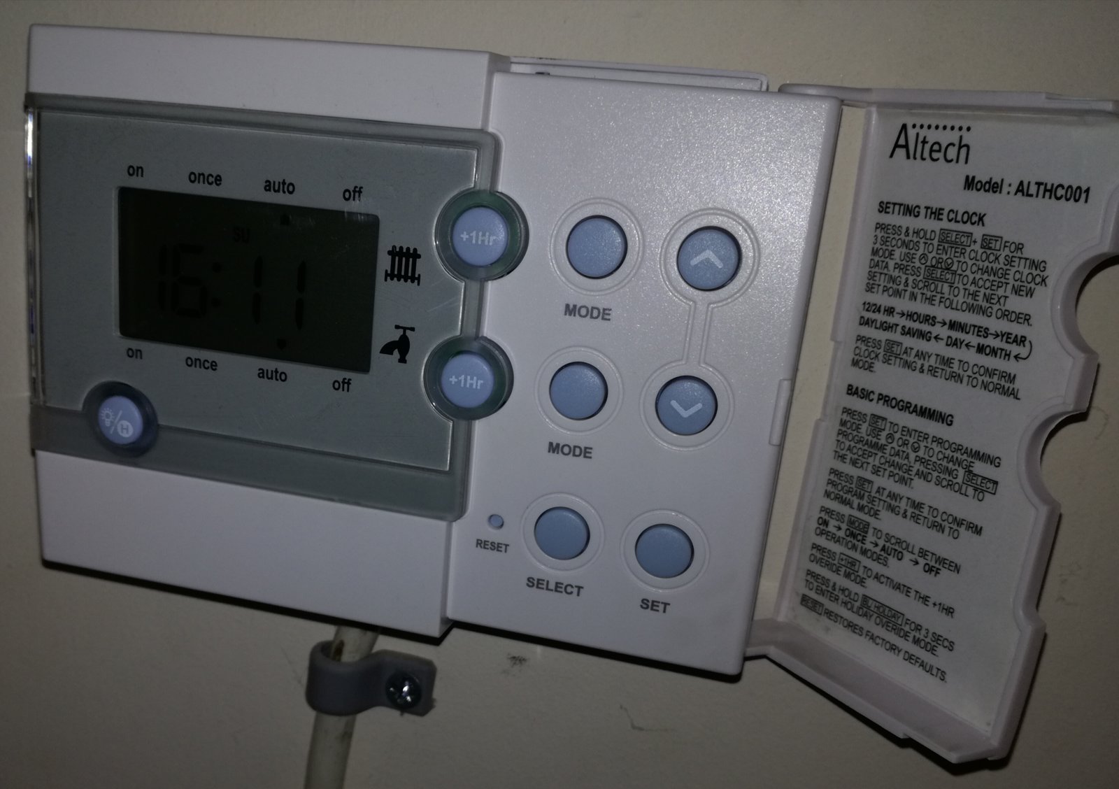

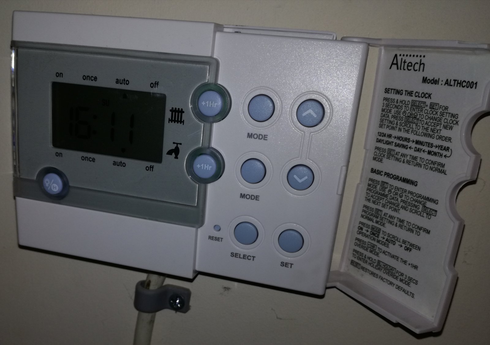

My mum has a Worcester Bosch gravity fed boiler with an Altech ALTHC001 control panel. For some reason the 1 hour override buttons for heating and water don't fire up the boiler. They light up when pressed, but nothing happens. The manual doesn't really shed any light on this. Can anyone help?

when you press the +1Hr on the radiator symbol does both the radiator and HW symbols come on ?
Ah! Ok, I'm happy to take your word for it. After all, I don't have much plumbing experience. That said, shouldn't the 1hr override button work regardless? When I press it I get 'c01 h01', on the screen, which I believe means central heating for one hour and hot water for one hour, but nothing happens after that. I thought the +1hr button was a one push deal, which it has been in the past, according to me mam.
yes but you have a fully pumped system, where the programmer will control either a 3 port valve (Yplan) or 2 x 2 port valves ( S Plan) and these in turn send a signal to the boiler to fire up, the programmer doesnt tell the boiler to come on directly
So does that mean there is potentially an issue with the valve? I did read on a Worcester Bosch website that there is no 1hr boost function, despite the fact that the controller has two boost buttons.
