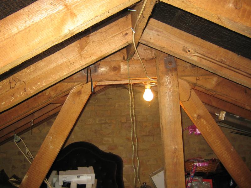

Now as a complete novice in this field please forgive me if I use some wrong terms for roof parts. I have a problem in my loft space which annoys me and that is the lay out of my roof supports get in the way when walking around the loft. There is a central 4x2 from the joist to the ridge and either side of that there are ties that connect the joist to the rafters which are slanted. I have to duck under these all the time, so I was wondering if it would be possible to resite them further back along the joist in the virtical. Would this be detrimental to the stability of the roof construction. If this is not possible is there any other way I can get rid of this problem.

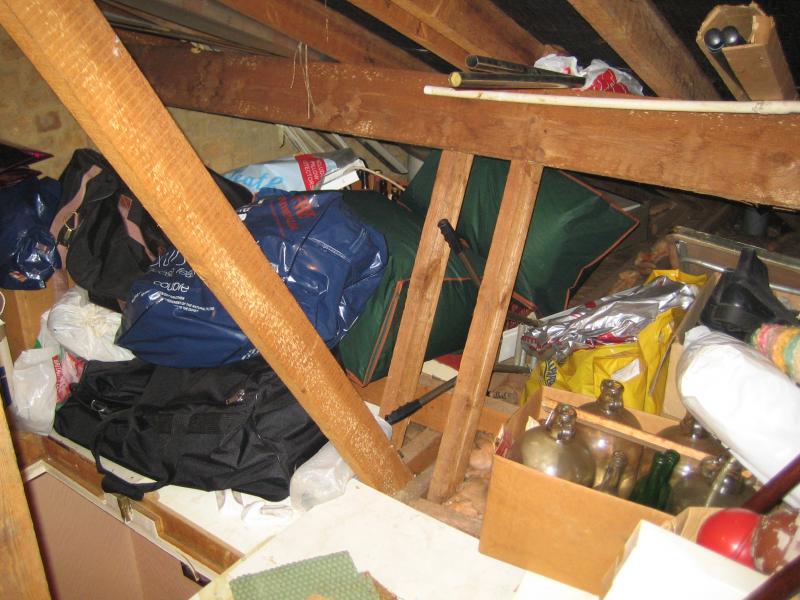

Hello where have you gone. As you can see from the pictures these 4x2 slanted pieces (are they called pulings) are the ones causing the problem, can they be altered in any way
All the timber elements i see in the image have structural relevance and should not be removed unless you can prove otherwise, i.e. ask a structural engineer.
They are not purlins, but collar support bracings. The purlins are the ones that run at 90 degrees to the rafters, all along the roof.

Thanks, just one more question on the roof structure. running through the center of the loft from the fire wall to the other end wall is a single 4x2 set into the wall at each end. It lays over the top of the Joists but apart from the inlet to the wall there is no fixing to any of the Joists. what is it for. I presume as it is in the wall it is some structual thing but as it is not connecto anything it cannot hold up or supprt anything :confused:
Ceiling binder (also needs to stay in place )
That's a TDA truss, or derivative thereof. Every bit that you want to get out of the way works in conjunction with the other bits to stay there and hold the roof up.
It can be altered. It needs and SE's input. It's expensive, both to design and to do.
In short: leave well alone.
