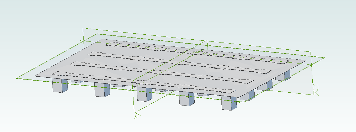

If someone can point me at any information that suggests this method is satisfactory, then I'll believe it. In the absence of that, for any sort of foundation I would either follow the proven designs that are extensively documented, or use a product such as easypads that have been tested, and are obviously sold by the company with a liability for the performance of the product when installed according to the manufacturers instructions.
Anything else is a gamble - it might work, it might not. I thought long and hard about the sub-base for my latest garden room build, and concluded that using proprietary products with a substantial timber frame wasn't going to be a compromise. The timbers (200 x 100 main beams) and easypads for a 6.5 x 3.5 building with a deck extension cost the best part of £2K. Could I have got away with something cheaper? probably. But if you're going to put a £10K build on top of it, it seems a bit daft compromising for a few hundred quid. In my case a strip or raft foundation wasn't really an option because I didn't want the disruption and disposal requirements of using a digger.
