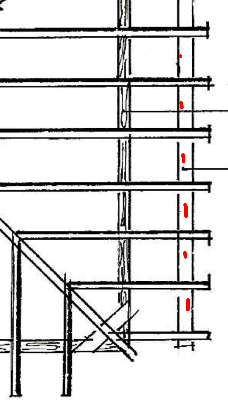

I'm having a flat roof replaced with a pitched roof and wondered if there was an alternative to strapping the wall plate down to save me cutting the plaster in the room below?
It's the one with the red dashes on the pic and it's 2.7mtrs wide. There is a timber topped RSJ close behind it which takes the main load of the roof.
I'm hoping I can fix it to the new rafters instead.
Thanks.
The strap is also for stability of the wall as well as holding the roof down, but I'm guessing it's been ok so far!
